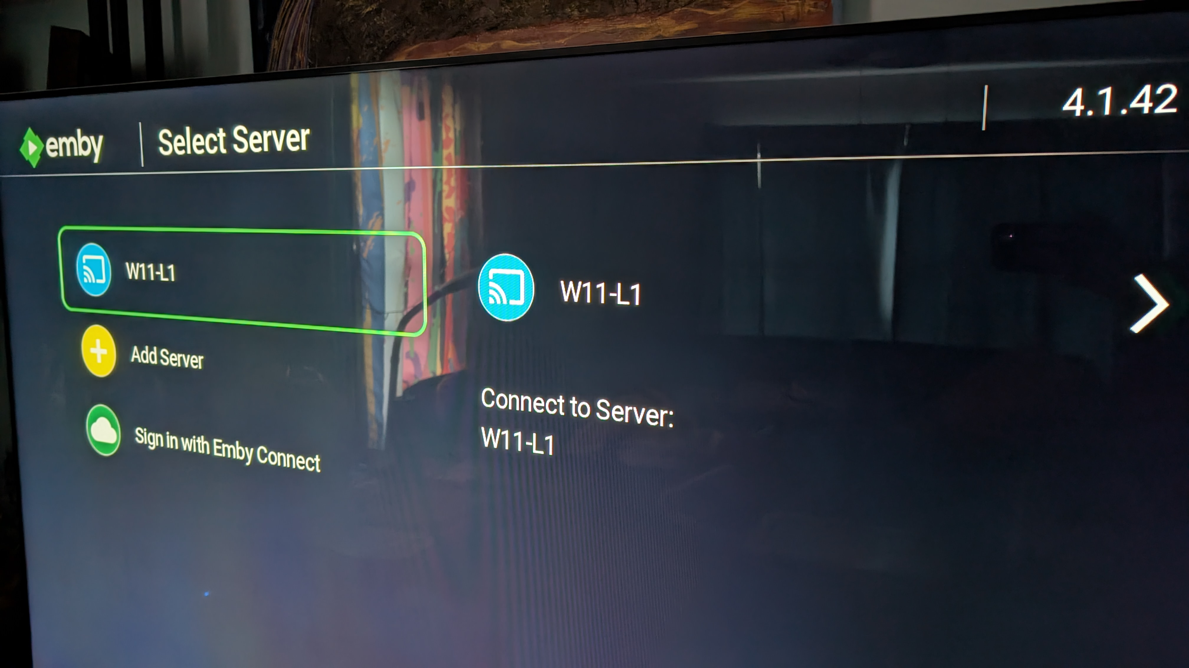

zebo51 22 Posted June 13, 2025 Author Posted June 13, 2025 When I launch Emby without being signed in, it will list any emby servers it sees on the network. Same screen you can sign in or add a server. The instance running on my laptop always show up, even if I delete it and then close out of the emby app and launch it again it shows back up. Am I wrong in thinking that emby announces itself on the local network and the app sees it and list it as a server?
zebo51 22 Posted June 13, 2025 Author Posted June 13, 2025 This screen. W11-L1 is the emby server that always shows up even when I delete it, relaunch the app it is there and signed out.
Luke 42176 Posted June 13, 2025 Posted June 13, 2025 1 hour ago, zebo51 said: This screen. W11-L1 is the emby server that always shows up even when I delete it, relaunch the app it is there and signed out. If that server is actively running on your local network then that is normal. That just means the app is redetecting it again after you've deleted it.
zebo51 22 Posted June 13, 2025 Author Posted June 13, 2025 (edited) Both are actively running Edit: Ah ok, I shut one down and now the one on my NUC is showing up. So maybe it cause they have the same ID or something like that? Edited June 13, 2025 by zebo51
Solution Luke 42176 Posted June 13, 2025 Solution Posted June 13, 2025 7 minutes ago, zebo51 said: Both are actively running Edit: Ah ok, I shut one down and now the one on my NUC is showing up. So maybe it cause they have the same ID or something like that? Sounds like it yes, which could happen if you cloned them.
