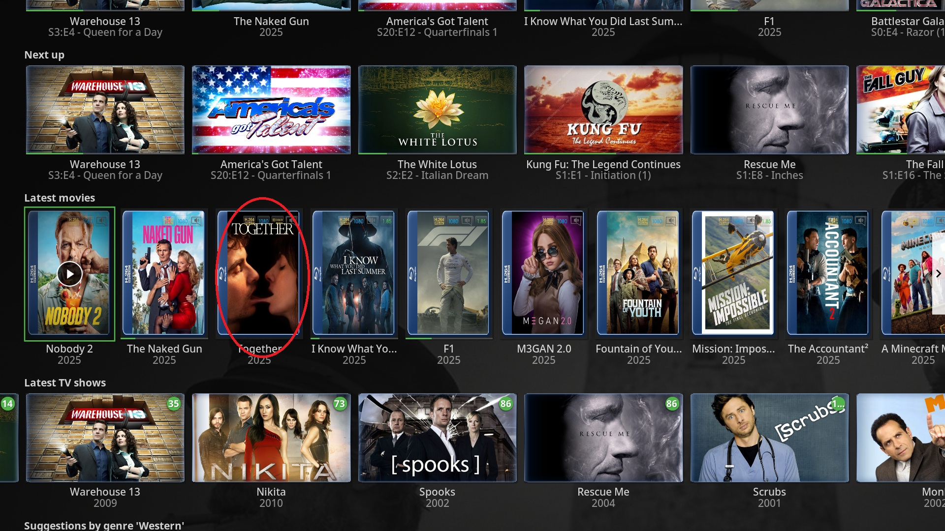

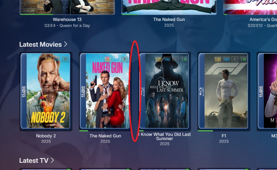

DarWun 357 Posted September 6, 2025 Posted September 6, 2025 I'm not sure how to provide information that will help troubleshoot this issue. But I'll try. I am seeing previously watched movies showing up as unwatched on E4K. Emby does not show them on my main server. But they show up in E4K on my Rpi4. If I do a library reset and add the libraries again, they will disappear. But eventually watched movies will start showing up again as unwatched. Screenshot from E4K: Screenshot from Emby Server" Together has been watched. E4K still shows it as unwatched even though Emby does not.
quickmic 1709 Posted September 7, 2025 Author Posted September 7, 2025 8 hours ago, DarWun said: I'm not sure how to provide information that will help troubleshoot this issue. But I'll try. I am seeing previously watched movies showing up as unwatched on E4K. Emby does not show them on my main server. But they show up in E4K on my Rpi4. If I do a library reset and add the libraries again, they will disappear. But eventually watched movies will start showing up again as unwatched. Screenshot from E4K: Screenshot from Emby Server" Together has been watched. E4K still shows it as unwatched even though Emby does not. Please verify such issues with the plugin nodes (via addon browser) and not something shown on skins. Otherwise I cannot know if it's a skin issue or a plugin issue. Can you confirm it's also wrong there?

DarWun 357 Posted September 7, 2025 Posted September 7, 2025 9 hours ago, quickmic said: Please verify such issues with the plugin nodes (via addon browser) and not something shown on skins. Otherwise I cannot know if it's a skin issue or a plugin issue. Can you confirm it's also wrong there? Sorry for not properly describing the issue. I watched the movie Together using E4K in LibreElec on my Rpi4. After finishing it, Emby marked it as watched and it was removed from Latest Movies on both Emby web and E4K. But a few days later it was showing as unwatched in E4K even though the status was still watched in Emby. This has happened a few times recently with other movies. I watch them, they will be removed from Latest Movies in E4K only to show up again as unwatched a few days later. To fix the issue, I have to do a database reset or library repair to sync watch status with the Emby server. After I reported the issue last night, I repaired the library to fix it. I'll have to wait until it happens again to confirm that it is not a skin issue. 1
quickmic 1709 Posted September 7, 2025 Author Posted September 7, 2025 29 minutes ago, DarWun said: Sorry for not properly describing the issue. I watched the movie Together using E4K in LibreElec on my Rpi4. After finishing it, Emby marked it as watched and it was removed from Latest Movies on both Emby web and E4K. But a few days later it was showing as unwatched in E4K even though the status was still watched in Emby. This has happened a few times recently with other movies. I watch them, they will be removed from Latest Movies in E4K only to show up again as unwatched a few days later. To fix the issue, I have to do a database reset or library repair to sync watch status with the Emby server. After I reported the issue last night, I repaired the library to fix it. I'll have to wait until it happens again to confirm that it is not a skin issue. And please send me the kodi.log when this issue happens again.

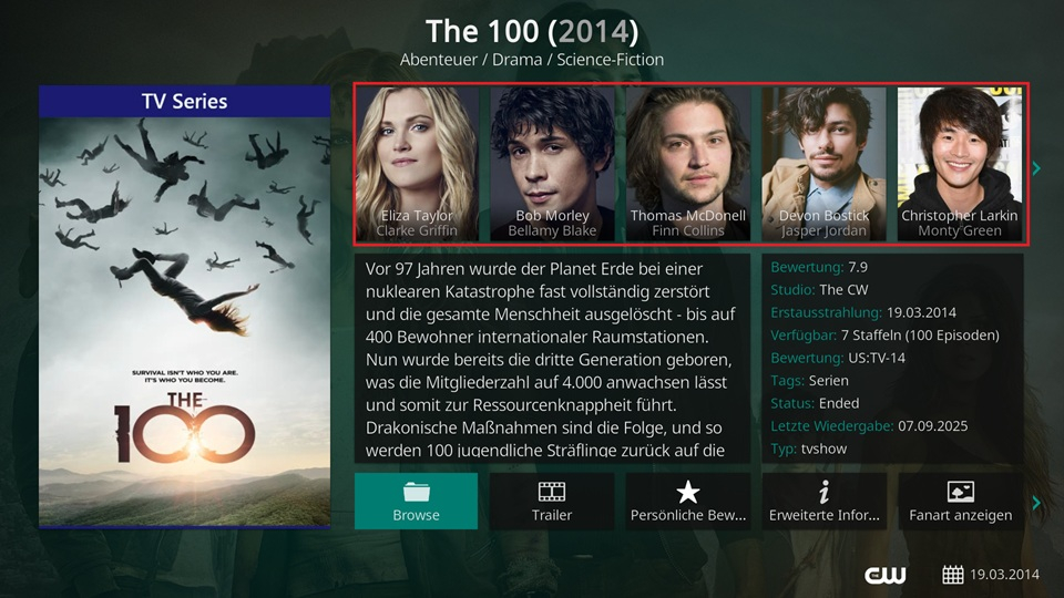

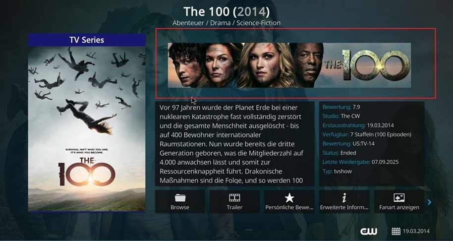

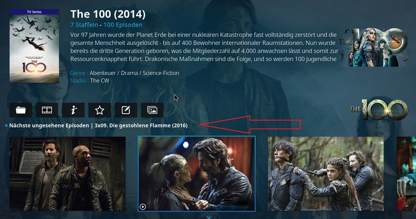

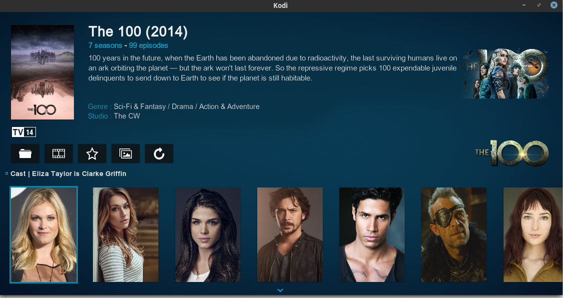

Andy2k 77 Posted September 7, 2025 Posted September 7, 2025 Hi Quickmic, i have another bug on my clients, but im not sure if it is a client or a server problem. E4K Versions are 12.2.1 and 12.3.0. Since i updated my (beta) server from 4.9.1.22 to 4.9.1.23 (and above) i lost on most of my clients the Cast Info on the TV-Show information window. Usualy it shows like this (with stock skin): Now most clients shows only a banner instead of the cast... Estuary Mod v2 shows unseen episodes instead of the cast. A Database reset / update to E4K 12.3.0 and also a factory reset for the plugin made no change. Some idea?
quickmic 1709 Posted September 7, 2025 Author Posted September 7, 2025 25 minutes ago, Andy2k said: Hi Quickmic, i have another bug on my clients, but im not sure if it is a client or a server problem. E4K Versions are 12.2.1 and 12.3.0. Since i updated my (beta) server from 4.9.1.22 to 4.9.1.23 (and above) i lost on most of my clients the Cast Info on the TV-Show information window. Usualy it shows like this (with stock skin): Now most clients shows only a banner instead of the cast... Estuary Mod v2 shows unseen episodes instead of the cast. A Database reset / update to E4K 12.3.0 and also a factory reset for the plugin made no change. Some idea? currently not

Andy2k 77 Posted September 10, 2025 Posted September 10, 2025 (edited) On 9/7/2025 at 9:29 PM, Andy2k said: Hi Quickmic, i have another bug on my clients, but im not sure if it is a client or a server problem. E4K Versions are 12.2.1 and 12.3.0. Since i updated my (beta) server from 4.9.1.22 to 4.9.1.23 (and above) i lost on most of my clients the Cast Info on the TV-Show information window. Usualy it shows like this (with stock skin): Now most clients shows only a banner instead of the cast... On 9/7/2025 at 9:29 PM, Andy2k said: Hi quickmic, i made some tests with a clean Kodi Installation on Windows: Scenario: Clean Kodi by wiping / renaming the ...\appdata\roaming\kodi folder. Kodi 21.2 64bit Version, running on (a allmost clean) Windows 11 Pro. No other addons in Kodi other than stock ones, no additional settings other than language and setting level sometimes to expert. E4k was used in Addon-Mode only, also with stock settings, no helper addons, and i added only my movie and tv-show libraries... Result, against Emby Server Beta 4.9.1.27 + 4.9.1.29 E4k 12.1.0 + 12.1.2 - ok, Actors / Cast shown in TV-Shows information window E4k 12.2.1 + 12.3.1 - nok, only a banner is shown instead of cast. Same result against some older beta server, i have tested 4.9.2.17, 22, 23.... This tells me, something in e4k 12.2.1 and above was changed and cause the artist / cast "bug". But then, i have ONE client, Coreelec 21.2 on odroid n2+, with lastest e4k addon, and all are fine there. On a 2. Coreelec / odroid n2+ some of the tv-shows shown ok, most not... I can provide some logs if you need, and could do some mor testings.... Edited September 10, 2025 by Andy2k 1
