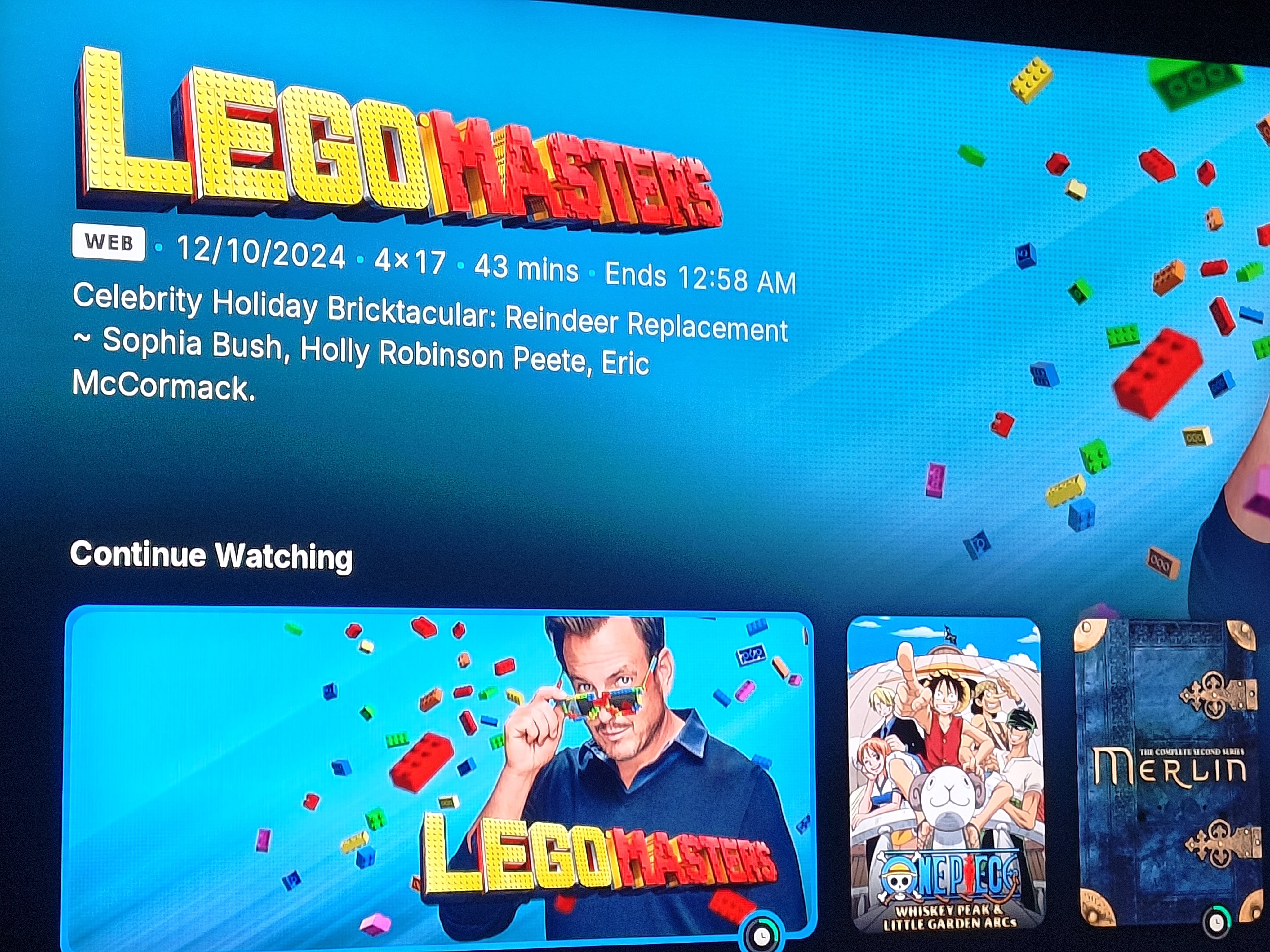

quickmic 1709 Posted July 29, 2025 Author Posted July 29, 2025 (edited) On 7/27/2025 at 8:41 PM, SYNYST3R1 said: More info shows now in the new version, but it says WEB for every show instead of HD, FHD, etc. Can you please post a screenshot. Quote And lastly I cannot play content from continue watching it says playback failed after updating to the new version. I try to tackle this issue, "continue watching" via dynamic nodes with any synced content looks fine. I'll try some other cases too, how do you access the "continue watching"? You synced the content and using dynamic nodes? In this case the dynamic nodes works in hybrid mode. I'll check that too. "Hybrid mode" -> When content is synced and using dynamic mode, only the initial query goes to Emby server but subcontent is loaded (as available) from Kodi's database. So it's partially Emby server info, partially Kodi database info. EDIT: Confirmed, it's a hybrid mode issue. I'll fix it, but I recommend using synced nodes for synced content. Only for views not available on Kodi (e.g. Folder view), dynamic/hybrid is necessary. Edited July 29, 2025 by quickmic
SYNYST3R1 9 Posted July 29, 2025 Posted July 29, 2025 44 minutes ago, quickmic said: Can you please post a screenshot. I try to tackle this issue, "continue watching" via dynamic nodes with any synced content looks fine. I'll try some other cases too, how do you access the "continue watching"? You synced the content and using dynamic nodes? In this case the dynamic nodes works in hybrid mode. I'll check that too. "Hybrid mode" -> When content is synced and using dynamic mode, only the initial query goes to Emby server but subcontent is loaded (as available) from Kodi's database. So it's partially Emby server info, partially Kodi database info. EDIT: Confirmed, it's a hybrid mode issue. I'll fix it, but I recommend using synced nodes for synced content. Only for views not available on Kodi (e.g. Folder view), dynamic/hybrid is necessary. I'm using Emby continue last played (mixed content) for the continue watching widget 1

SYNYST3R1 9 Posted July 31, 2025 Posted July 31, 2025 (edited) Thank you, pretty much everything everything works in the new version! Some shows still don't show ratings and it seems to be for shows with multiple versions for example LEGO Masters (US). It does show in the synced nodes. Not a big deal though. I don't mind using only synced nodes but it seems like the hybrid node was the only way I could get a continue watching node that matches what Emby has? Edited July 31, 2025 by SYNYST3R1 1
quickmic 1709 Posted July 31, 2025 Author Posted July 31, 2025 (edited) 1 hour ago, SYNYST3R1 said: Thank you, pretty much everything everything works in the new version! Some shows still don't show ratings and it seems to be for shows with multiple versions for example LEGO Masters (US). It does show in the synced nodes. Not a big deal though. I don't mind using only synced nodes but it seems like the hybrid node was the only way I could get a continue watching node that matches what Emby has? Welcome, I put the rating on the review list. btw, transcoding for dynamic nodes seems not working (in case you use it). Edited July 31, 2025 by quickmic 1
