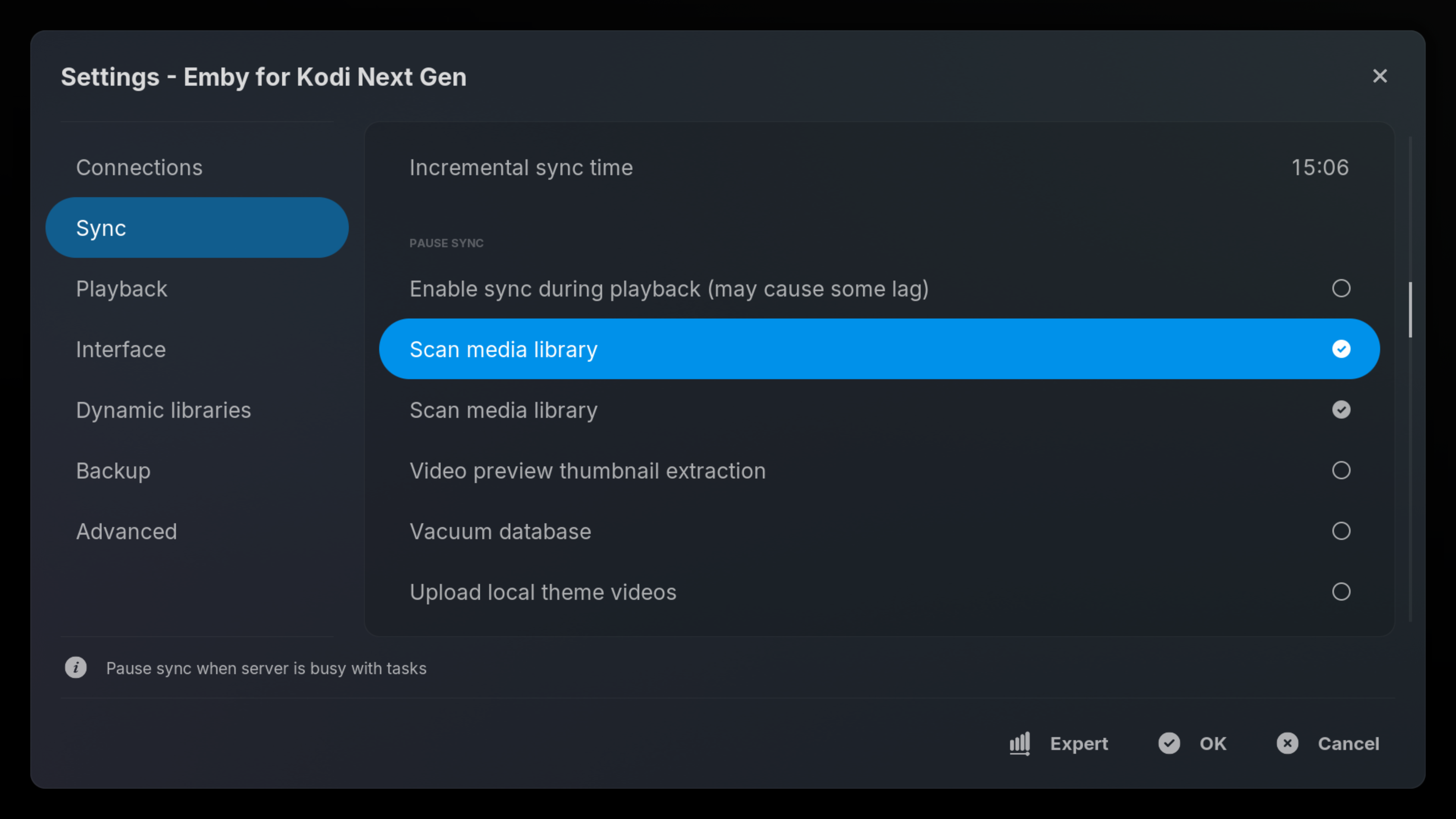

FrostByte 5452 Posted July 27, 2025 Posted July 27, 2025 v 12.1.1 "Scan media library" is duplicated Also, the descriptions don't match the option selected. "Pause sync when server is busy with tasks" is the same description for about 10 options. 1
quickmic 1709 Posted July 28, 2025 Author Posted July 28, 2025 (edited) 7 hours ago, FrostByte said: v 12.1.1 "Scan media library" is duplicated Also, the descriptions don't match the option selected. "Pause sync when server is busy with tasks" is the same description for about 10 options. Confirmed, will be fixed. There are some translation issues. Leave the first 3 options enabled in this section, the "Enable sync during playback" is also wrong. Edited July 28, 2025 by quickmic 1
