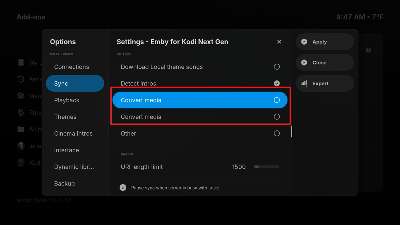

FrostByte 5453 Posted February 1 Posted February 1 There is a duplicate setting Sync, though the description is different. v12.4.10 (though it may have been there before). 1
