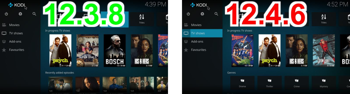

TheOverseer 8 Posted January 27 Posted January 27 @quickmicI've updated from 12.3.8 to 12.4.6 and "Recently added episodes" under TV shows has disappeared. Using the default Kodi skin (Estuary) 1
quickmic 1709 Posted January 27 Author Posted January 27 2 minutes ago, TheOverseer said: @quickmicI've updated from 12.3.8 to 12.4.6 and "Recently added episodes" under TV shows has disappeared. Using the default Kodi skin (Estuary) Sounds also a bit like the timedate issue. Same you you, can you send me a kodi.log right after a re-sync?

TheOverseer 8 Posted January 27 Posted January 27 9 minutes ago, quickmic said: Sounds also a bit like the timedate issue. Same you you, can you send me a kodi.log right after a re-sync? kodi.log 1
quickmic 1709 Posted January 27 Author Posted January 27 1 minute ago, curiouscur said: made another hard reset and go with 12.3.8 addon default mode (addon) and http sync and playback is no problem (wasn't with 12.4.6 either) only difference is - shut down/reboot/restart kodi is executing instant without problems maybe it has to do something with the local db generated from the sync? are there differences between 12.3.8 and 12.4.6? unfortunately i have no other idea yet... thank you for your time kodi.log 99.71 kB · 0 downloads kodi.old.log 42.83 kB · 0 downloads So it's a infinite reboot?
quickmic 1709 Posted January 27 Author Posted January 27 (edited) 7 minutes ago, TheOverseer said: kodi.log 2.99 MB · 0 downloads Thanks, and I can see the issue. 2026-01-27 17:28:32.124 T:16692 error <general>: EMBY.helper.utils: convert_to_local Error: Invalid isoformat string: '2023-04-26T23:00:00.0000000Z' You are using Kodi 21 (with <= python3.10). Seems that's the problem, as Kodi 22 uses a new python version supporting this format. Edited January 27 by quickmic

quickmic 1709 Posted January 27 Author Posted January 27 New PUBLIC TESTING version available 12.4.7: Delta changelog 12.4.6 -> 12.4.7 fix timeformat issue for Kodi 21 1
GavinCampbell 16 Posted January 27 Posted January 27 1 hour ago, quickmic said: Thanks, and I can see the issue. 2026-01-27 17:28:32.124 T:16692 error <general>: EMBY.helper.utils: convert_to_local Error: Invalid isoformat string: '2023-04-26T23:00:00.0000000Z' You are using Kodi 21 (with <= python3.10). Seems that's the problem, as Kodi 22 uses a new python version supporting this format. I came to share my log and noticed that same error. Tried the new version you just posted and its working great again. So I believe this is now fixed for me. Thanks again. Will continue to play with the latest versions. 1
