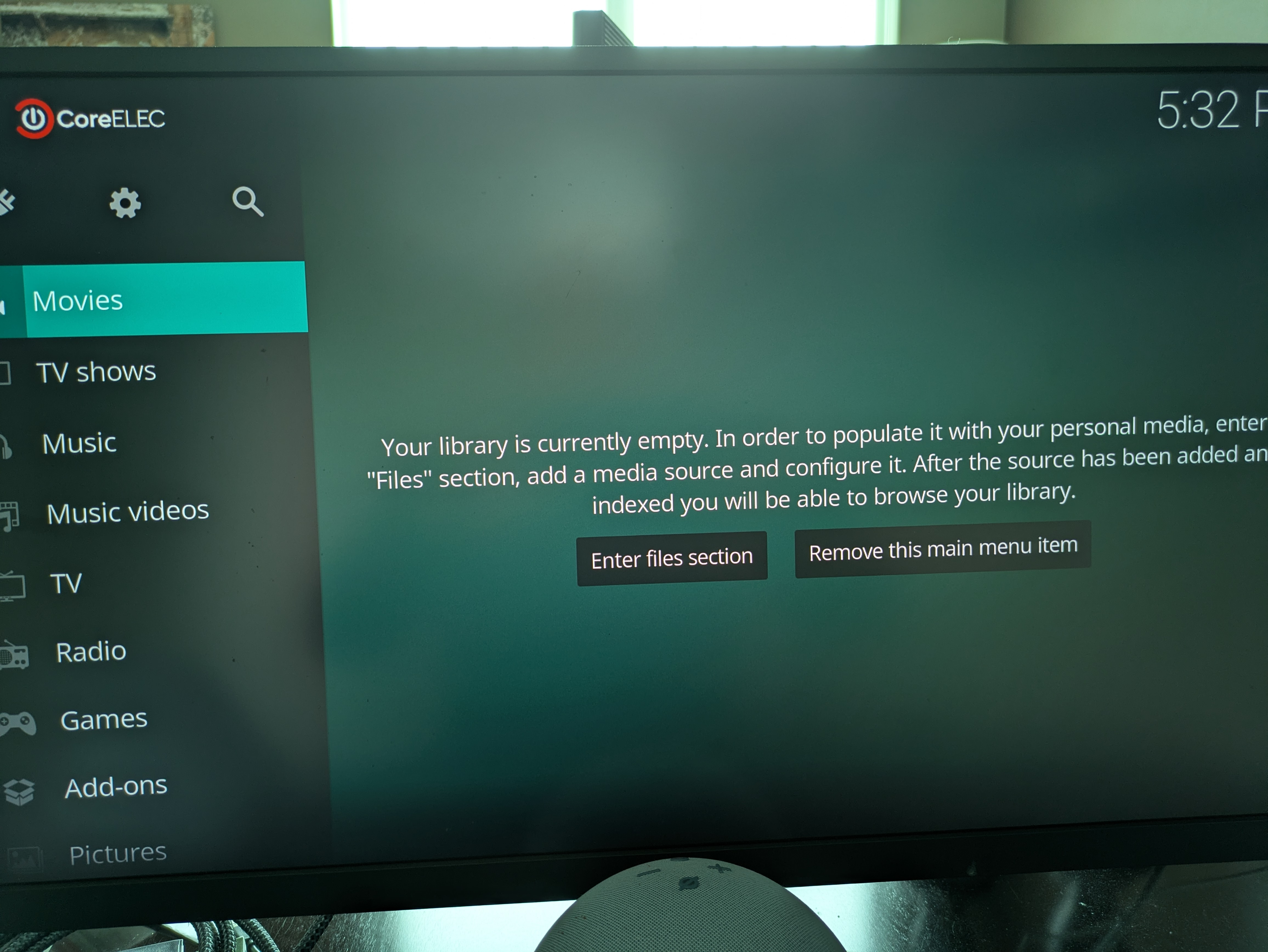

daniel.bmyer 11 Posted January 11 Posted January 11 Ok, this is crazy but I can't figure out how to get to a playing now screen. I'm testing everything and so far so good except for one dumb thing. I started a movie and hit the back button on my remote and it went to the info screen but I can hear the movie still playing in the background and at the top right corner there's a little arrow with the name of the show I'm watching but I can't figure out how to get back to the episode. There's no Now Playing screen and I simply can't get the movie to show...what the hell lol
Kyrunner 86 Posted January 11 Posted January 11 16 minutes ago, daniel.bmyer said: Ok, this is crazy but I can't figure out how to get to a playing now screen. I'm testing everything and so far so good except for one dumb thing. I started a movie and hit the back button on my remote and it went to the info screen but I can hear the movie still playing in the background and at the top right corner there's a little arrow with the name of the show I'm watching but I can't figure out how to get back to the episode. There's no Now Playing screen and I simply can't get the movie to show...what the hell lol Ditch the remote kodi is best used with a keyboard.
daniel.bmyer 11 Posted January 11 Posted January 11 1 hour ago, Kyrunner said: Ditch the remote kodi is best used with a keyboard. I'm 8ft away from my audio/video system where all this resides so that's not possible. Anyhow, I don't think this has anything to do with the remote. When I was actually testing it I was hooked up to my computer monitor and using the keyboard. THe issue is I can't find a now playing screen....even though I have it enabled in the settings.

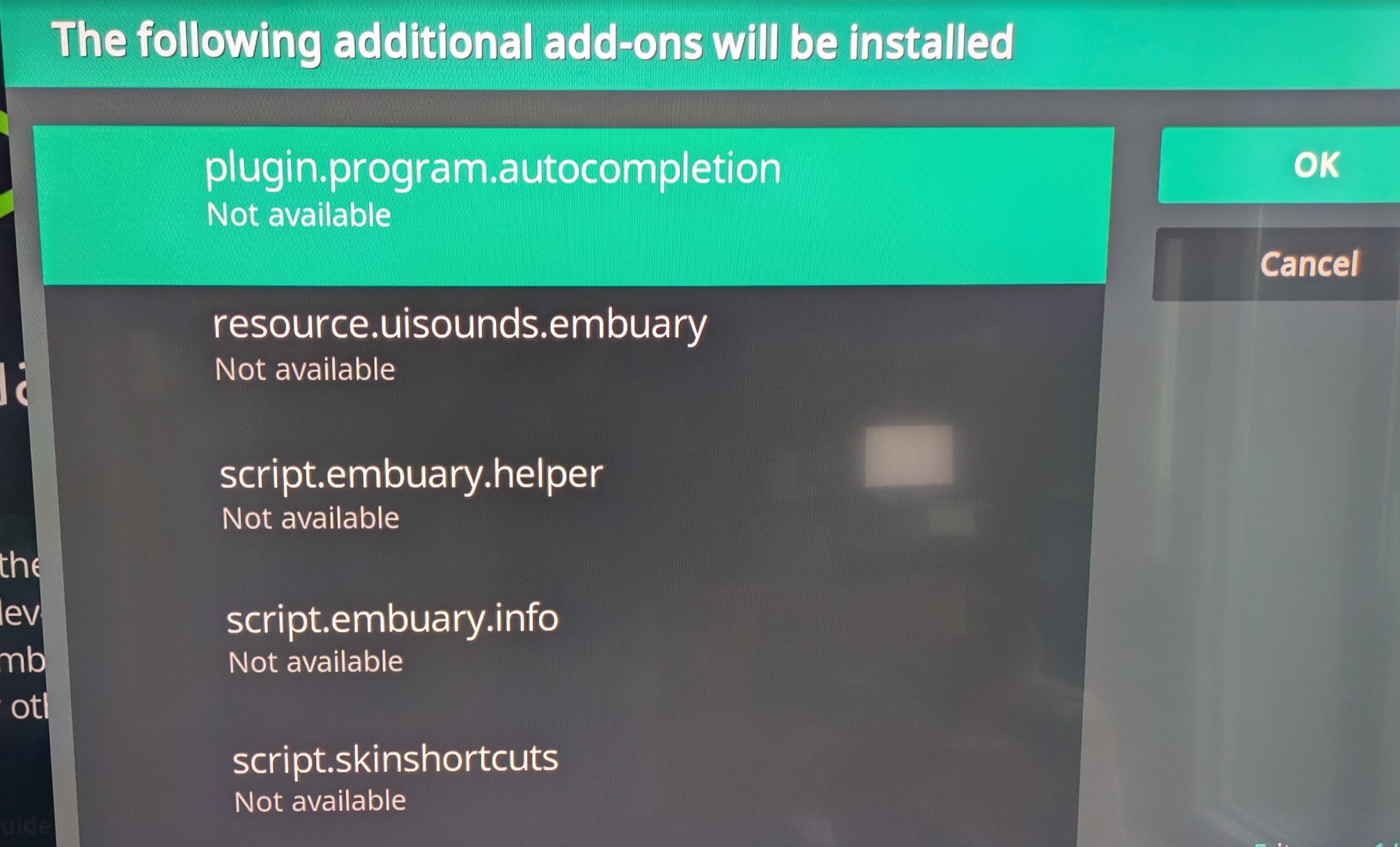

daniel.bmyer 11 Posted January 13 Posted January 13 (edited) On 1/10/2026 at 10:24 AM, Kyrunner said: I wrote up a quick Mark Down File. I'm assuming you have already flashed CorElEC on your Ugoos amb6+. This will get you started its alot but i have given you good links to get started.Emby-Kodi-Installation-Guide.md I'm runing into some trouble and have 2 questions. I'v reinstalled my ugoos device with coreelec and and now running into a problem reinstalling emby. Using the guide attached from above from Kyrunner, , when I get to this part I get an error about script.module.dateutil not available and it won't install. Which is odd as I didn't get that error the first time. Not sure what to do now... ## Step 2: Install Emby for Kodi Add-on 1. Go to **Add-ons > Install from repository**. 2. Select **Kodi Emby Add-ons**. 3. Choose **Video Add-ons**. 4. Select **Emby** and click **Install**. The other issue I see is when clicking install it shows the following additional add-ons will be installed script.module.dateutil - not available Emby for Kodi Next Gen - Minimum 10.0.25 => Install 12.3.8 I'm not sure if it's telling me I have the wrong version? Do I need to install Next Gen 12.4 separately and if so how? Edited January 13 by daniel.bmyer additional info
daniel.bmyer 11 Posted January 13 Posted January 13 Man, I'm dying here. I just can't seem to get anything installed properly. I managed to get something done and I'm now trying to install some skins but they are all coming back with all these dependencies that are not available For example I'm trying to install Embuary and getting Plugin.program.autocompletion - not available script.embuary.helper - not available screip.embuary.info - not available etc etc For the life of me I can't figure out what I'm doing wrong.
daniel.bmyer 11 Posted January 13 Posted January 13 (edited) Sorry for all these posts but it's driving me nuts that I can't get this installed when I did just a few days ago. So now I have reflashed by drive and used CoreELEC-Amlogic-ng.arm-21.3-Omega-Generic.img.gz. My Ugoos has now booted up. At this point all I should have to do is the following steps below. Is that correct? ..OR do I just copy the plugin.service.emby-next-gen-12.4.0.zip to the device and install from zip file and that's it and I don't have to do any of the below except to install a skin? For Dolby Vision: Ugoos AM6+ (or AM6b+) running CoreELEC (recommended over vanilla for enhanced features). Nothing else needs to be installed before doing the below steps? ## Step 1: Install Emby Repository 1. Open Kodi and navigate to **File Manager**. 2. Select **Add source**. 3. Enter `http://kodi.emby.media` as the source URL and name it "Emby". 4. Go back to Kodi home screen. 5. Navigate to **Add-ons > Install from zip file**. 6. Select the Emby source you added. 7. Install the repository zip file (e.g., `repository.emby.kodi-1.0.8.zip` for stable or beta versions). ## Step 2: Install Emby for Kodi Add-on 1. Go to **Add-ons > Install from repository**. 2. Select **Kodi Emby Add-ons**. 3. Choose **Video Add-ons**. 4. Select **Emby** and click **Install**. -----------------------------------------------------------------------------------------------------this part fails due to dependencies 5. If dependencies fail, download them from `http://kodi.emby.media/Public testing/Dependencies/`. ------------------------ > this url doesn't exist ## Step 3: Configure Emby for Kodi 1. Launch the Emby add-on (or restart Kodi). 2. Select server discovery or manually enter your Emby server URL (e.g., `http://your-emby-server-ip:8096`). 3. Log in with your Emby credentials or use Emby Connect. 4. Choose playback mode: - **Add-on mode** (recommended for best performance). - **Native mode** (if Kodi needs direct file access). 5. Select Emby libraries to sync to Kodi's database. 6. Complete initial sync (may take time for large libraries). Edited January 14 by daniel.bmyer clarification
daniel.bmyer 11 Posted January 14 Posted January 14 Ok so figured out what I was mostly doing wrong. I had to install the 12x and then the additional 3 files listed on the 1st page. It all installed fine and I upgraded to avplus r5. Last problem is I cannot install any skins for the Jamal repository. I get the following type errors.
