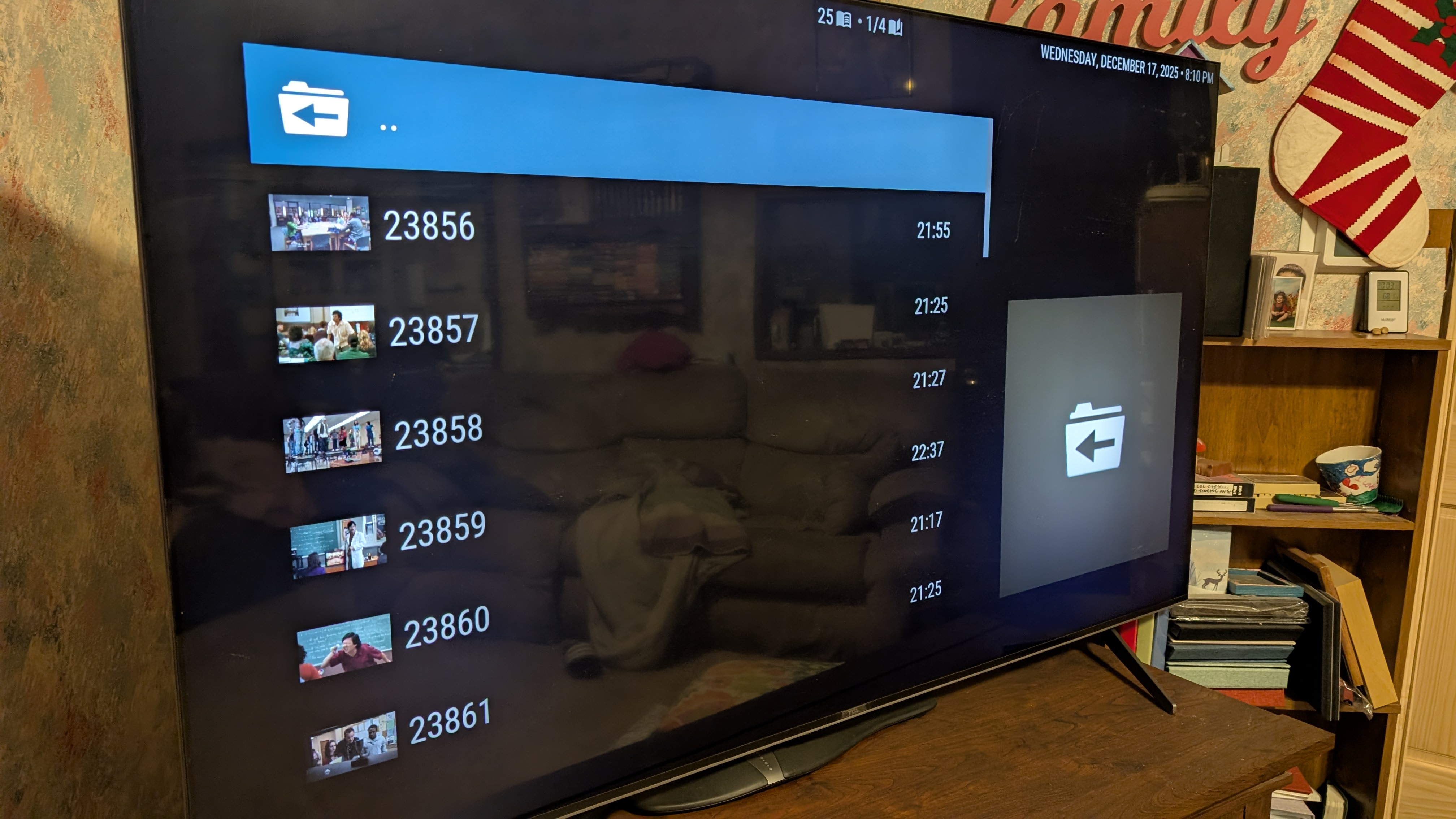

TheFreeMan 36 Posted December 18, 2025 Posted December 18, 2025 Just updated to 12.3.7. I was on 12.3.5. I started noticing this with one particular show on 12.3.5, and now it seems it's on many of them: This is from the Emby | TV listing (the menu entry is: emby_dynamic_mixedvideo_TV/series_series.xml) BUT... It displays the proper episode name and information when I look at it in Next Episodes (emby_nextepisodes_GUID). I don't know how long it's been doing this - we recently ran out of episodes on many of the shows we'd been watching, and I decided to look for a couple of new shows. This turned up then. 1

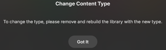

quickmic 1709 Posted December 22, 2025 Author Posted December 22, 2025 (edited) On 12/18/2025 at 9:32 PM, TheFreeMan said: Just updated to 12.3.7. I was on 12.3.5. I started noticing this with one particular show on 12.3.5, and now it seems it's on many of them: This is from the Emby | TV listing (the menu entry is: emby_dynamic_mixedvideo_TV/series_series.xml) BUT... It displays the proper episode name and information when I look at it in Next Episodes (emby_nextepisodes_GUID). I don't know how long it's been doing this - we recently ran out of episodes on many of the shows we'd been watching, and I decided to look for a couple of new shows. This turned up then. I can see, you use a mixed content video library on Emby server, which is generally not the best idea. However, it should work as long as the server detects the content correctly. What is the content listed in your screenshot? Looks like videos not episodes, right? Doe you have videos in the mixed library or are these videos (LiveTV) recorded episodes? Edited December 22, 2025 by quickmic
TheFreeMan 36 Posted December 23, 2025 Posted December 23, 2025 (edited) On 12/22/2025 at 1:12 AM, quickmic said: you use a mixed content video library on Emby server I have no idea how or why I would have ever done that!!! This is a TV shows library, I'm 99.99% certain I would have selected a TV/Show/Episode type for it. Weirdly, ALL of my Emby libraries are "Mixed content" - I'm really quite certain that I wouldn't have done that - I would have tagged the TV library as TV Shows, the Movie library as movies, the Music library as music... On 12/22/2025 at 1:12 AM, quickmic said: What is the content listed in your screenshot? Looks like videos not episodes, right Nope. Those are episodes (Community S01E01 - E06 being displayed). If I If I do this, I'm going to loose all my watch history, aren't I? :( Am I most likely going to have to bite the bullet and do this if I ever hope to get Emby/ENG working correctly again? I wonder... I changed my mount points around a while back to work better on Unraid and allow for hard linking instead of copying. I wonder if, when I did that and changed the mappings for the Emby docker container if that somehow confused it and changed them all to Mixed Content... Edited December 23, 2025 by TheFreeMan
