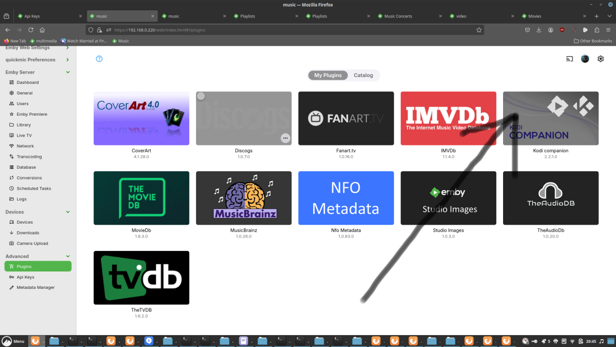

Juancafr 2 Posted November 20, 2025 Posted November 20, 2025 3 hours ago, FrostByte said: The service is the first thing you should install, the other 3, if wanted, depend on the service Also install Kodi companion from the Emby plugin catalogue there is no required skin. I like AF2, QM likes an Estuary mod. I keep getting a message that I don't have a companion app, and I've looked everywhere but can't figure out how to install it. It's not showing up in the repositories or anywhere.
FrostByte 5452 Posted November 20, 2025 Posted November 20, 2025 2 hours ago, Juancafr said: One thing, when it asks what you want to sync, do you select all of them or do it one by one? I selected all of them; I don't know if that matters. And I've only installed the plugin service; I haven't installed the others yet. I don't know if that's relevant either. I have a Vontar X4 with CoreElec. That could be an issue. I only select the ones I want. I seem to recall selecting one I didn't have before, and it took a while to finish.
FrostByte 5452 Posted November 20, 2025 Posted November 20, 2025 (edited) 1 hour ago, Juancafr said: I keep getting a message that I don't have a companion app, and I've looked everywhere but can't figure out how to install it. It's not showing up in the repositories or anywhere. Did you install the Kodi companion plugin on your Emby server? Edit: it's not in a Kodi repository. Edited November 20, 2025 by FrostByte

FrostByte 5452 Posted November 21, 2025 Posted November 21, 2025 11 minutes ago, Juancafr said: Oh okay, what is accessing from the browser, right? The service should I install it myself? I'm not the one who has the files locally, that's why I ask Yes, this is done from the Emby server using a web browser. Whoever is the admin for the Emby server will need to do this. The location of the media being played is irrelevant. From Emby server Click settings icon in the top right corner Plugins tab from side Catalog tab from top find the Kodi companion plugin and install
Juancafr 2 Posted November 21, 2025 Posted November 21, 2025 16 minutes ago, FrostByte said: Yes, this is done from the Emby server using a web browser. Whoever is the admin for the Emby server will need to do this. The location of the media being played is irrelevant. From Emby server Click settings icon in the top right corner Plugins tab from side Catalog tab from top find the Kodi companion plugin and install Ok, thanks!
Juancafr 2 Posted November 21, 2025 Posted November 21, 2025 12 hours ago, quickmic said: Correct me if I'm wrong, but I think only the person who owns the Emby server can access it, right? In my case, I subscribed to the service, I'm not the one maintaining it. I entered my device's IP address and nothing happened.
quickmic 1709 Posted November 21, 2025 Author Posted November 21, 2025 (edited) 2 hours ago, Juancafr said: Correct me if I'm wrong, but I think only the person who owns the Emby server can access it, right? In my case, I subscribed to the service, I'm not the one maintaining it. I entered my device's IP address and nothing happened. Every user can access the emby server, but only the admin users can install plugins. Not sure which IP you entered, but it's not the IP of your Kodi box. It's the emby server URL. You should ask the owner to install the plugin, without the plugin you lose the capability to sync deleted content. (Content removed from the server will not be removed from Kodi) Edited November 21, 2025 by quickmic 1 1
