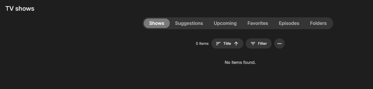

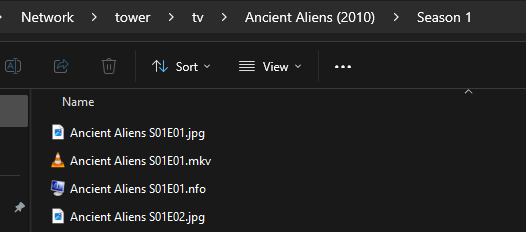

dlraven 4 Posted June 11, 2025 Posted June 11, 2025 I've run into an issue that I'm haven't been able to resolve. I'm attempting to add my TV Shows library (Z: or \\tower\tv) to Emby, but the library is always empty. No shows. No folders. Completely empty. Manually rescanning the library does not add the missing data. I've dug through the logs and can only find a single error relating to this folder (see below). The Z: drive is a SMB share on another machine. I have mapped several other SMB shares on the same machine and they all work fine. It's only this directory that's giving me grief. I've removed the credential from Windows and readded it, but still the same issue. I did notice that when I create the library using the mapped drive (Z:), I do see the sub-folders so it does appear Emby can access the share. I've included a screenshot of an example directory from the Emby server and the log file as well. What have I broken? Any thing I can try would be greatly appreciated. Environment: Windows 11 Pro Emby Server: 4.8.11.0 User Login (not service account) Destination: Various SMB shares on Unraid Error App: Error getting file \\tower\TV *** Error Report *** Version: 4.8.11.0 Command line: C:\Users\david\AppData\Roaming\Emby-Server\system\EmbyServer.dll -noautorunwebapp Operating system: Microsoft Windows 10.0.26100 Framework: .NET 6.0.36 OS/Process: x64/x64 Runtime: C:/Users/david/AppData/Roaming/Emby-Server/system/System.Private.CoreLib.dll Processor count: 24 Data path: C:\Users\david\AppData\Roaming\Emby-Server\programdata Application path: C:\Users\david\AppData\Roaming\Emby-Server\system System.ArgumentNullException: System.ArgumentNullException: Value cannot be null. (Parameter 'key') at System.ThrowHelper.ThrowArgumentNullException(String name) at System.Collections.Concurrent.ConcurrentDictionary`2.GetOrAdd(TKey key, Func`2 valueFactory) at MediaBrowser.Controller.Providers.DirectoryService.GetFile(String directory, String filename, Boolean caseSensitive) at Emby.Providers.Manager.MetadataService`2.TryGetFile(String path, IDirectoryService directoryService) Source: System.Collections.Concurrent TargetSite: Void ThrowArgumentNullException(System.String) embyserver(1).txt

Luke 43553 Posted June 13, 2025 Posted June 13, 2025 What do you see in the web app when browsing that library?

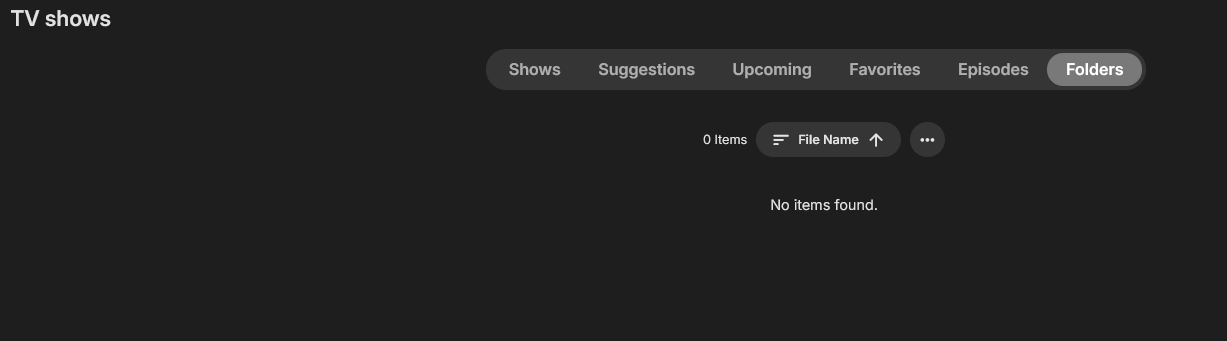

dlraven 4 Posted June 13, 2025 Author Posted June 13, 2025 Nothing. It's completely empty. Bizarre, isn't it.
dlraven 4 Posted June 13, 2025 Author Posted June 13, 2025 Also completely empty. I know the Emby server can see the contents of that folder. If I setup a mapped network drive to the share (\\tower\tv) and then select that mapped drive letter within Emby when setting up the library, it can see all of the sub-folders, but it's blank within Emby.
Solution dlraven 4 Posted June 13, 2025 Author Solution Posted June 13, 2025 I figured it out. I'm stupid. At some point, I put in a .ignore file in the TV folder causing the entire directory to be ignored. Removed that and everything started working okay. Sorry, for taking up your time and thank you for the assistance. 1
