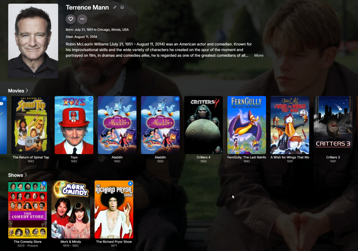

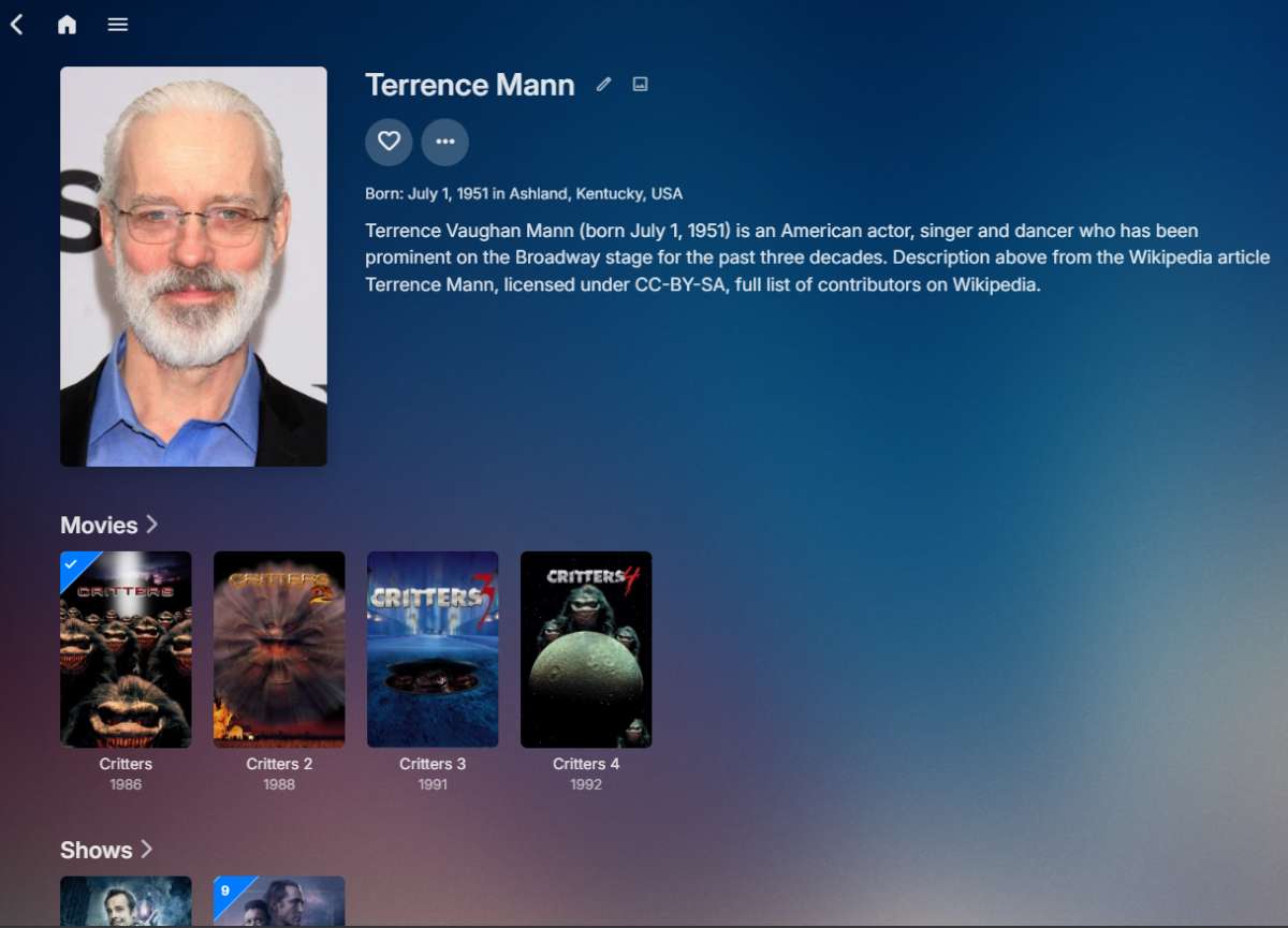

nmkaufman 51 Posted June 10, 2025 Posted June 10, 2025 (edited) I noticed a few days ago that Robin Williams was missing from the cast of Good Will Hunting. Instead it listed someone named "Terrence Mann." I figured out that "Terrence Mann" is actually Robin Williams, so I used the 'identify' function to point Emby at Robin Williams, and refreshed metadata for the person. Emby has now combined Terrence Mann and Robin Williams into one broken person, who's acted in both Good will Hunting and the Critters movies. Refreshing metadata does not resolve the issue, and I'm not sure where to begin fixing these sorts of problems. I would really love a function where I can explode the entire 'people' database and rebuild. I know these sorts of incongruencies are sprinkled throughout my library. I can't remember where I saw it, but I watched something a few months ago that allegedly had JFK in the cast. Edited June 10, 2025 by nmkaufman
Happy2Play 9817 Posted June 10, 2025 Posted June 10, 2025 No easy way since People are built via the provider metadata for media, in the end you will have to remove every item shown for a person to remove their linked data, do a full scan to clear the linked items from the db, and readd the items. Note if you write nfo files they would be messed up also as they should have this wrong information also. 2 hours ago, nmkaufman said: Refreshing metadata does not resolve the issue, and I'm not sure where to begin fixing these sorts of problems. What external ids are shown for the Actor as they would appear all to point Robin Williams? But correcting the externalids and Refreshing may help some but think you will have to do everything above.

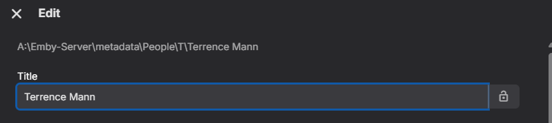

Solution Happy2Play 9817 Posted June 10, 2025 Solution Posted June 10, 2025 1 hour ago, nmkaufman said: It does look like the nfo files erroneously point to Robin Williams (as Terrence Mann). What's the easiest path forward? Delete all nfo files, then remove & re-add my movies library? Critters 4 (1992).nfo 4.66 kB · 1 download Unfortunately yes, remove library, preform full scan to clear the items from the database, ensure nfo files do not exist, readd library. Basically since it affect the person in Movie and TV libraries you would have to do both. Now if it is only this person then you would just need to remove that specific media shown on said person. You may have to manually delete the person from the /metadata/people/t/actor name folder. 1
