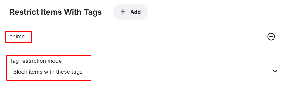

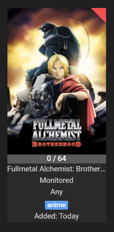

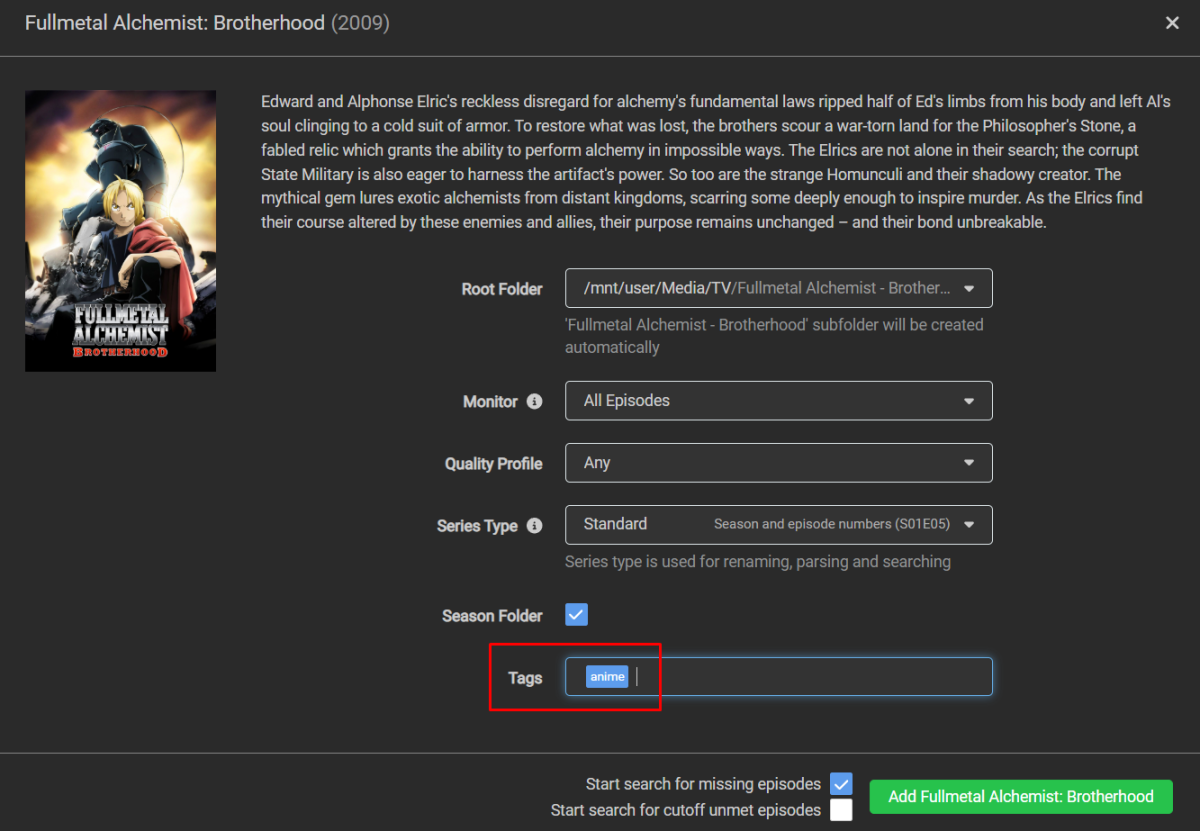

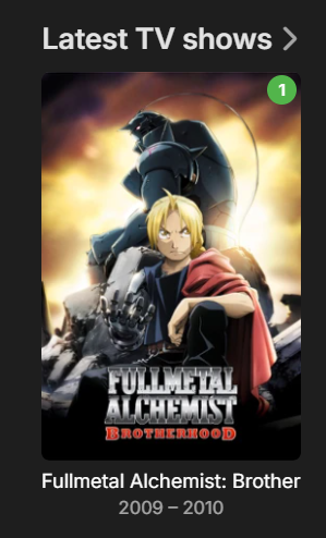

maxpayn3 1 Posted June 8, 2025 Author Posted June 8, 2025 (edited) Absolutely. I will add additional information (logs etc), once this feature is confirmed to exist and I have issue with it. Up until now I couldn't find a setting to make it work. Here are the steps to reproduce the problem: 1. In Sonarr I will add a show ie: Fullmetal Alchemist, I will add the tag anime as shown below. 2. Confirm the show is added in Sonarr with the right tag. (Note that Sonarr has an autotag feature which does it automatically as well) 3. Apply restrictions on tag anime in the Parental Controls. 4. Load up Emby (for this demonstration purpose I am using web version) with the account that has the restriction. Notice how the show Fullmetal Alchemist is still showing / available despite the tag anime is restricted. 5. Manually add the tag and save. 6. Now the show disappeared from the list. Basically Jellyfin does this automatically which saves a lot of time and hassle, yet I can't find the same solution for Emby, unfortunately. Thank you for your help. Edited June 8, 2025 by maxpayn3
