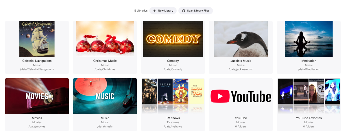

Aldursil 15 Posted June 8, 2025 Author Posted June 8, 2025 10 minutes ago, Luke said: Were the libraries already setup that way though, even in that db? Only the /data/Youtube library was set up. I had not tried to add any child libraries beneath this. I'll create another volume mapping in Docker for the other library so the content does not get mixed together into one library.
Solution Aldursil 15 Posted June 8, 2025 Author Solution Posted June 8, 2025 I restored from backup and then created the new docker mapping and created the new library and now everything is working again and working as I want with the two new libraries. Thanks for all the feedback. 1
sa2000 697 Posted June 9, 2025 Posted June 9, 2025 (edited) great On 07/06/2025 at 17:25, Happy2Play said: @sa2000isn't that the same issue? yes looks the same The log suggests 2 sets of overlaps - would need to see the library definitions 2025-06-06 23:32:33.252 Info LibraryMonitor: Stopping directory watching for path /data/CelestialNavigations 2025-06-06 23:42:23.467 Info LibraryMonitor: Stopping directory watching for path /data 2025-06-06 23:42:23.480 Info LibraryMonitor: Stopping directory watching for path /data/Christmas 2025-06-06 23:42:23.481 Info LibraryMonitor: Stopping directory watching for path /data/Comedy 2025-06-06 23:42:23.481 Info LibraryMonitor: Stopping directory watching for path /data/jackiesmusic 2025-06-06 23:42:23.481 Info LibraryMonitor: Stopping directory watching for path /data/Meditation 2025-06-06 23:42:23.481 Info LibraryMonitor: Stopping directory watching for path /data/movies 2025-06-06 23:42:23.481 Info LibraryMonitor: Stopping directory watching for path /data/music 2025-06-06 23:42:23.483 Info LibraryMonitor: Stopping directory watching for path /data/tvshows 2025-06-06 23:42:23.483 Info LibraryMonitor: Stopping directory watching for path /data/Youtube 2025-06-06 23:42:23.483 Info LibraryMonitor: Stopping directory watching for path /data/Youtube/VINwiki I see overlaps for "/data" and one further overlap one level down between "/data/Youtube" and "/data/Youtube/VINwiki" This overlapping with all the others 2025-06-06 23:42:23.467 Info LibraryMonitor: Stopping directory watching for path /data and this overlapping with the lower level path 2025-06-06 23:42:23.483 Info LibraryMonitor: Stopping directory watching for path /data/Youtube 2025-06-06 23:42:23.483 Info LibraryMonitor: Stopping directory watching for path /data/Youtube/VINwiki Double check all the libraries folder path and make sure no overlaps of parent / child folders Edited June 9, 2025 by sa2000 1
