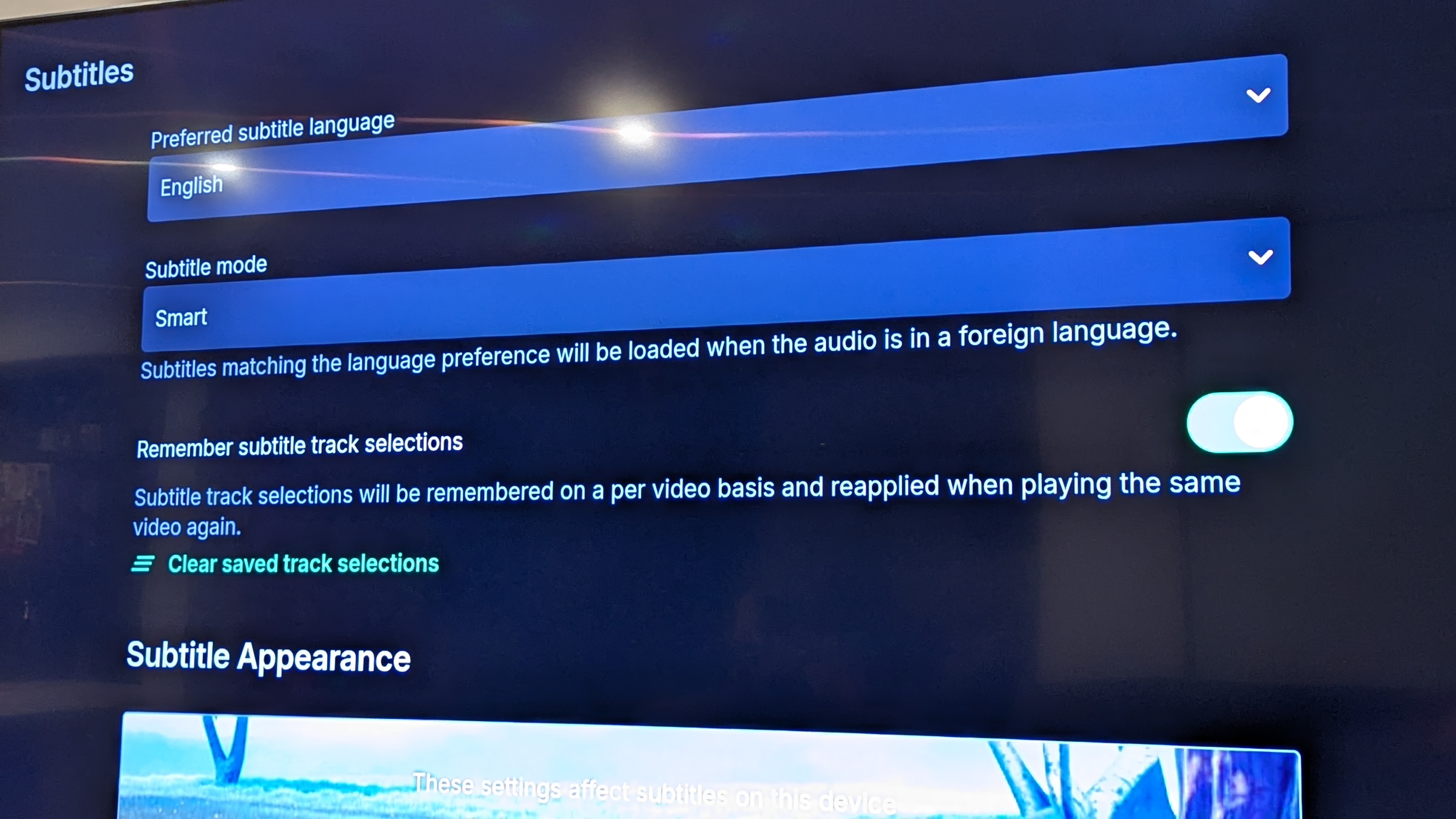

GrimReaper 4928 Posted June 6, 2025 Posted June 6, 2025 8 minutes ago, tOLJY said: for this particular media, it doesn't turn on the forced English subtitles for those files. Specific example would be required: what audio/subtitle tracks does that media have, screenshot of your audio and subtitles settings.

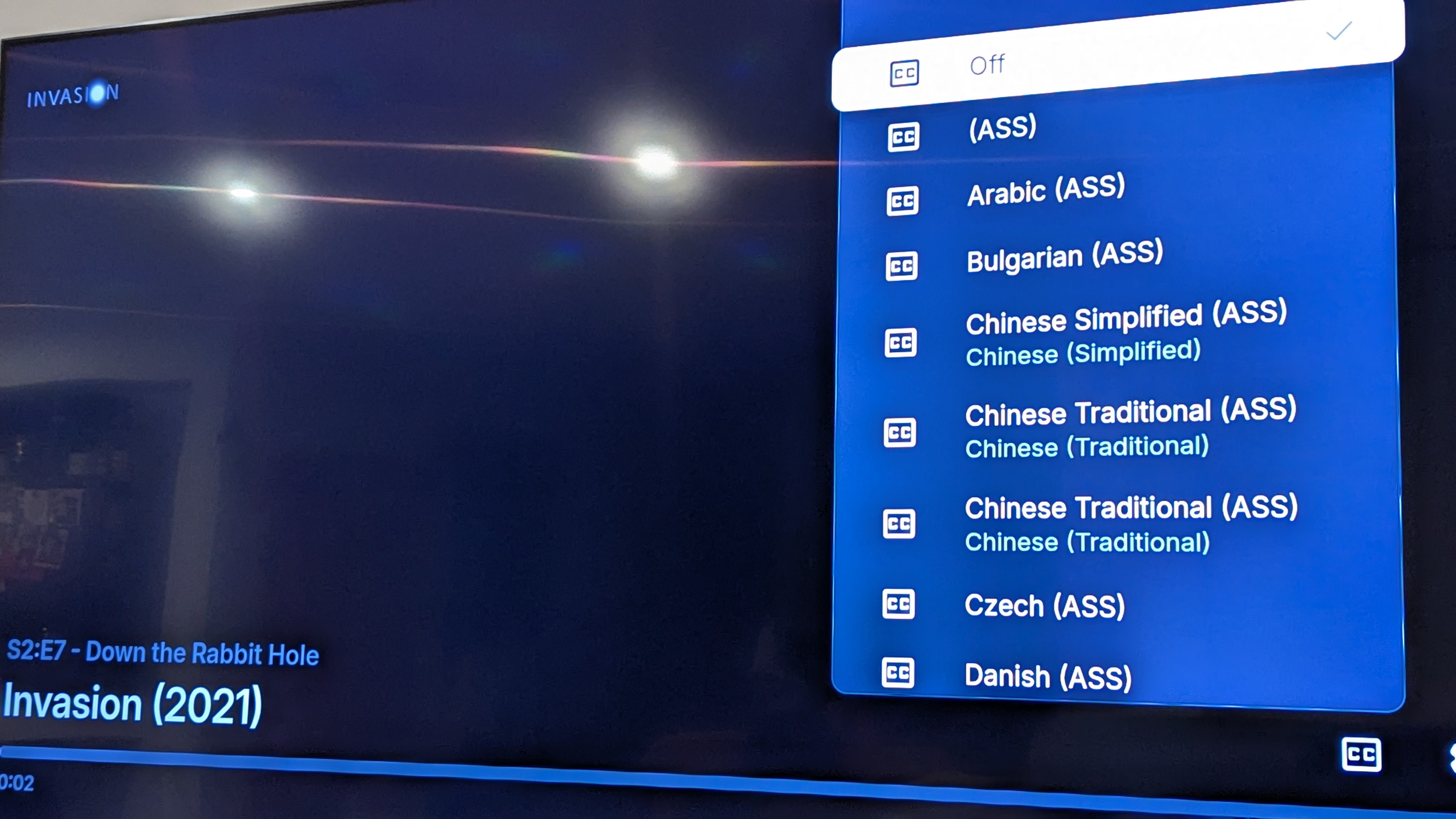

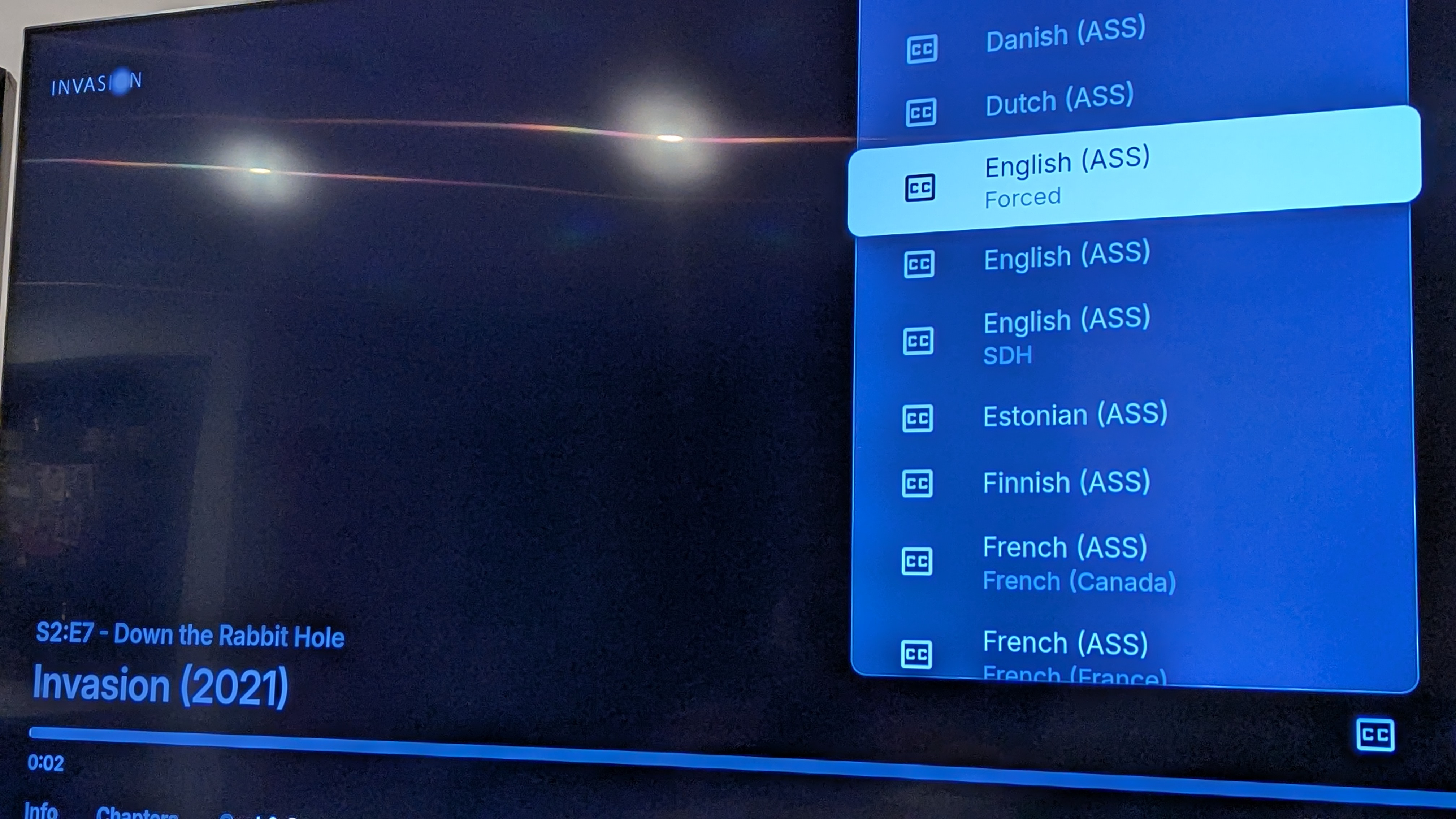

tOLJY 52 Posted June 6, 2025 Author Posted June 6, 2025 Language is English I'd expect subtitles for English - forced to be applied, even if there were other English subtitles. Which there are in this case. I presume forced subtitles for your audio language should always be applied, but the question of what to do when there are multiple forced for the audio language? Not the case here though. Images attached.
GrimReaper 4928 Posted June 7, 2025 Posted June 7, 2025 (edited) Does Default mode give you desired result? (Need to check it on an Unplayed item or need to Clear saved tracks selection) Edited June 7, 2025 by GrimReaper

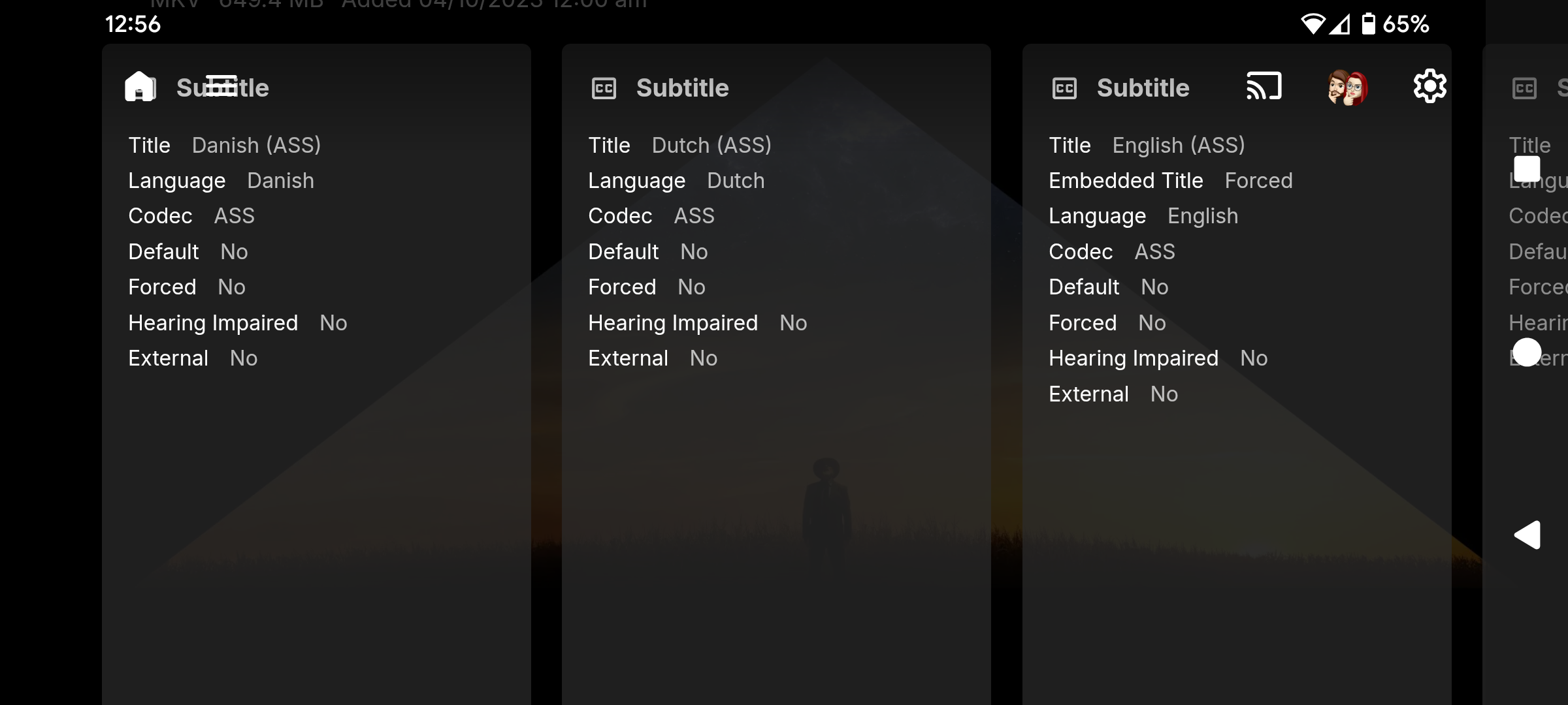

GrimReaper 4928 Posted June 7, 2025 Posted June 7, 2025 Can you share a screenshot of that item MediaInfo section (bottom of detail screen) where those English subs are visible?
tOLJY 52 Posted June 7, 2025 Author Posted June 7, 2025 good idea, attached now. What I can see here is that forced is set to false - not sure if that's determined by emby or just read from the data - am I right in saying that this subtitle is not actually marked as forced by the provider and just named forced? If so, is it possible for emby to assume a subtitle is forced if it has a title of forced?
Solution GrimReaper 4928 Posted June 7, 2025 Solution Posted June 7, 2025 That's what I was suspecting, that "forced" flag is not enabled on those subs, but that it's just embedded title. Just now, tOLJY said: not sure if that's determined by emby or just read from the data It comes from metadata. 1 minute ago, tOLJY said: am I right in saying that this subtitle is not actually marked as forced by the provider and just named forced? Correct. 2 minutes ago, tOLJY said: If so, is it possible for emby to assume a subtitle is forced if it has a title of forced? Nope, "forced" flag needs to be enabled. Any tool of your preference (like MKVToolNix) should make short work of it. 1
