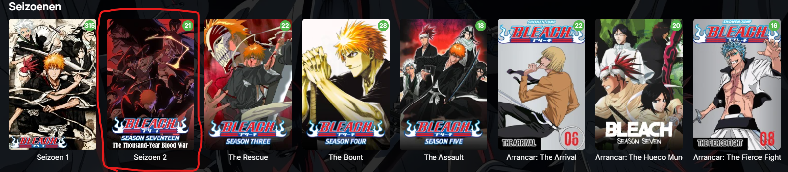

I'm having some issues adding meta data to the show Bleach (2004).
The reason for this is that Bleach (2004) Season 02 keeps being identified as Bleach (2021) Season 02 which is a renewal.
I've tried (among other things) the following:
Bleach (2004) [tvdbid=74796] / Season 02  / Bleach (2004) - s02e001
Bleach (2004) [tvdbid=74796] / Season 02 [tvdbid=16472] / Bleach (2004) - s02e001
Bleach (2004) [tvdbid=74796] / Season 02 [tvdbid=16472] / Bleach (2004) [tvdbid=74796] - s02e001
But still only season 02 keeps being wrongly identified. Is there a way to "hard identify" a season or specific episode?
Thanks in advance.

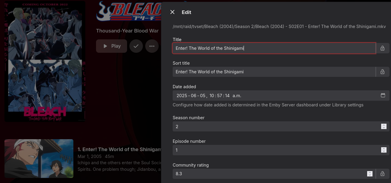

Yes it is. All other seasons are correctly identied except season 2. image.thumb.png.53180fc11c50f029cefe93c2c6cad0ec.png
The image is from season 17 and the metadata of all underlying episodes is also set to season 17 (which is actually season 2 in the rebooted show, it's named season 17 because the show never officially ended).

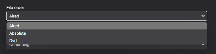

What is the metadata file order set to for that shaow ?
brothom
@Lessaj
Quote
Try editing the metadata for Season 2 and change the TVDB ID to 16472, then refresh metadata and replace images from the season level.
If I change the id -> refresh the metadata the id gets reverted back to the old one.
@Neminem
Quote

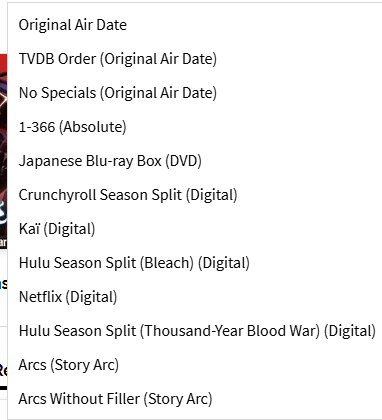

The same as in your screenshot: Aired. According to the aired order the episode should be season 02 episode 01.

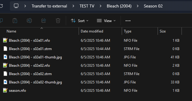

Do you have NFO files in your library ?
brothom
@Neminem
Quote
I'm only using the NFO storage method and I've disabled thel loaders so I have a backup with each file without them interfering with updated meta.
So yes but they're not being read.

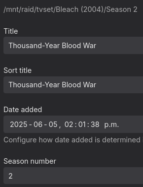

Yea I'm able to replicate it linking season 2 to season 17 with the ID, but it does say Season number is 2 in the metadata, and the episode I added for season 2 episode 1 is correct. I looked at the json in the cache and it correctly shows season 2 with the correct ID, I'm not sure why it would take the ID from season 17. Try changing the ID for the season and then lock the whole season, then you can manually search for images for the season and it will show the season 2 images.
brothom

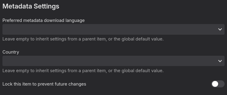

@LessajThat sounds plausible. How would I go about "locking a season"? Is there a checkbox somewhere in the season settings?
Lessaj
Yup, all the way at the bottom.
  • Like 1
brothom
@Lessajlocking the season automatically also locks all the underlying episodes.
It's true this is a way to fix my issue, but as you also said; it's really strange the data for a (completely) different season is associated.
It looks like I'll have to look the entire season and the episodes and manually correct all of them.

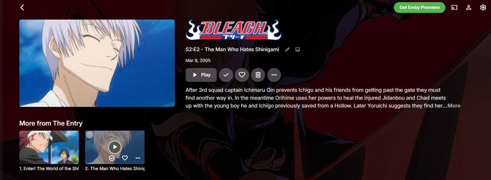

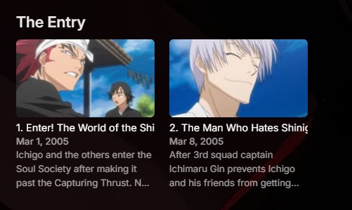

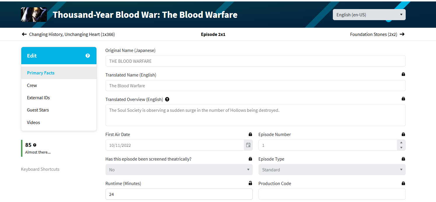

UPDATE

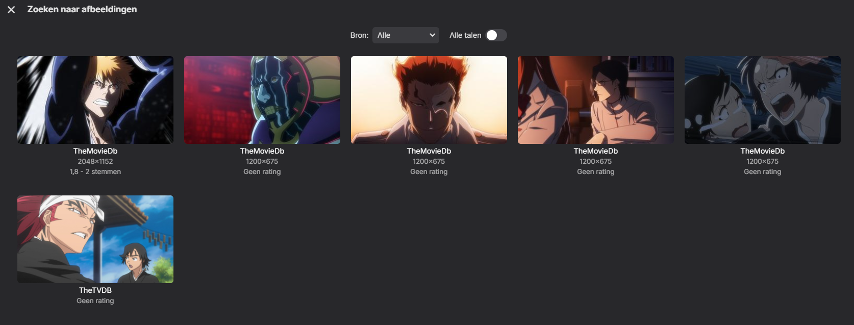

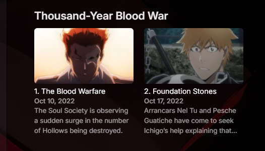

I was just fixing the meta data when I noticed that recommended images are also from both seasons:image.thumb.png.22286c92b516d5b37d0552ed1e2c4d9a.png
The first image is from Season 17. The last image is from Season 2. Something weird is up with the agent data I think.
Edited by brothom

Lessaj
I used this pathing, brand new into my test system because I don't have this show. I created files for episode 1 of both seasons:
/mnt/raid/tvset/Bleach (2004)/Season 1/Bleach (2004) - S01E01 - The Day I Became a Shinigami.mkv
/mnt/raid/tvset/Bleach (2004)/Season 2/Bleach (2004) - S02E01 - Enter! The World of the Shinigami.mkv
I had no NFO files at all, I simply let Emby handle it. Season 2 is incorrectly using the metadata of Season 17 based on the TVDB ID, but it still correctly set the season number to 2. I'm not able to explain this. Additionally, the details for S02E01 are correct.

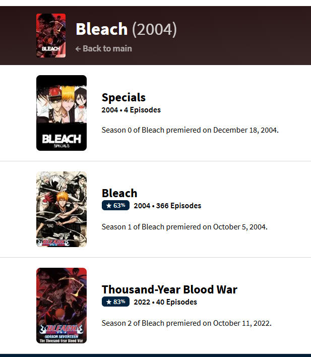

Since TMDB and TVDB are not organized the same by default I can see issues as your primary provider it TMDB but would need to see all library settings as I can not replicate with TVDB as provider.
  • Solution
Happy2Play

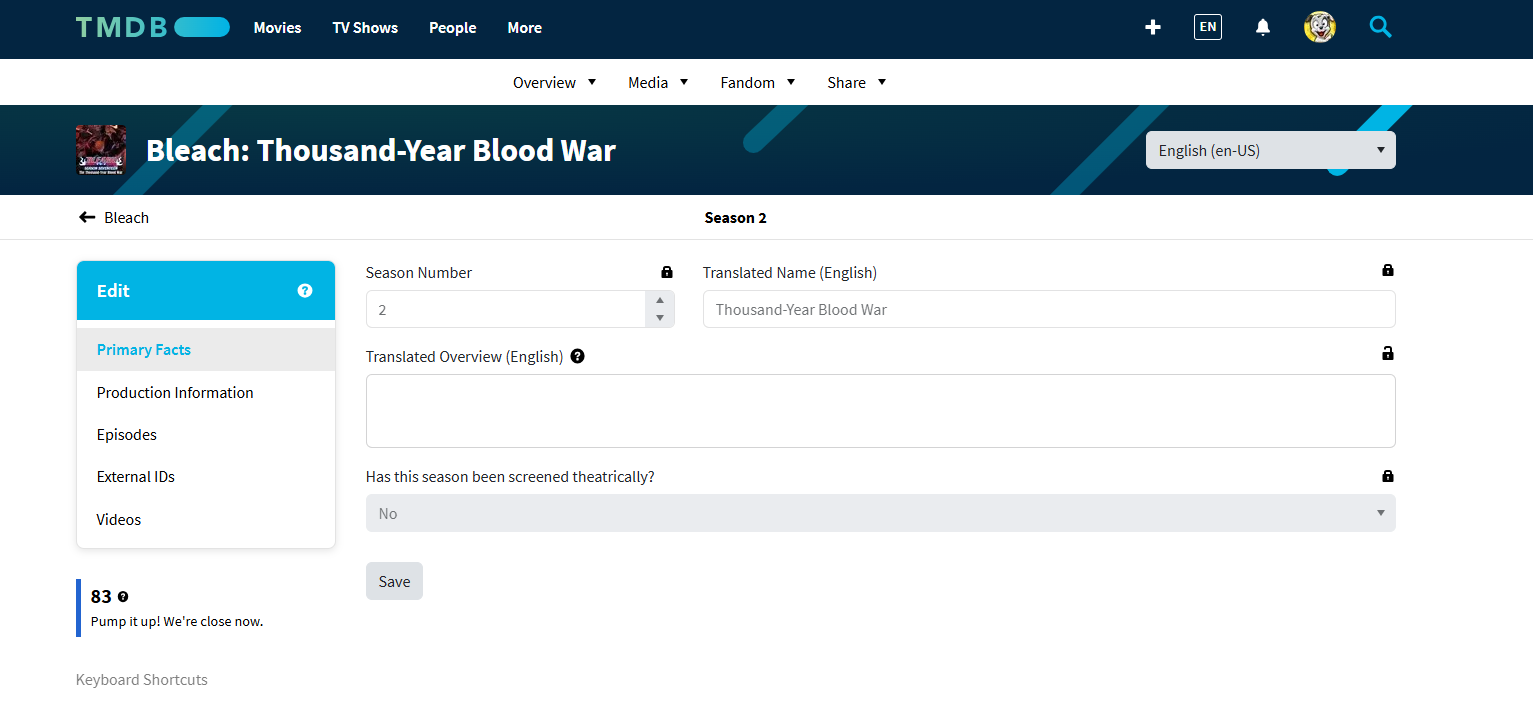

So the issue become the miss-match from TMDB to TVDB.
TMDB only has 2 seasons
Edited by Happy2Play
added images
brothom
Yep. I've just logged back into TheMovieDB and guess what; they're having a hard time convincing the admins there their data is wrong.
For now I've manually set all the season data so that won't be lost anyway.
Maybe it's an idea to note that "lock this item for changes" switch because I've never noticed it before and is very useful in cases like these where the datasource is misleading for only a single season/episode or so.

Happy2Play
In this scenario one can not use both providers.  And @Lukeneeds to implement alternate provider orders to make them match.
or per provider limits per show.
Happy2Play
Added more images above to show miss-match using TMDB here since everything will primarily come from first provider.
