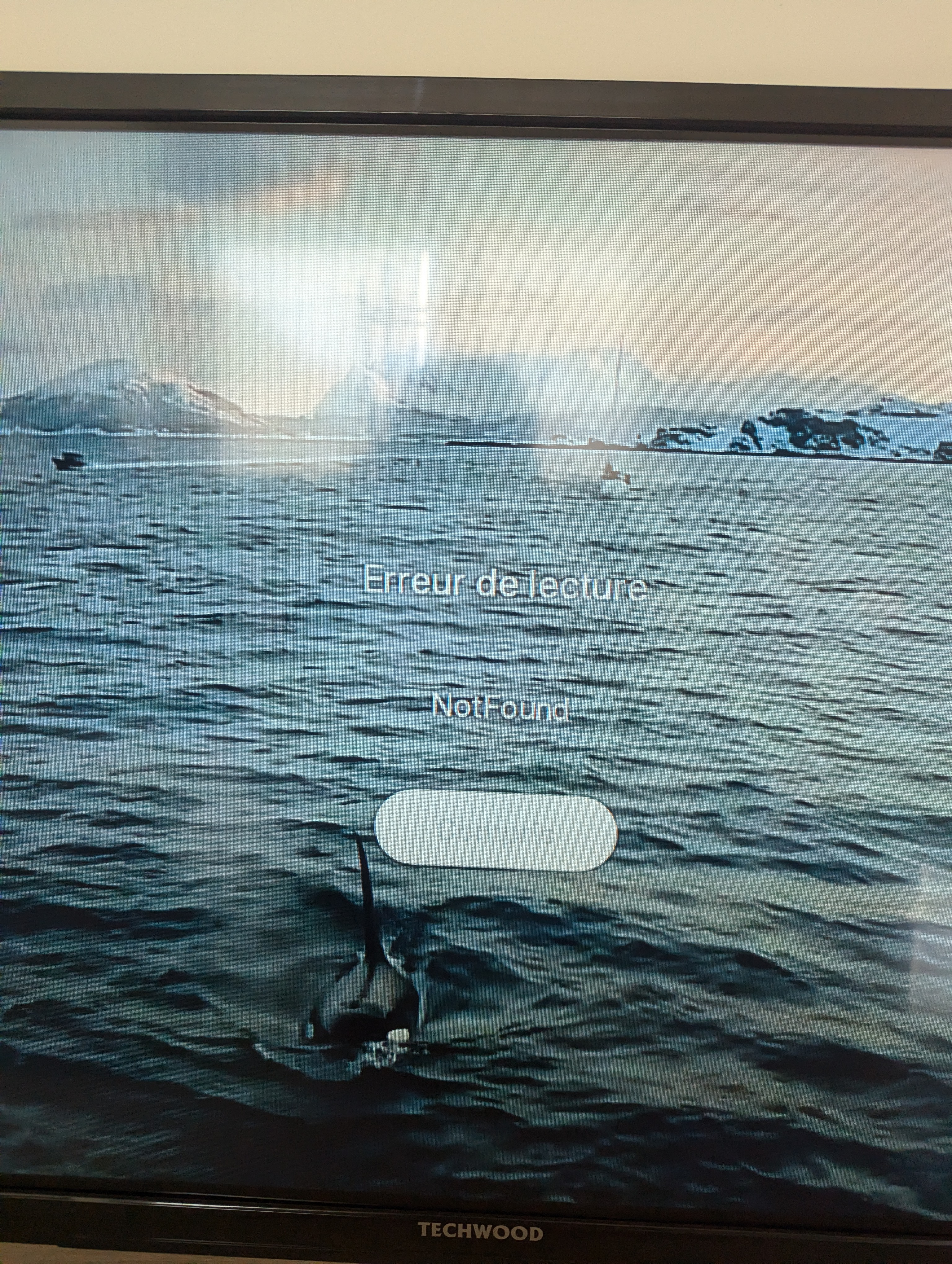

OptiOignon 0 Posted October 6, 2025 Posted October 6, 2025 Great, it works! Thanks! But for me, there's still a small problem. When I start playing a channel for the first time, it works as expected. If I manually stop playing that channel and then start another, still no problems, it works. However, if I put channel #2 without stopping playing channel #1, I get an error message and the channel change doesn't work. I have to press channel #2 again for it to play, but the error message still remains in the foreground. I'm using NextPVR, maybe that's the problem. I'll look at the logs when I have more time.

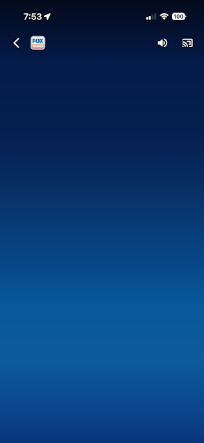

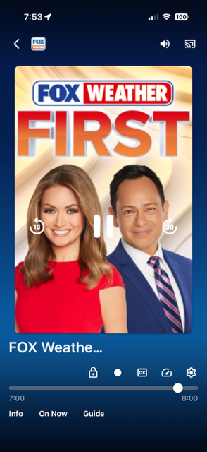

Relish02 2 Posted October 7, 2025 Posted October 7, 2025 20 hours ago, Luke said: Hi, yes please and thanks. It's just minor stuff. After casting starts, I get the usual bar down towards the bottom of the screen: If I tap on that bar for the remote control screen, I get this: If I tap in the middle of the empty area, then the remote control screen appears: I haven't checked out all the controls here yet, but I notice that there is no stop button. The only way to stop is to turn off casting. Perhaps this is intentional, but just thought I would mention it.
madmack 2 Posted October 8, 2025 Posted October 8, 2025 It works indeed. One thing i noticed is that we no longer have a stop button, only pause. It seems the only way I can stop the stream now is by either switching to another channel or disabling casting. 1
Luke 42237 Posted October 8, 2025 Posted October 8, 2025 HI, yes we need to restore the stop button. Thanks. 1

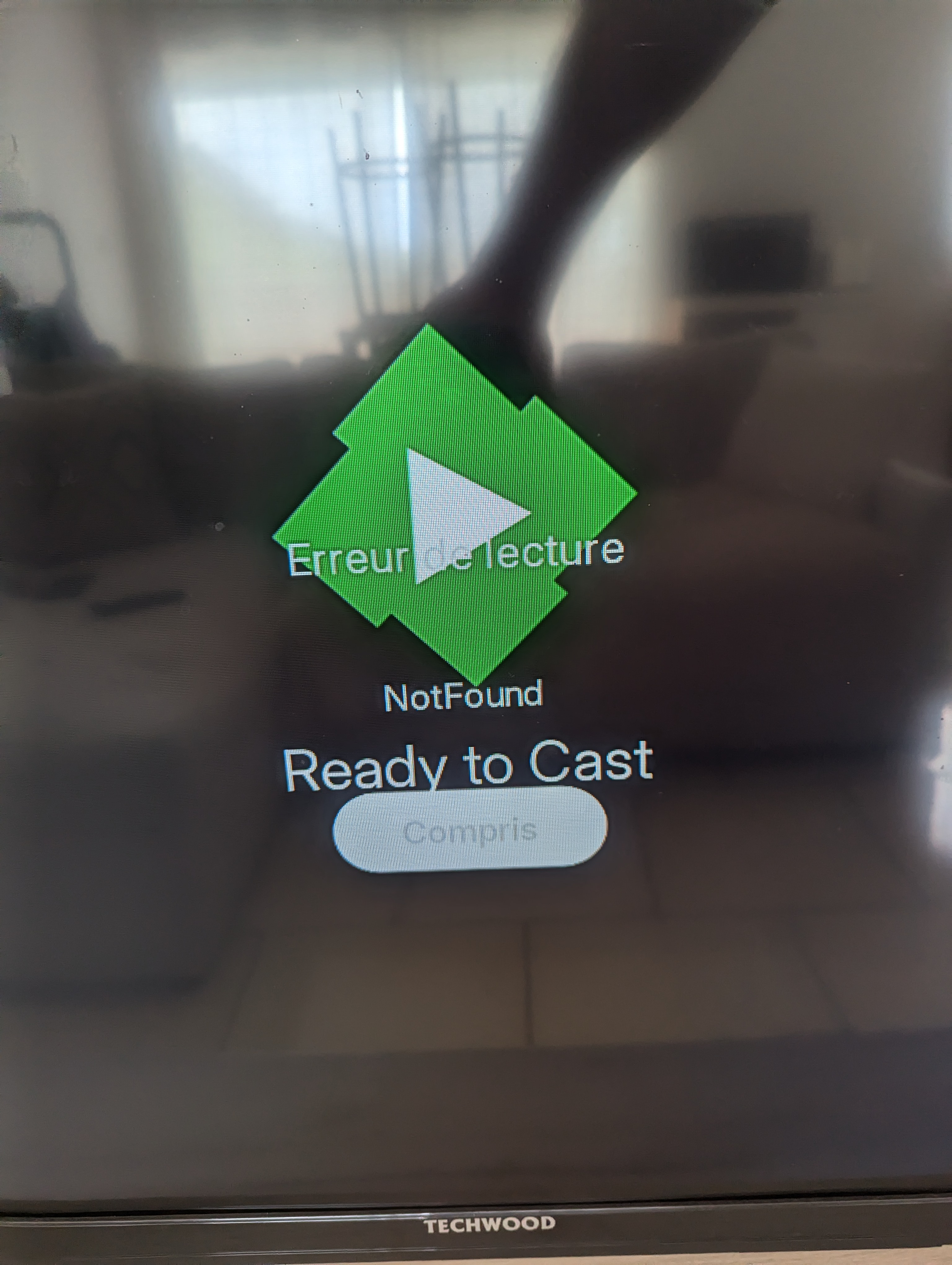

Kcircuit 6 Posted November 3, 2025 Author Posted November 3, 2025 For me the issue has returned, when I cast a live tv channel I just have a spinning wheel on the TV with the words Ready to Cast.
Luke 42237 Posted November 5, 2025 Posted November 5, 2025 On 11/3/2025 at 12:55 AM, Kcircuit said: For me the issue has returned, when I cast a live tv channel I just have a spinning wheel on the TV with the words Ready to Cast. Hi there, let's look at an example. Please attach the information requested in how to report a media playback issue. Thanks!

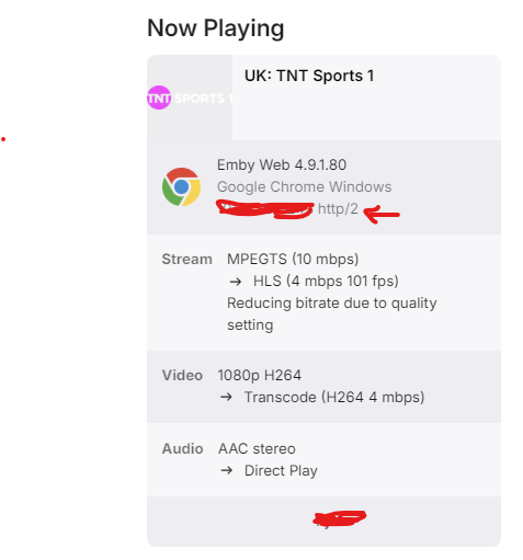

Kcircuit 6 Posted November 9, 2025 Author Posted November 9, 2025 (edited) I did note, when casting locally when it worked, on the dashboard it would say HTTP connection. Then when i played back the same video remotely on a laptop & phone it still said HTTP, even though it should be over https. Monitoring the connection with Wireshark i can see TCP packets being passed to my secure port, does this sound right ? Although it only looks like the packets from the client back to the host are TCP. No expert in this area sorry ! Edited November 9, 2025 by Kcircuit
