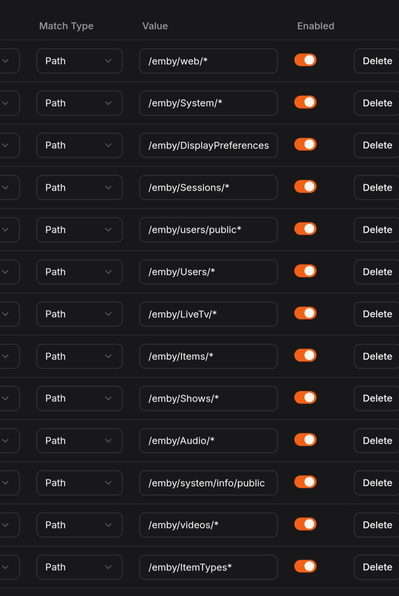

sh0rty 727 Posted August 3, 2025 Posted August 3, 2025 (edited) On 6/5/2025 at 10:20 AM, Re4mstr said: Hi, Thanks for the answer, and I landed on this solution yesterday after some more testing. The issue I have with this, is that in the browser, if I just append /emby to my base url, I bypass the auth. I hoped there were a less "wildcard" approach. Late to the Party. But at least these are the ones I needed to whitelist for having everything in the app functional and having Pangolin 2FA/Passkey login in the Web Browser. Perhaps Luke can elaborate if something is not necessary. Edited August 3, 2025 by sh0rty
Luke 42171 Posted August 4, 2025 Posted August 4, 2025 Yikes, that looks like it's going to be painful. I would just whitelist /emby/*
sh0rty 727 Posted August 4, 2025 Posted August 4, 2025 (edited) 5 hours ago, Luke said: Yikes, that looks like it's going to be painful. I would just whitelist /emby/* When whitelisting /emby/*, also the web login bypasses Pangolin Login page. But it could be easier mate : Edited August 4, 2025 by sh0rty
Re4mstr 5 Posted January 4 Author Posted January 4 On 8/3/2025 at 10:20 PM, sh0rty said: Late to the Party. But at least these are the ones I needed to whitelist for having everything in the app functional and having Pangolin 2FA/Passkey login in the Web Browser. Perhaps Luke can elaborate if something is not necessary. This is great, I am now only missing the top right "user menu" button (profile pic) from the app on mobile... Thanks for this, though, guess I'll look through the API docs to figure out what more needs whitelisted to get the menu up. 1
Solution sh0rty 727 Posted January 4 Solution Posted January 4 (edited) 1 hour ago, Re4mstr said: This is great, I am now only missing the top right "user menu" button (profile pic) from the app on mobile... Thanks for this, though, guess I'll look through the API docs to figure out what more needs whitelisted to get the menu up. Meanwhile things changed on the server it seems. This is working for me now: Edited January 4 by sh0rty 1

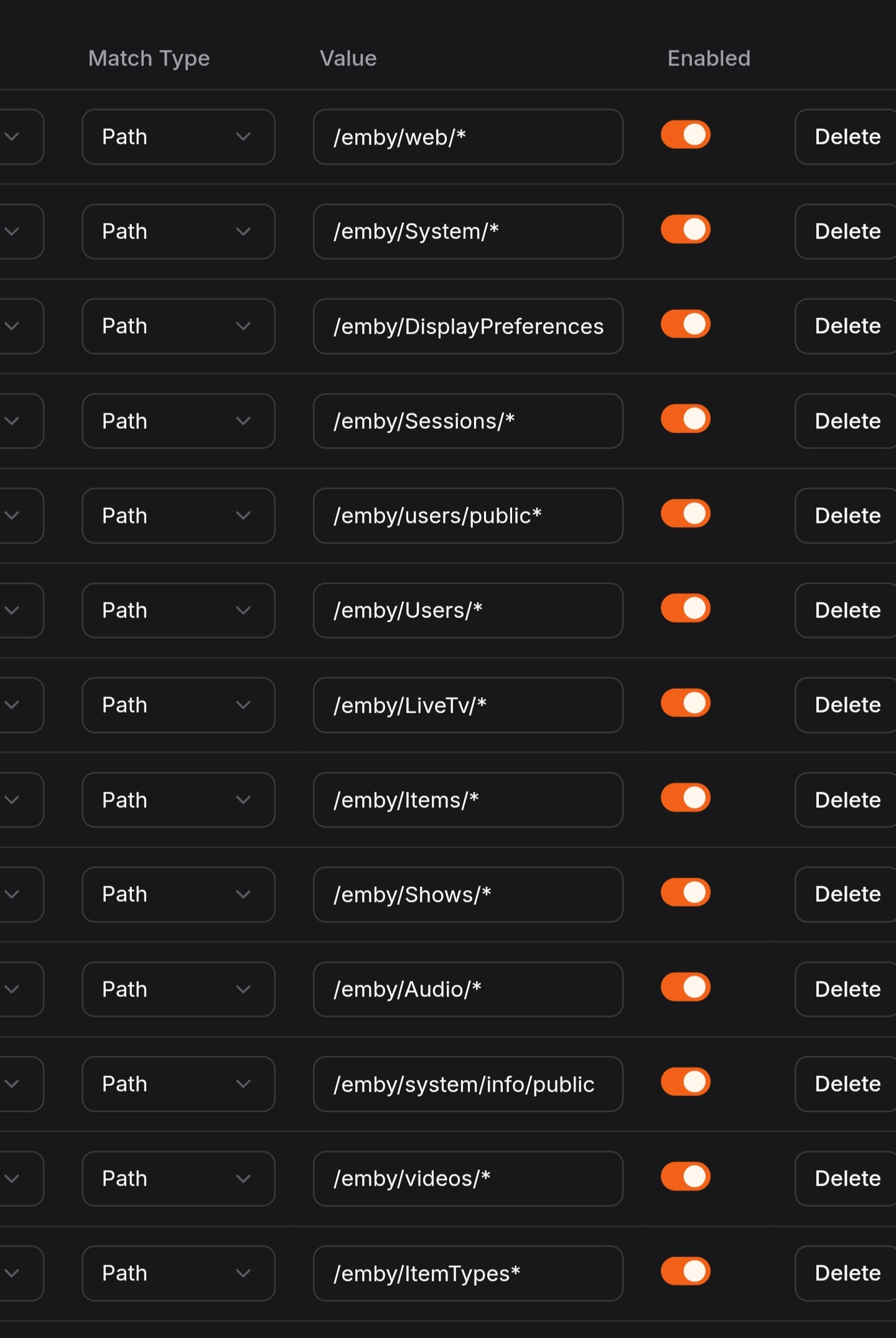

sh0rty 727 Posted January 14 Posted January 14 These are the current rulesets needed for path based auth bypass. Feel free leave a reaction in the linked thread two posts above, if you also feel the need of header auth to finally ditch the following path exclusions. 1
