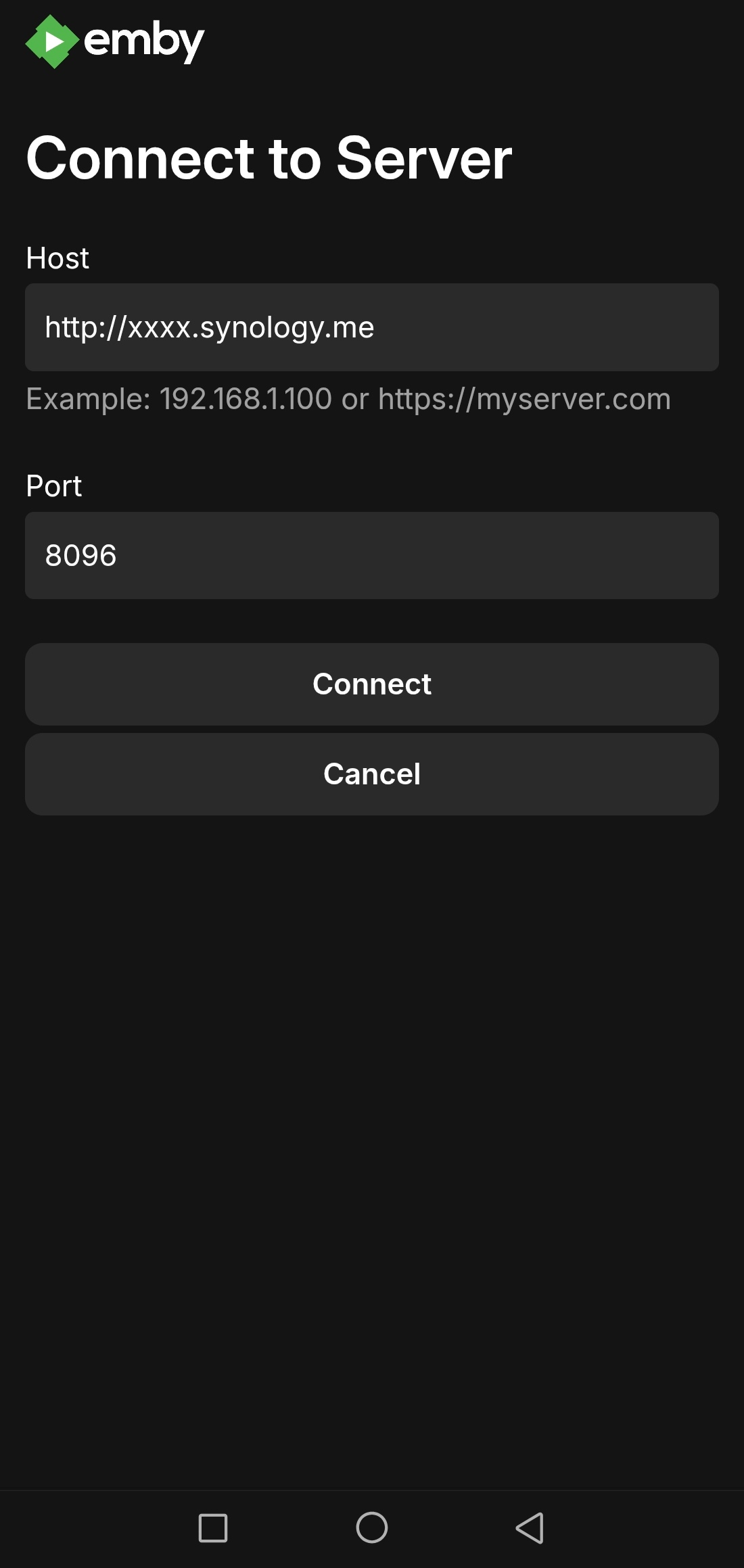

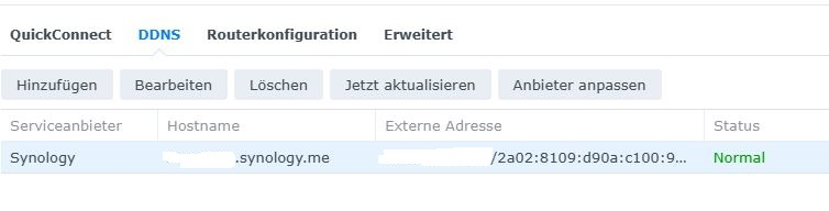

Morphium 5 Posted June 3, 2025 Author Posted June 3, 2025 18 minutes ago, GrimReaper said: As a test, if you try to establish connection manually from your Android app, with http://xxxx.synology.me and port 8096, does it also fail? Yes, I tried that multiple times. I looked at the DDNS address by synology again and it sets up IPV4 and IPV6 whereas other providers do only seem to set up IPV4? I understand DDNS correctly as a forwarding to an ever changing IP adress, right? So maybe it works on my browser at home because he does not forward to the IPV4 address but to the IPV6 address, which might be static? Why it only works in this browser and not over mobile internet, though, i can't imagine. So, shall I still change my internet package? I can try that tomorrow.

Solution Q-Droid 1011 Posted June 3, 2025 Solution Posted June 3, 2025 (edited) I can only wonder if the connections that are working with DNS/DDNS are resolving to an IPv6 address. The ISP shouldn't have limits or restrictions with IPv6 like they do with IPv4. Edit to add: You should check if this is the case and if you have IPv6 disabled on some devices. Edited June 3, 2025 by Q-Droid 1

Morphium 5 Posted June 3, 2025 Author Posted June 3, 2025 1 minute ago, Q-Droid said: I can only wonder if the connections that are working with DNS/DDNS are resolving to an IPv6 address. The ISP shouldn't have limits or restrictions with IPv6 like they don with IPv4. I can only say that the IPV6 address is listed in the DDNS. So, yeah, if it's a problem with a missing static IPV4 adress, shouldn't it work over the IPV6 address?
