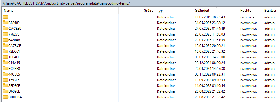

SamES 1084 Posted June 9, 2025 Posted June 9, 2025 Can you check that this folder exists and is writeable by the emby process? /share/CACHEDEV1_DATA/.qpkg/EmbyServer/programdata/transcoding-temp/
RRo100 10 Posted June 10, 2025 Author Posted June 10, 2025 Hello, Yes, the directory exists and the permissions seem to be OK.

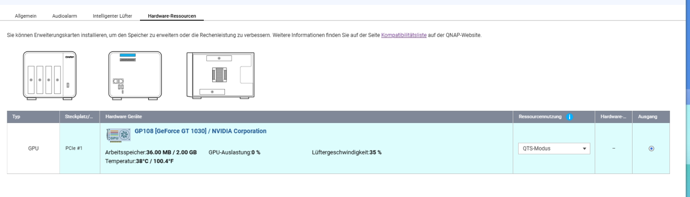

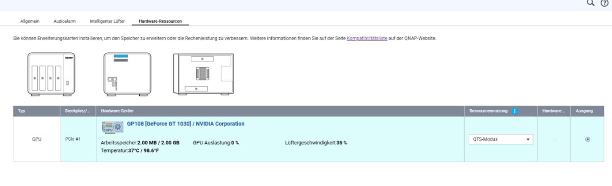

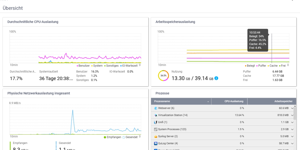

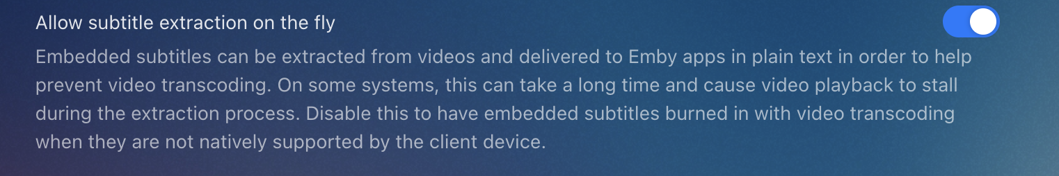

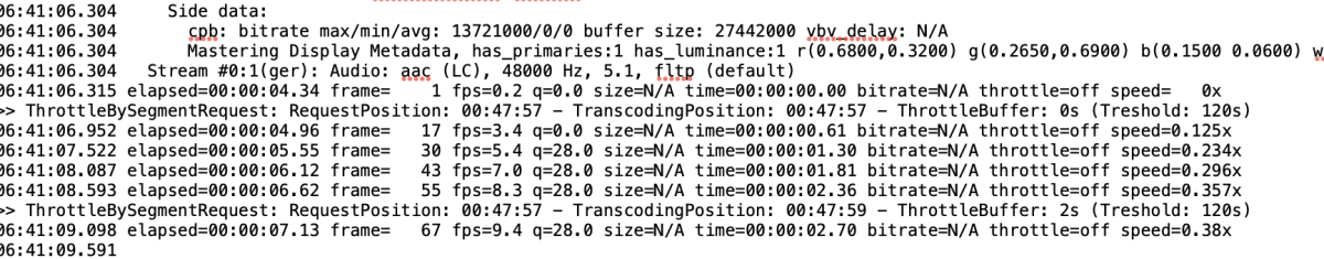

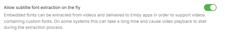

SamES 1084 Posted June 10, 2025 Posted June 10, 2025 Looks like transcoding is too slow, if the transcoding speed less than 1x speed then it's slower than the normal playback speed and will fail. I don't think it will help, but you can try turning of Hardware Acceleration, just in case it is causing a problem. Can you please check this setting as well? If it is off, please try turning it on (and select save at the bottom of the page)
RRo100 10 Posted June 14, 2025 Author Posted June 14, 2025 Where do I set this setting? I can't find it. What's too slow, the LG TV?
Luke 42233 Posted June 14, 2025 Posted June 14, 2025 4 hours ago, RRo100 said: Where do I set this setting? I can't find it. What's too slow, the LG TV? That's in the server transcoding settings.
RRo100 10 Posted June 17, 2025 Author Posted June 17, 2025 The "extraction on the fly" setting was already enabled. What I don't understand is that everything works fine on all other devices. It also works on the LG TV with PLEX, so it must have something to do with the Emby-LG app. I had the same problem with my previous LG TV, and I suspected that the connection wasn't strong enough, but the new TV behaves the same way.

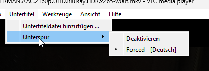

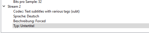

RRo100 10 Posted November 23, 2025 Author Posted November 23, 2025 Hi Luke, the subtitles are forced. They are displayed in places, but the movie stops playing when you fast-forward. Could it be that the development for LG TVs is only tested with an emulator? If you own an LG TV, you could try playing a movie or series with forced subtitles. My Fire TV Stick has no problem with it. How do I find the subtitle format?
Luke 42233 Posted November 24, 2025 Posted November 24, 2025 But I think what this still comes down to is that you're not getting fast enough transcoding, right? 1
