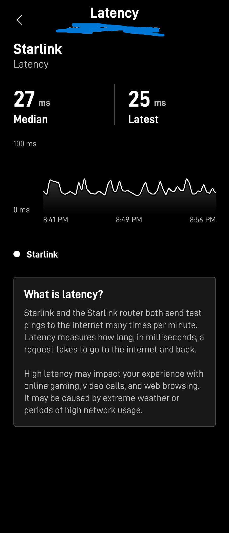

zac115 7 Posted June 2, 2025 Author Posted June 2, 2025 1 hour ago, Gilgamesh_48 said: I do not know exactly how Starlink works but being satellite based probably means that is has rather large lag times and that, I think, would be problematic for streaming at best. I know other satellite based internet connections do not work at all well for streaming. starlink has been working just fine for me. i can even play online game with it. like a 40ms latency. not too bad for sat. here is the latest latency test that the sat ran its self.

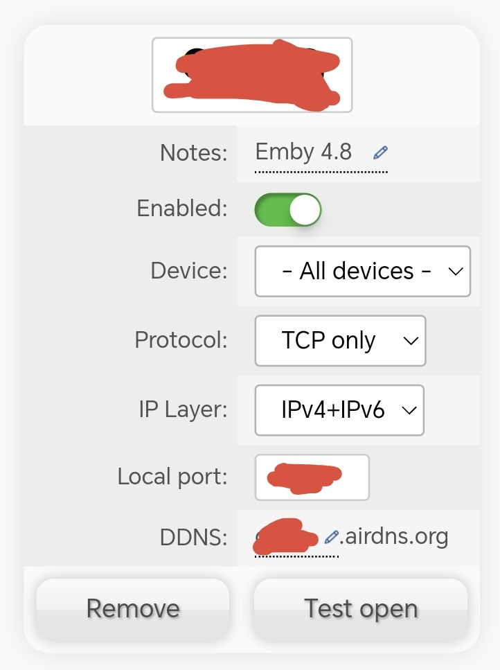

GrimReaper 4928 Posted June 2, 2025 Posted June 2, 2025 (edited) 8 minutes ago, zac115 said: if you have more info then me in terms of what service has static ports i would really like to know as i could not find that info. Try this one (there's a three-day subscription), make sure the port you select is on Pool 1, there are usually several open there always. Edited June 2, 2025 by GrimReaper Screenshots
