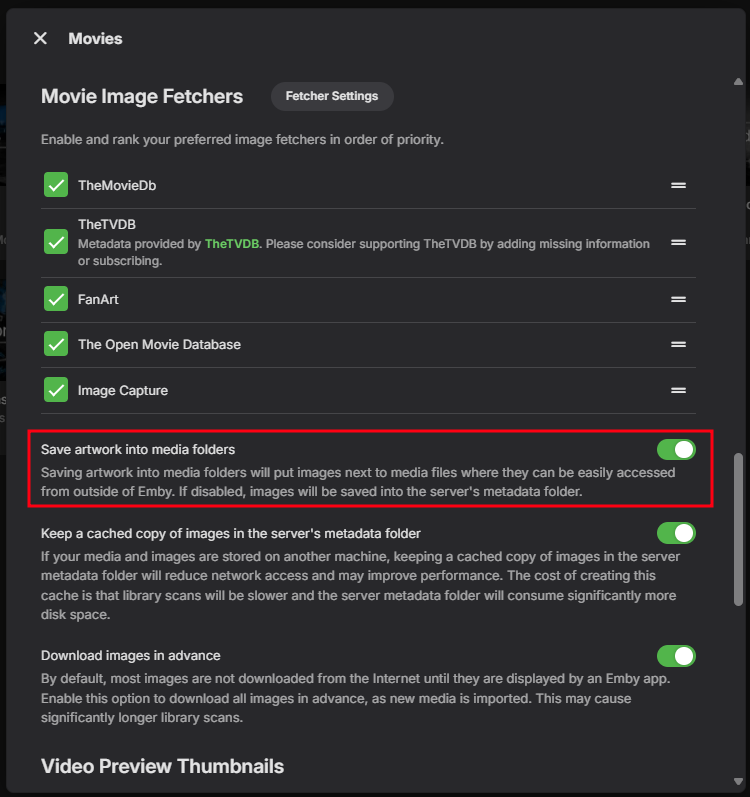

snape15 0 Posted June 1, 2025 Posted June 1, 2025 I have recently switched to a proxmox system with a Debian media file server and a Emby LXC. I have all the media folders shared via Samba. I have added the smb folders to Emby and it finds all the media and plays the media but wont save metadata/artwork to the media folder. So checked all the permissions and everything was set as needed. I then mounted the smb share to the LXC and tried again but still getting the same issue. I then logged into the LXC console amd navigate to the folders and I was able to create files/folders within the media folders. Any suggestions on why I am having this issue?
snape15 0 Posted June 1, 2025 Author Posted June 1, 2025 1 minute ago, Neminem said: Have you checked library settings ? Yes, sorry didnt state that
