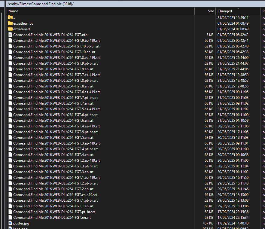

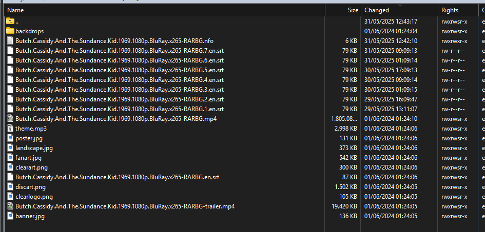

cyberrep 7 Posted May 31, 2025 Posted May 31, 2025 Hey guys, I have a issue with some movies, emby create a kind of a loop to download infinite subtitles I deleted yesterday 400 subitles just for one movie.
