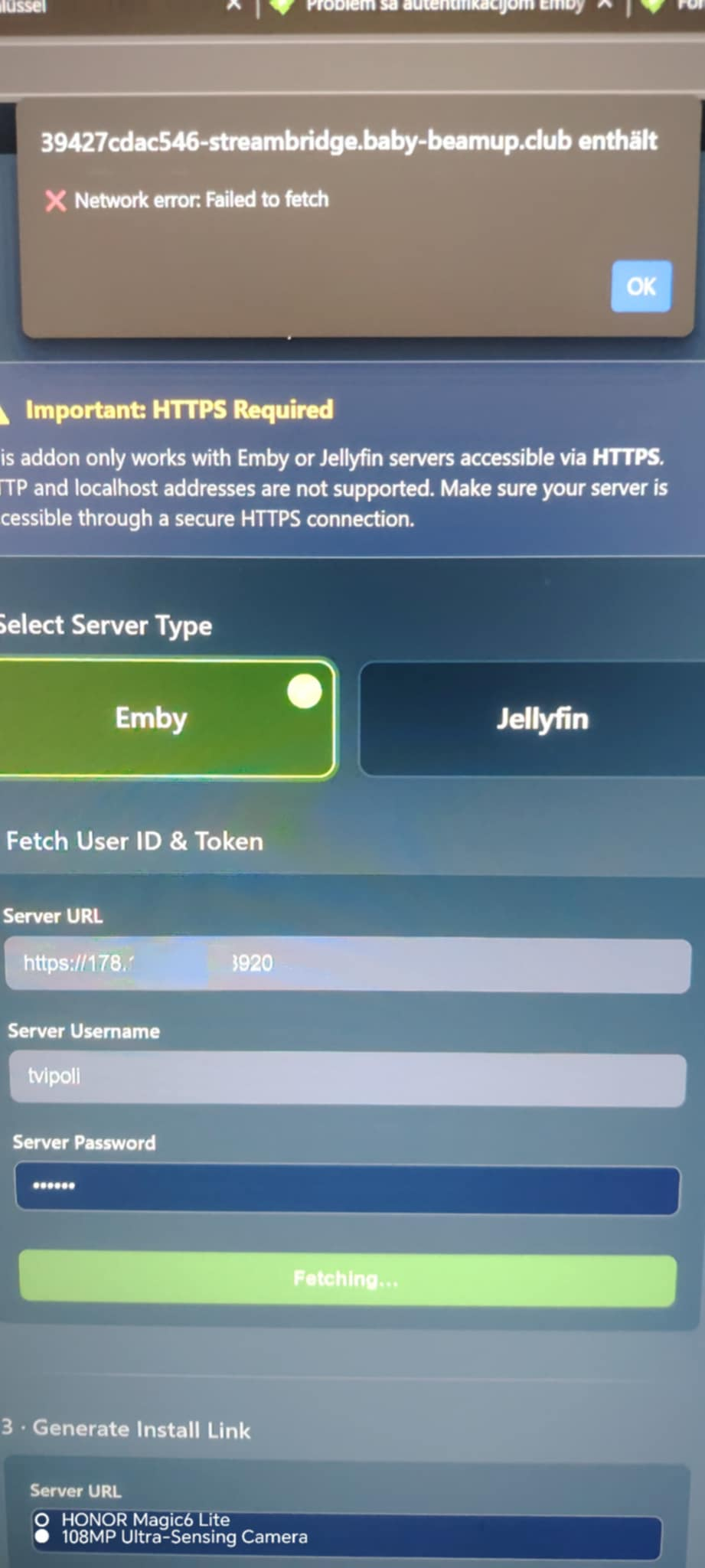

tvipoli 0 Posted December 9, 2025 Posted December 9, 2025 2 minutes ago, Luke said: OK so what do you need help with exactly? When I add those ip adressees to Stremio,I can`t connect Emby to Stremio at all.
Luke 42233 Posted December 9, 2025 Posted December 9, 2025 3 minutes ago, tvipoli said: When I add those ip adressees to Stremio,I can`t connect Emby to Stremio at all. Well what exactly happens? Does Stremio have any troubleshooting/logs ?
Hars084 3 Posted December 9, 2025 Author Posted December 9, 2025 (edited) 15 minutes ago, tvipoli said: When I add those ip adressees to Stremio,I can`t connect Emby to Stremio at all. Provide in detail what steps you are taking to connect to stremio? Are you using username and password not emby connect? What error are u facing? Edited December 9, 2025 by Hars084
