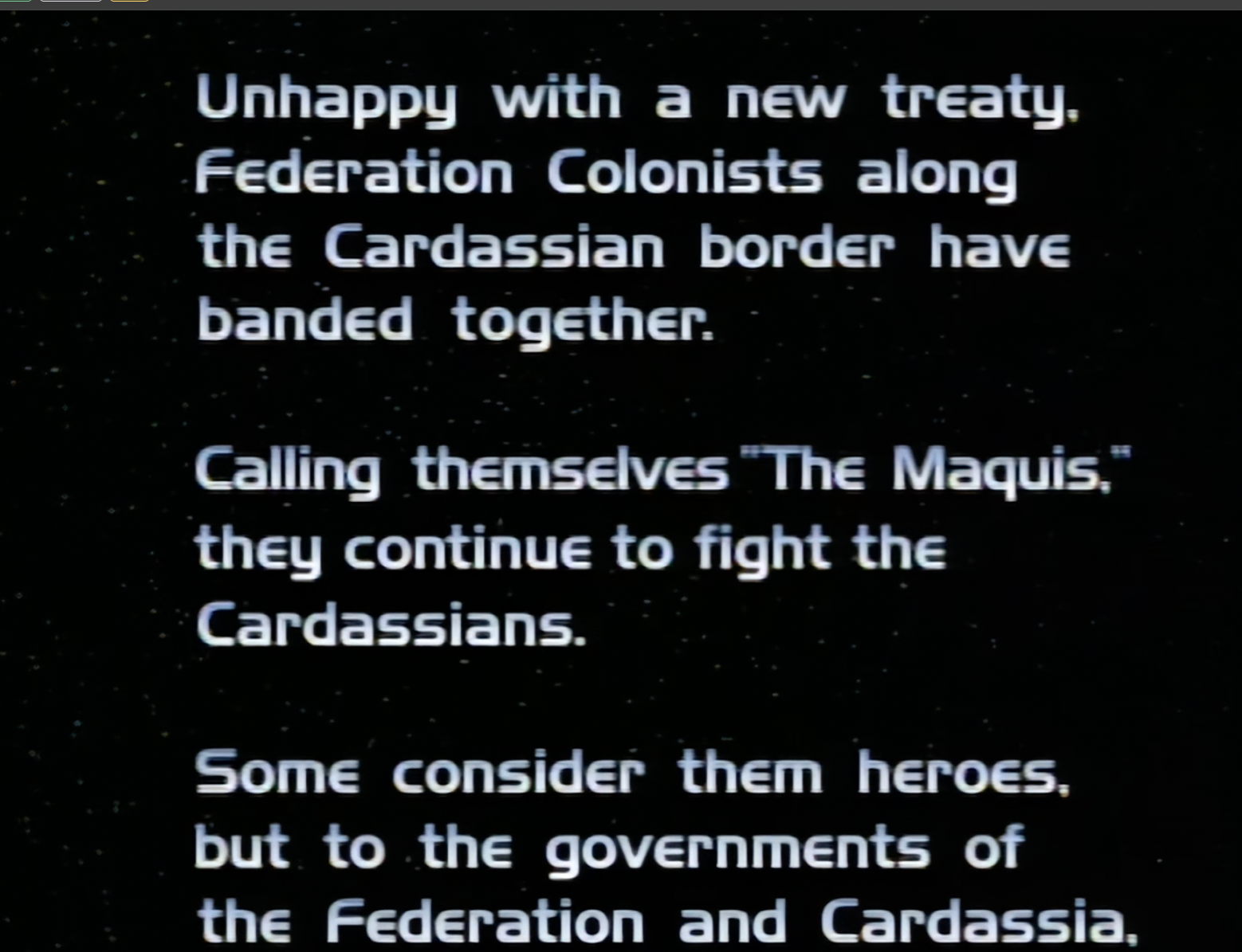

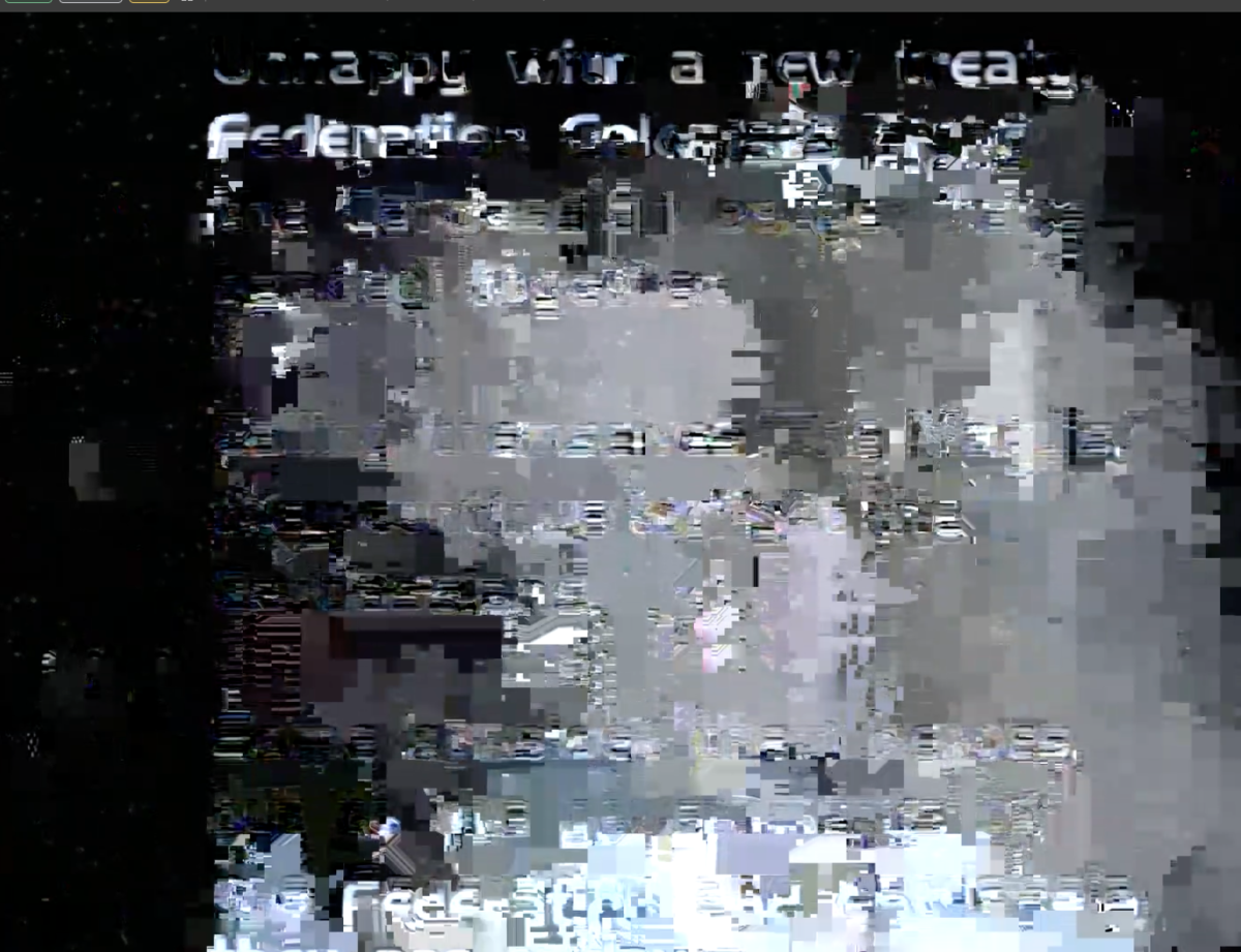

blakeusblade 4 Posted May 30, 2025 Posted May 30, 2025 I should prefix this with my goal of wanting to shift my emby server off a dedicated Windows machine into docker. I've been switching out SSDs one containing my original Windows installation and Emby installation with a SSD containing Linux and a docker container running emby/embyserver:latest (both Emby Windows and docker image is of writing this is v4.8.11.0). I should also say that its only happening with one of my TV series while nearly all other TV series encoding with H265 10bit (HVEC) work fine with the hardware acceleration in the docker container. My hardware is Intel i5-10500T (supports HEVC Main10 decoding) Host and container confirm support via vainfo /dev/dri devices are passed correctly After an exhaustive amount of troubleshooting with chatGPT it concluded that the Emby container does not fully support VAAPI HEVC 10-bit HW decoding with iHD driver despite system capability. The inbuilt ffmpeg version supplied with emby/docker container 4.8.11.0 isn't compatabile or is missing certain libraries and reverts to terrible software transcoding ending up with pixelated image. (See attached screenshot) Whereas the Windows counterpart works fine playing the same file. (See screenshot below) ChatGPT told me to install and run vainfo on the host and within the container to prove that its all supported. Both the host and container return the below. libva info: VA-API version 1.20.0 ibva info: Trying to open /usr/lib/x86_64-linux-gnu/dri/iHD_drv_video.so ibva info: Found init function __vaDriverInit_1_20 libva info: va_openDriver() returns 0 vainfo:VA-API version: 1.20 (libva 2.12.0) vainfo: Driver version: Intel iHD driver for Intel(R) Gen Graphics - 24.1.0 () vainfo: Supported profile and entrypoints VAProfileMPEG2Simple : VAEntrypointVLD VAProfileMPEG2Main : VAEntrypointVLD VAProfileH264Main : VAEntrypointVLD VAProfileH264Main : VAEntrypointEncSliceLP VAProfileH264High : VAEntrypointVLD VAProfileH264High : VAEntrypointEncSliceLP VAProfileJPEGBaseline : VAEntrypointVLD VAProfileJPEGBaseline : VAEntrypointEncPicture VAProfileH264ConstrainedBaseline: VAEntrypointVLD VAProfileH264ConstrainedBaseline: VAEntrypointEncSliceLP VAProfileVP8Version0_3 : VAEntrypointVLD VAProfileHEVCMain : VAEntrypointVLD VAProfileHEVCMain10 : VAEntrypointVLD VAProfileVP9Profile0 : VAEntrypointVLD VAProfileVP9Profile2 : VAEntrypointVLD ChatGPT told me to run /app/emby/bin/ffmpeg -hwaccel vaapi -hwaccel_device /dev/dri/renderD128 -i test.mkv -f null - and/or /app/emby/bin/ffmpeg -hwaccel vaapi -hwaccel_device /dev/dri/card0 -i your_hevc10bit.mkv -f null - and failed for both with ffmpeg: error while loading shared libraries: libavdevice.so.59: cannot open shared object file: No such file or directory After fixing this issue by installing a full copy of ffmpeg using the below apt update apt install -y software-properties-common add-apt-repository ppa:savoury1/ffmpeg5 apt update apt install -y ffmpeg and rerun /usr/bin/ffmpeg -hwaccel vaapi -hwaccel_device /dev/dri/renderD128 -i test.mkv -f null - and/or /usr/bin/ffmpeg -hwaccel vaapi -hwaccel_device /dev/dri/card0 -i your_hevc10bit.mkv -f null - both worked. ChatGPT suggested symlinking to see if it fixed the issue however all content became unplayable with the error below so I removed the symlink and put it back the original file. "No compatible streams are currently available. Please try again later or contact your system administrator for details." mv /app/emby/bin/ffmpeg /app/emby/bin/ffmpeg.backup /app/emby/bin/ffmpeg => /usr/bin/ffmpeg Attached are my clean log files from the the docker container. hardware_detection-63884159906.txtembyserver.txtffmpeg-remux-94fc0f56-edc1-4720-be0d-b5273907fcbf_1.txtffmpeg-transcode-7324b96d-838c-4d71-abc2-def9280d22ea_1.txtembyserver-63884160000.txt 1
Luke 42243 Posted June 16, 2025 Posted June 16, 2025 Hi @blakeusbladewe're going to have an updated ffmpeg build on the server beta channel in the near future, just FYI.
