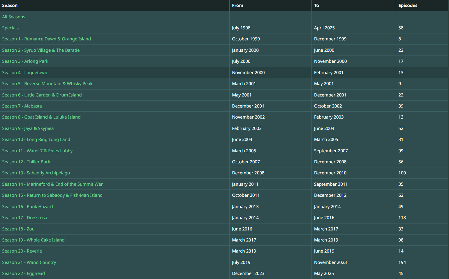

zac115 5 Posted June 1, 2025 Author Posted June 1, 2025 this is what im wanting. but like i said once swapping to the aired order is puts all the eps in the season 1 section.

tedfroop21 89 Posted June 2, 2025 Posted June 2, 2025 (edited) The real trick is to go through the options for ordering for the show on the TVDB. There are usually at least 3, Aired, DVD, and Absolute. Sometimes there are more options. If you find the order your files are in, you should be able to set emby to the same order ( Aired, DVD, or Absolute) and then magic happens and your meta is correct. You have two options from there if it does not match, reorder your episodes to match thetvdb OR join and log into theTVDB and create a ticket. At the least you can explain the order your files are in and why. Sometimes they collect meta from sources that do not have correct data and they will order them correctly if they are not. They may create a sort order for you, or change a sort order to correct it so it matches how the show was presented on air, dvd, or whatever. I do feel your pain. I am a huge Looney Tunes fan and people were buying a dvd and then messing with thetvdb and themoviedb data to match their one of the thousands of releases to dvd. It got so bad themoviedb dropped the entire series from their site. Thetvdb saw the light at last and locked the series permanently. It meant naming everything by release date which was a bit of a pain but at least there is good correct meta now. Edited June 2, 2025 by tedfroop21
zac115 5 Posted June 2, 2025 Author Posted June 2, 2025 1 hour ago, tedfroop21 said: The real trick is to go through the options for ordering for the show on the TVDB. There are usually at least 3, Aired, DVD, and Absolute. Sometimes there are more options. If you find the order your files are in, you should be able to set emby to the same order ( Aired, DVD, or Absolute) and then magic happens and your meta is correct. You have two options from there if it does not match, reorder your episodes to match thetvdb OR join and log into theTVDB and create a ticket. At the least you can explain the order your files are in and why. Sometimes they collect meta from sources that do not have correct data and they will order them correctly if they are not. They may create a sort order for you, or change a sort order to correct it so it matches how the show was presented on air, dvd, or whatever. I do feel your pain. I am a huge Looney Tunes fan and people were buying a dvd and then messing with thetvdb and themoviedb data to match their one of the thousands of releases to dvd. It got so bad themoviedb dropped the entire series from their site. Thetvdb saw the light at last and locked the series permanently. It meant naming everything by release date which was a bit of a pain but at least there is good correct meta now. ya this is what i may have to do. sucks tho. really wish i could turn off metadata for select shows so that i can just do it my self and save the headache.
