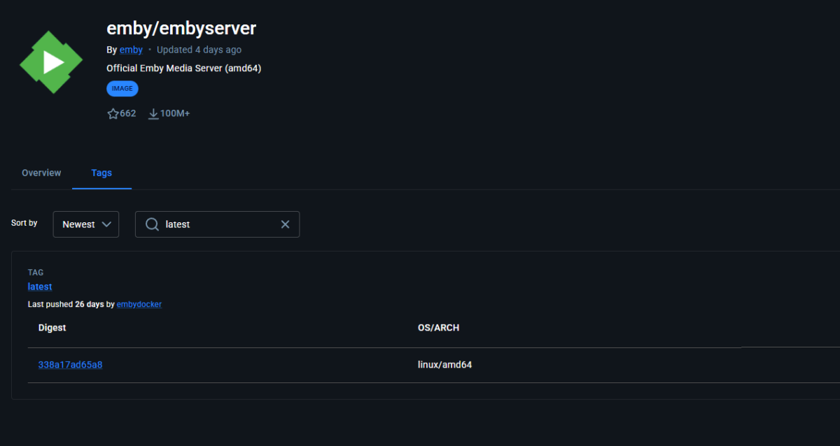

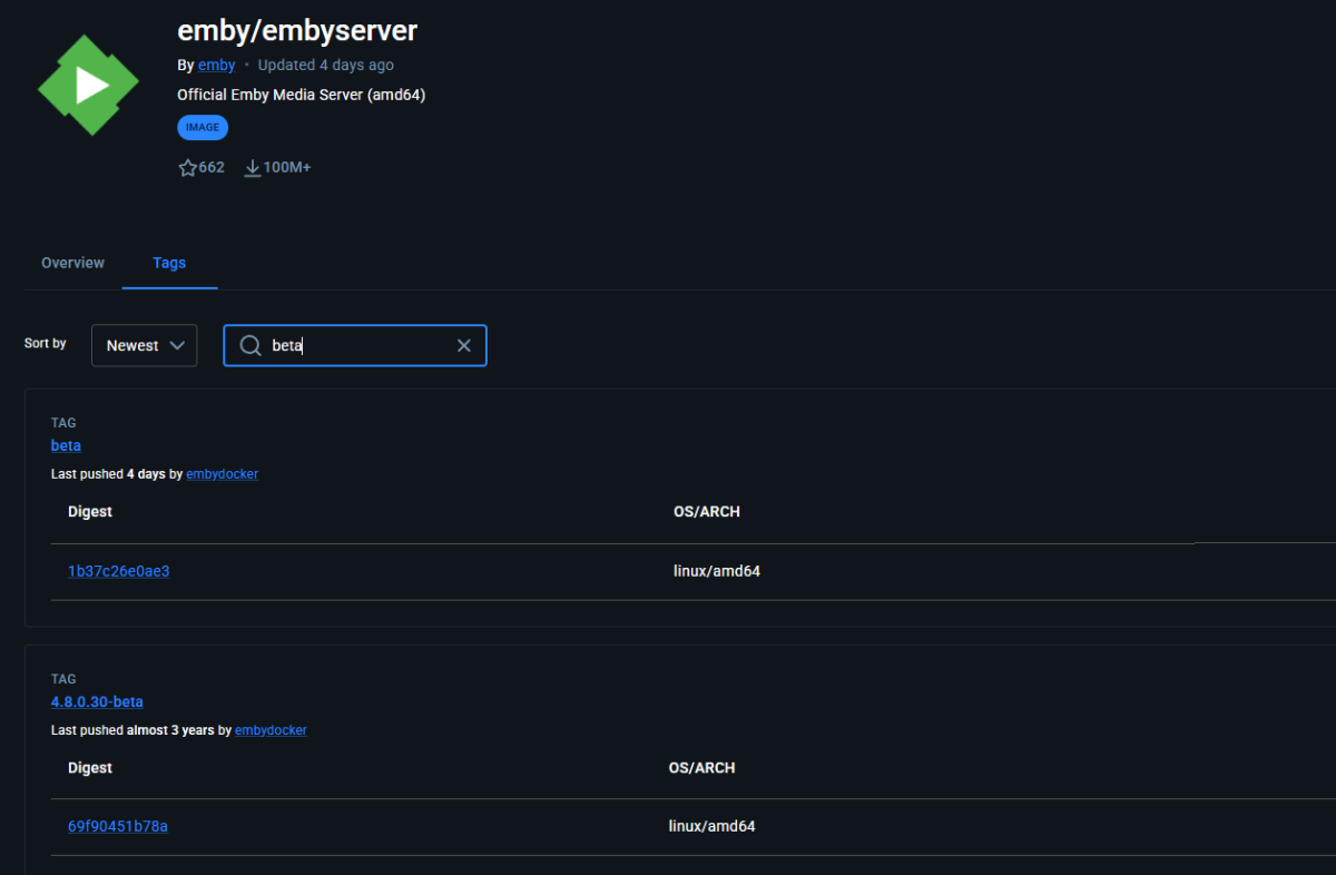

dgrigo 35 Posted November 4, 2025 Posted November 4, 2025 And thats the last I have, so I pass and use beta builds as no solution to be in sight! dinogrigo on Oct 3 Please Check https://hub.docker.com/r/emby/embyserver/tags and we are stuck in beta and not latest https://avatars.githubusercontent.com/u/77424745?u=88a3e836c3b9c7fecfa345fe515e24994a64924f&v=4&size=80 Ryanrrt commented 2 weeks ago Ryanrrt 2 weeks ago See this https://forums.truenas.com/t/emby-update-to-beta-4-9-1-0/44498 Until emby has a standard format to differentiate beta and stable, we cant do much Administrator from emby suggest you to send a curl to the github api to get info on the release. https://emby.media/community/index.php?/topic/139201-emby-4910-beta-in-truenas-community-edition-2504/page/2/#findComment-1480679 https://avatars.githubusercontent.com/u/47820033?u=8f4d2cb92a6b1a43db1c330c3207be49275f8dac&v=4&size=80 stavros-k commented yesterday stavros-k yesterday Contributor We use renovate to pull updates, and it does not have such feature for docker sources.

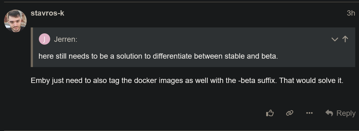

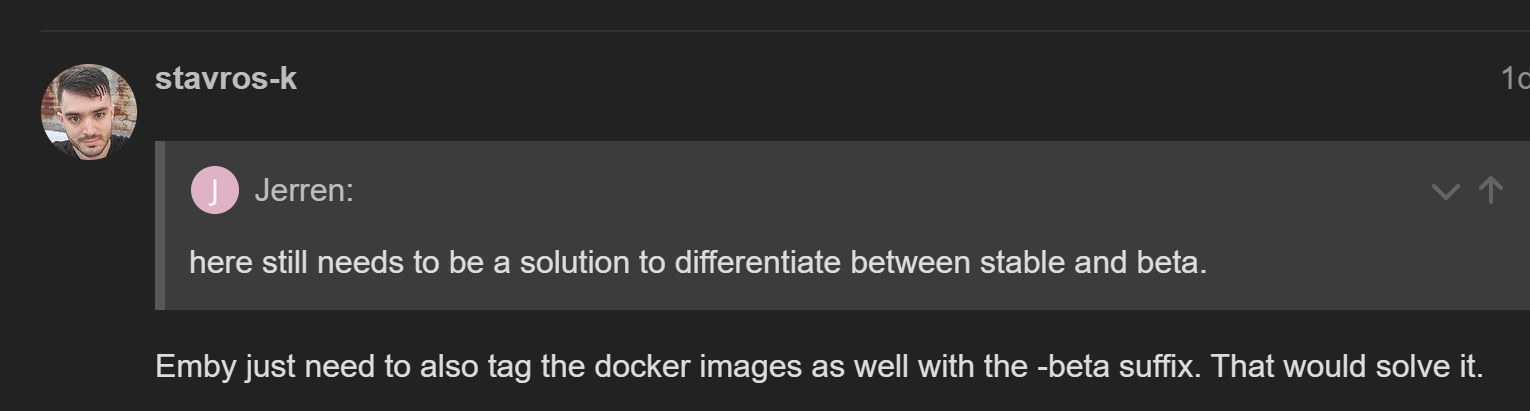

Jerren 18 Posted February 4 Posted February 4 Got a reaction from one of the maintainers @Luke. Seems tagging the docker images with -beta suffix would solve these problems, don't know how that works but i'll post the screenshot from one of the maintainers just in case something is lost in translation.

Jerren 18 Posted February 13 Posted February 13 @LukeSorry to bother you about this again but figured if you don't ask you don't know so here goes. Is there any plan to change the naming for docker releases to include that suffix? One of the Truenas people gave an example over there It seems like if this were to happen then any future problems would be avoided with accidental betastates in docker?
Luke 42242 Posted February 13 Posted February 13 3 hours ago, Jerren said: @LukeSorry to bother you about this again but figured if you don't ask you don't know so here goes. Is there any plan to change the naming for docker releases to include that suffix? One of the Truenas people gave an example over there It seems like if this were to happen then any future problems would be avoided with accidental betastates in docker? We need to assess what the impact would be to existing docker users. And if there’s going to be impact then we need to figure out how to move users over from the old way to the new. previously they had said they need version numbers ending in .0. We gave them that with 4.9.3.0 and will again soon with 4.9.5.0. I think for an immediate fix they should adopt that.
Jerren 18 Posted February 14 Posted February 14 (edited) 13 hours ago, Luke said: We need to assess what the impact would be to existing docker users. And if there’s going to be impact then we need to figure out how to move users over from the old way to the new. previously they had said they need version numbers ending in .0. We gave them that with 4.9.3.0 and will again soon with 4.9.5.0. I think for an immediate fix they should adopt that. Apparently the "standard way" of showing something is a beta is by doing it like that some (one was one of the Truenas staff) have said over there. After you said you weren't aware of such a naming scheme (with the version number ending in 0) I told them that over there so i don't know if they still adhere to do it like that. I did tell them it would be like that for 4.9.5.0 but also that i had no idea if the naming scheme would stay like that. I mean this is kinda what happens when people have to play telephone between 2 places and not knowing the thoughts behind answers given. I'll tell em what you said here and see what the response is over there. EDIT: Before me and others noted seeing a release being tagged as beta on the Truenas forum and we asked if that was good enough which yielded this response. Don't know if it's usefull but want to make sure as much information as possible gets across. If you wish to talk to them directly then this is the forumpost over there https://forums.truenas.com/t/emby-stable-train-is-back-in-beta/55522/38 Edited February 14 by Jerren
