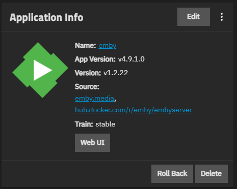

Dariusz 25 Posted May 28, 2025 Author Posted May 28, 2025 3 hours ago, Luke said: Hi, we don't manage that ourselves, so whoever handles that community package must have done that. It could have been intentional or a mistake based on the version number. @Lukeso i looked at the Application info and they have it listed as 4.9.1.0 on their Stable train, not Beta.. guess they made a mistake..

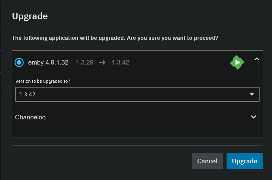

Jerren 18 Posted October 15, 2025 Posted October 15, 2025 I'm not sure, when selecting upgrade i don't see that number. Figured a screenshot would be best. That version is the only option i have. The reason i asked besides being curious how it will move forward is that i've at times noticed odd behaviour like a movie or show not playing smoothly but stuttering untill i reboot the app. But it won't do it consistently. Only consistent error i've got in this beta is a CD that used to play fine but since i'm on the beta says playback error - no compatible streams are currently available. Please try again later or contact your system administrator for details. I assume this is because of the beta version hence why i didn't make a topic for it, nor do i think it warrants any attention right now, just wanted to clarify why i'm not a fan of suddenly being on a beta version when it's not intended.
Jerren 18 Posted October 15, 2025 Posted October 15, 2025 As far as i can tell that's the Version, where it get's that number? Or why's it different then App Version? I have no clue. As the link at the hub.docker.com page shows the 4.9 numberings and not at the 1.3 numberings.

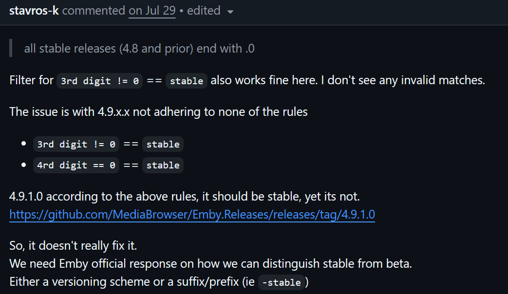

dgrigo 35 Posted October 15, 2025 Posted October 15, 2025 I had an idea, and I am trying if it work now at least until we have a fix. I try to ignore the update until i will see inside emby congig, the message that there is an update available, and the message restart to update. then i am checking until the version number of maintainer change , it takes 1 or 2 days till bot makes the build from the time we see the message inside emby config or docker hub. then I will try to update, its cumbersome so I hope that he will find the info he needs. BTW https://github.com/truenas/apps/pull/2820 hit stavros-k who is the maintainer He said that The issue is with 4.9.x.x not adhering to none of the rules 3rd digit != 0 == stable 4rd digit == 0 == stable 4.9.1.0 according to the above rules, it should be stable, yet its not. https://github.com/MediaBrowser/Emby.Releases/releases/tag/4.9.1.0 So, it doesn't really fix it. We need Emby official response on how we can distinguish stable from beta. Either a versioning scheme or a suffix/prefix (ie -stable) Thanks
Luke 42242 Posted October 15, 2025 Posted October 15, 2025 the release names on github releases end in -beta for betas. Additionally beta releases are also marked with the prerelease flag. So if you're using the github api, either of those two could be checked. Quote The issue is with 4.9.x.x not adhering to none of the rules 3rd digit != 0 == stable 4rd digit == 0 == stable We had never said it would be this way. In fact when someone mentioned that this is how they are determining it, that was the first I heard of it.
