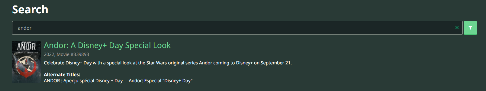

Heinrich 1 Posted May 27, 2025 Posted May 27, 2025 (edited) The good news is that I am realizing I haven't had a problem with this in years. I remember years ago when I was first building my server library I would have occasional mis-identified titles. This one has been a struggle! The show is in the TV folder. I've deleted out the *.nfo files manually. I've tried plugging into the server the "external IDs" by looking them up. I've used the "remove identification" function numberous times, along with "refresh metadata." I've also tried renaming the episodes to a different type naming convention. But the server keeps identifying TV show as one of the promo movies for the TV show and making it a movie Version 4.8.11.0 Edited May 27, 2025 by Heinrich

Heinrich 1 Posted May 27, 2025 Author Posted May 27, 2025 [the other topic in the Ember forum can be deleted. I thought I was here] The good news is that I am realizing I haven't had a problem with this in years. I remember years ago when I was first building my server library I would have occasional mis-identified titles. This one has been a struggle! The show is in the TV folder. I've deleted out the *.nfo files manually. I've tried plugging into the server the "external IDs" by looking them up. I've used the "remove identification" function numberous times, along with "refresh metadata." I've also tried renaming the episodes to a different type naming convention. But the server keeps identifying TV show as one of the promo movies for the TV show and making it a movie \\Unraid\tv\Andor Andor - S01E01 - Kassa.mkv Andor - S01E03 - Reckoning.mkv have both been picked as Andor: A Disney+ Day Special Look I also tried a different naming convention Version 4.8.11.0 embyserver.txt
