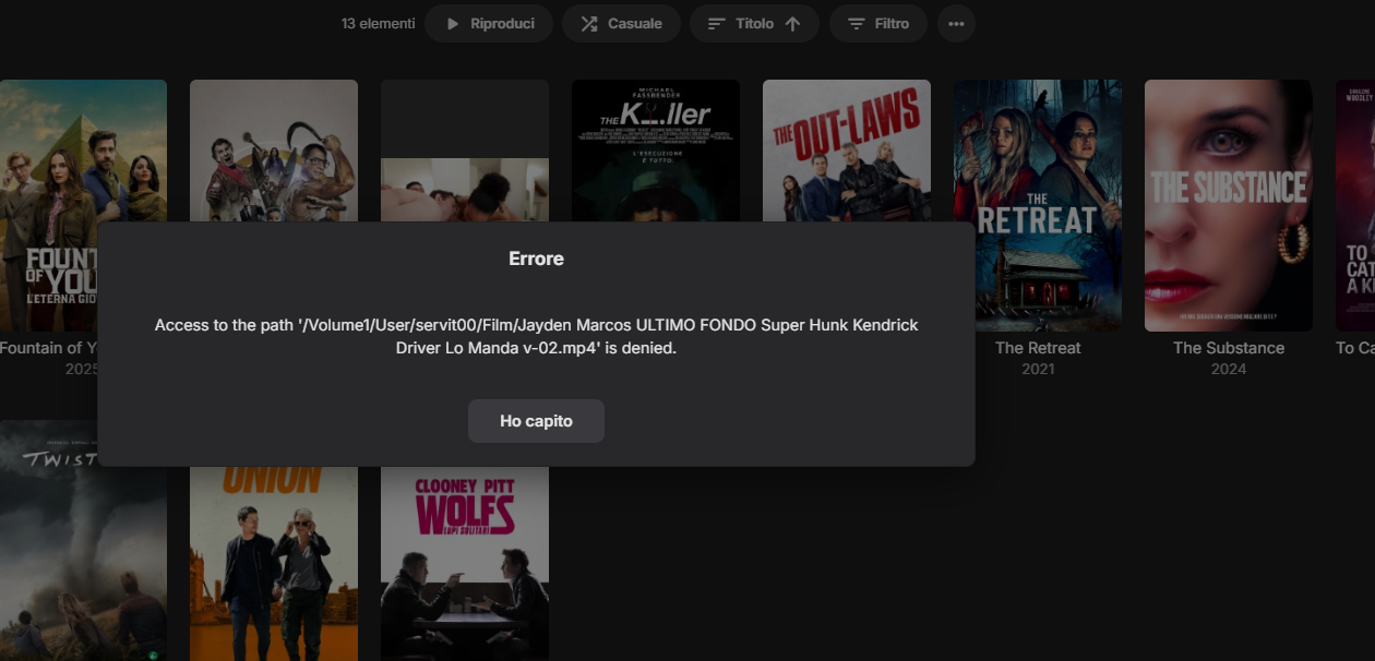

servit00 2 Posted May 26, 2025 Author Posted May 26, 2025 thank you but if i try delete, even in new address, it says access denied, can you help me?

Neminem 1619 Posted May 26, 2025 Posted May 26, 2025 Server logs would show permissions issues. But most likely permissions are wrong, and there for you can't delete.
Luke 42237 Posted May 26, 2025 Posted May 26, 2025 1 hour ago, servit00 said: thank you but if i try delete, even in new address, it says access denied, can you help me? Hi there, please attach the Emby server log from when the problem occurred: How to Report a Problem Thanks!

Luke 42237 Posted May 26, 2025 Posted May 26, 2025 @servit00the server is being denied access to delete the file. What would you like Emby to do about that? I think you need to resolve whatever the permissions problem is and then you should be able to delete.
servit00 2 Posted May 26, 2025 Author Posted May 26, 2025 7 minutes ago, Luke said: @servit00the server is being denied access to delete the file. What would you like Emby to do about that? I think you need to resolve whatever the permissions problem is and then you should be able to delete. thank you but this problem is under nas app (terramaster) or pc or emby?
Neminem 1619 Posted May 27, 2025 Posted May 27, 2025 23 hours ago, servit00 said: System.UnauthorizedAccessException: System.UnauthorizedAccessException: Access to the path '/Volume1/User/servit00/Film/Jayden Marcos ULTIMO FONDO Super Hunk Kendrick Driver Lo Manda v-02.mp4' is denied. It pretty evident ? Server side permissions.
servit00 2 Posted May 27, 2025 Author Posted May 27, 2025 2 minutes ago, Neminem said: It pretty evident ? Server side permissions. thanks. can you help me? where can i find problem? in nas perhaps? what can i look for?

Solution Luke 42237 Posted May 28, 2025 Solution Posted May 28, 2025 @servit00did you figure this out?
servit00 2 Posted May 29, 2025 Author Posted May 29, 2025 14 hours ago, Luke said: @servit00did you figure this out? Thanks. I solved creating a new folder. Now i access from remote. Thanks
