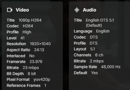

65535 14 Posted May 26, 2025 Posted May 26, 2025 I'm encountering frequent crashes when seeking in particular files on my new Android TV box. I'm hoping I can get a dev to look at this. The files I found that cause it all use the lossy DTS audio format. Here's an example of one: Here is a log of the session that crashed: emby_android_1748256079039.txt This is on a Xiaomi TV Box S 3rd Gen (also known as MiTV-AFMU0 / MDZ-32-AA) and it has Android TV 14.

65535 14 Posted May 26, 2025 Author Posted May 26, 2025 (edited) 4 so far that I found. It happens with every file with this specific format DTS 5.1 that I try. Also it seems Kodi is immune as I've been unable to make it crash like that. Edited May 26, 2025 by 65535
