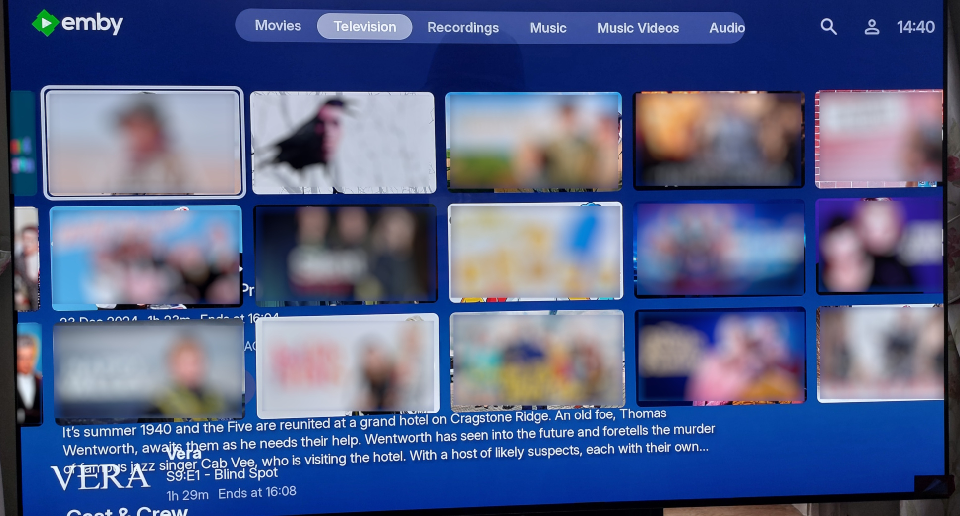

unisoft 355 Posted May 25, 2025 Posted May 25, 2025 (edited) New WebOS 25 - TV 2025 RANGE, OLEDG56LS.AEK 1. The Emby UI sometimes crashes style sheets over each other. For example, I am in a TV library, looking at episode detail, and press back to get to home screen. The home screen appears (horizontal view) and the UI is still showing the old screen behind, with the navigation on the behind screen. Both attempt to display over each other, a right mess! Happened a few times now, and seems to be after a while of playing programmes and then navigating back. 2. When finished playing a TV episode, I press back and get back to the GENRES page in TV library, I then can't scroll down the list of TV shows as remote just halts and cant scroll down the A-Z picker on the side. I have to press BACK key and go into the genre again and it works again. Likes like some sort of pointer gets corrupted at complete guess. WebOS25 will eventually get to go on the 2024 TV range as they have 4 major WebOS upgrades when you buy an LG TV, in addition to the original shipping version. I didn't renew with Sony Bravia II OLED as I expected to, as blacks better on LG G5, and although I like Google TV, the frame rate match API only being used by Netflix was the killer, along with LG's better firmware support of 4 major WebOS versions. I can't stand stutter or judder if device can't do frame rate match and the Sony's traditionally have to to use motion controls to try and hide it. Google TV and apps run in 60hz, and in the UK we are 50hz. LG have fixed Dolby Vision issue, and working on the remaining HDR issue so a firmware fix soon. Also, the G5 was on really good promotion here with 20% off, £200 cashback and free LG £699 Dolby Atmos soundbar and cashback from topcashback and 6 year guarantee from Richer Sounds retailer. The picture is amazing, once tweaked and toned down, and will be even better soon after a firmware update or two. I am still keeping my original LG OLEDC6V as the panel still pristine and clean with no-burn in and last 3D TV of its kind. Really pleased Emby was in the LG store, so congratulations, no waiting, thank you. Edited May 25, 2025 by unisoft

unisoft 355 Posted May 27, 2025 Author Posted May 27, 2025 (edited) 19 hours ago, Luke said: Hi, can you please show a screenshot example? Thanks. Here you go. I watched a TV episode, then a music video, then a tv episode, stopped half way through marked as played. I might have dipped in and out of another 2 episodes. I have blurred the main tiles on home page out to obscure what the titles are. You can see the episode details leaking behind the home page (TV Mode, horizontal view). Issue #2 in my top post is very easy to reproduce and happens like clockwork. Edited May 27, 2025 by unisoft
