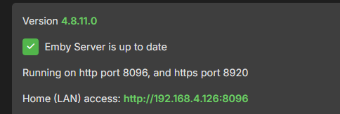

Luke 42243 Posted May 24, 2025 Posted May 24, 2025 Does your server dashboard display the correct LAN address?
Riptide126 24 Posted May 24, 2025 Author Posted May 24, 2025 (edited) Yes it does Edited May 24, 2025 by Riptide126

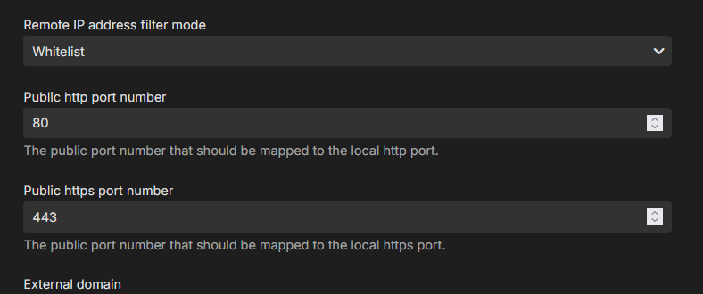

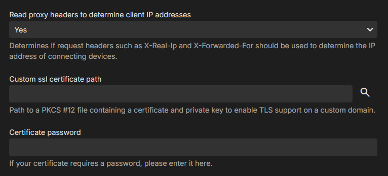

Luke 42243 Posted May 31, 2025 Posted May 31, 2025 7 hours ago, Riptide126 said: If anyone else has any ideas for testing or anything let me know. It would be nice if I could get this figured out. How have you configured emby server network settings?
Riptide126 24 Posted May 31, 2025 Author Posted May 31, 2025 I have a reverse proxy setup through nginx, here are my network settings, the only thing I didnt include was my external domain name.
Q-Droid 1011 Posted June 1, 2025 Posted June 1, 2025 Have you tried entering your subnet in the LAN networks field?
Riptide126 24 Posted June 3, 2025 Author Posted June 3, 2025 I have not but I don't think it will fix anything, when I play on my smart tv it correctly shows the local ip address and treats it like a local stream, the problem with my pc is for some reason in emby it shows up as my public ip address even though I am on the same network.
