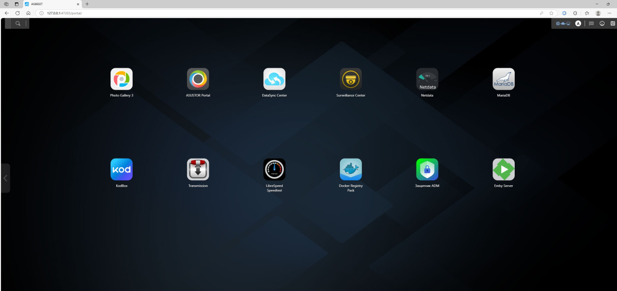

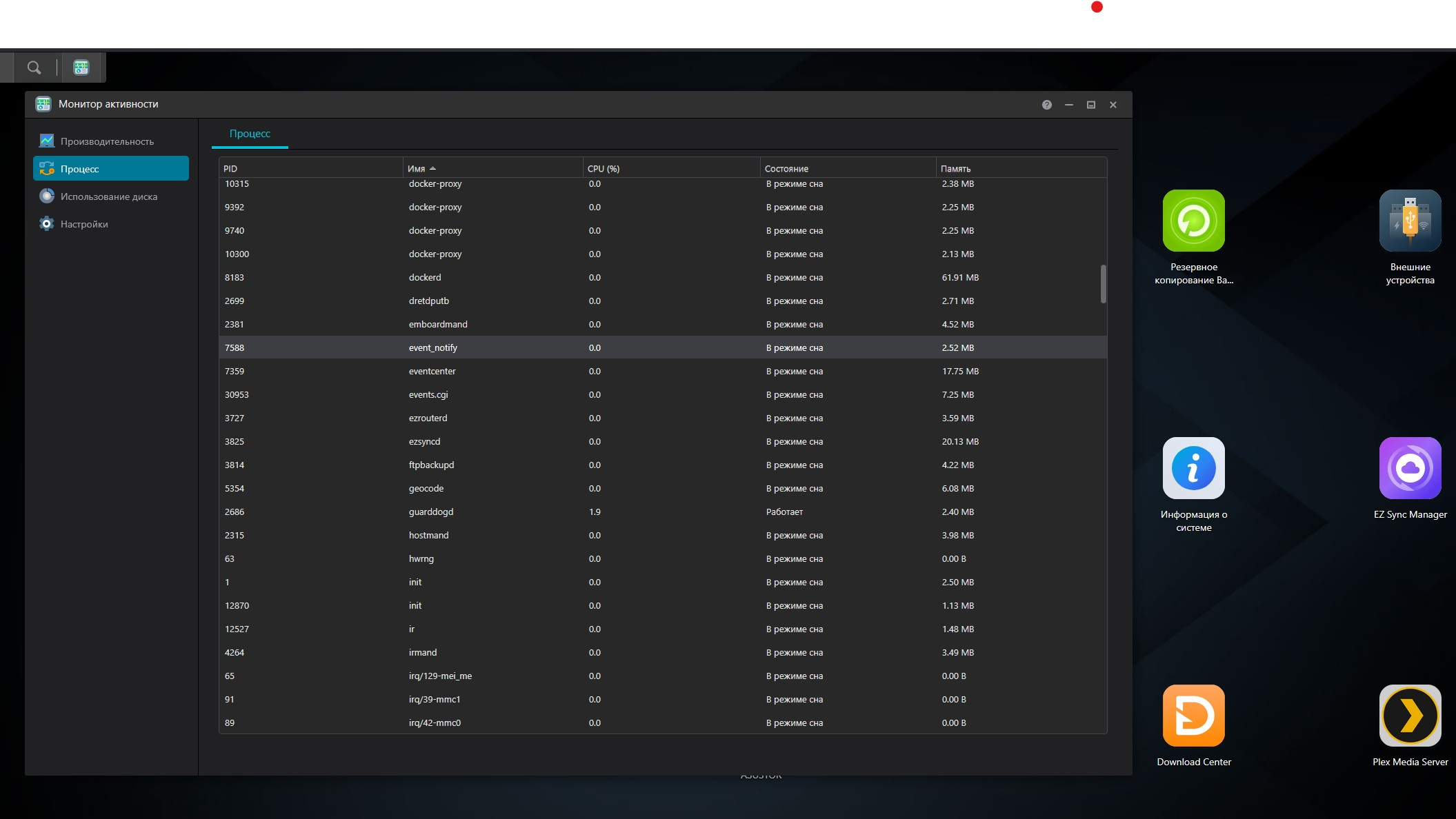

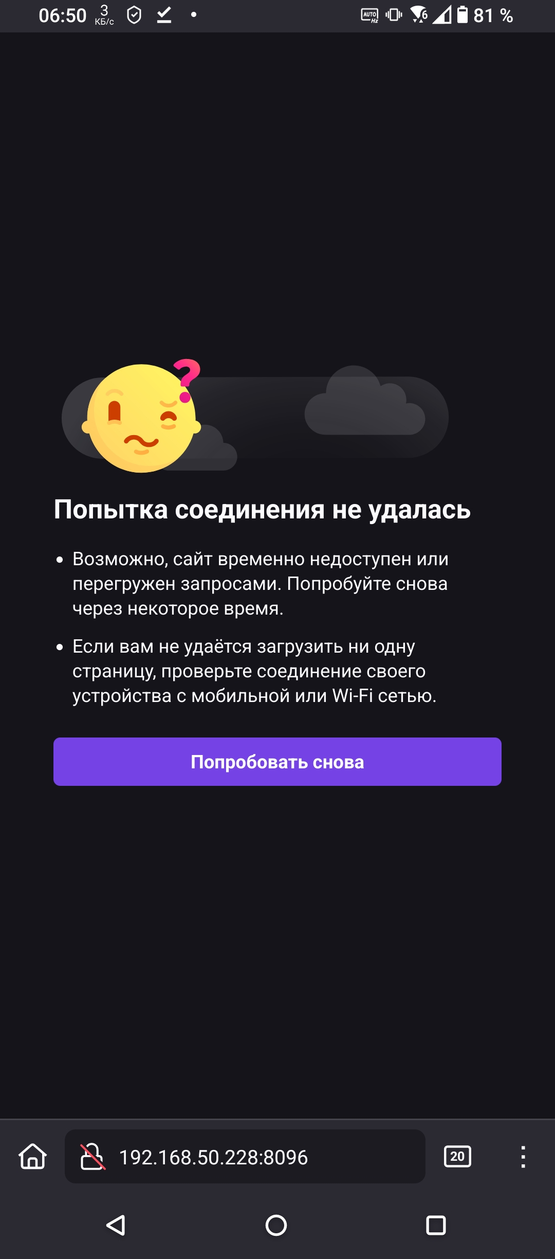

madskillz 1 Posted May 28, 2025 Author Posted May 28, 2025 2 minutes ago, seanbuff said: If you are connecting via browser from a different machine, then you will not be able to use http://127.0.0.1 as that is used only on the local Asustor itself. Are you able to show evidence that the Emby Server process is in fact actually running? Because it does not appear it is. What can you see inside the actual Asustor interface? I am at work at the moment. There is such a program from ASUSTOR - ASUSTOR EZ Connect.
seanbuff 1355 Posted May 28, 2025 Posted May 28, 2025 21 minutes ago, madskillz said: There is such a program from ASUSTOR - ASUSTOR EZ Connect. Okay. I myself know nothing about the Asustor platform, but a quick online research seems to indicate that you can use a tool called ADM (Asustor Data Master) Log in to ADM via your browser (e.g., http://<NAS-IP>:8000). Go to App Central to see which apps are installed and running. Alternatively, go to Settings > System Information > Resource Monitor: This section gives you an overview of CPU, memory, and network usage. It may not show all background processes, but it does show which applications are active. I would try the above, to check whether the Emby Server process is actually running or not. Let us know what you find.
madskillz 1 Posted May 28, 2025 Author Posted May 28, 2025 16 minutes ago, seanbuff said: Okay. I myself know nothing about the Asustor platform, but a quick online research seems to indicate that you can use a tool called ADM (Asustor Data Master) Log in to ADM via your browser (e.g., http://<NAS-IP>:8000). Go to App Central to see which apps are installed and running. Alternatively, go to Settings > System Information > Resource Monitor: This section gives you an overview of CPU, memory, and network usage. It may not show all background processes, but it does show which applications are active. I would try the above, to check whether the Emby Server process is actually running or not. Let us know what you find. I sorted by name. Emby is missing!

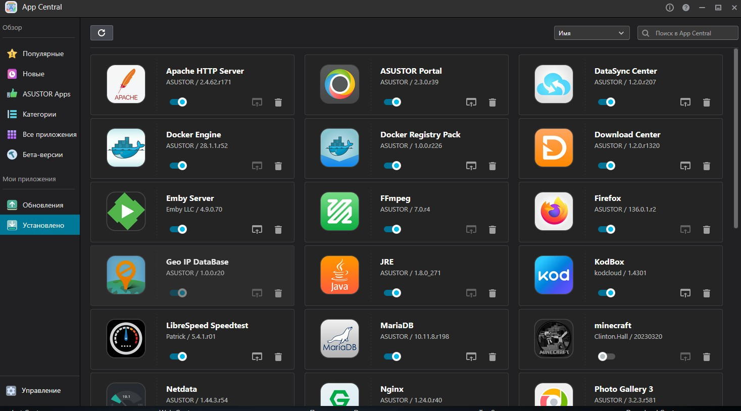

Luke 42237 Posted May 31, 2025 Posted May 31, 2025 Can you try uninstalling and reinstalling again from Asustor package center? Thanks !
madskillz 1 Posted June 2, 2025 Author Posted June 2, 2025 On 5/31/2025 at 11:37 AM, Luke said: Can you try uninstalling and reinstalling again from Asustor package center? Thanks ! Hi, I'm sorry it's so late.
madskillz 1 Posted June 2, 2025 Author Posted June 2, 2025 On 5/31/2025 at 11:37 AM, Luke said: Can you try uninstalling and reinstalling again from Asustor package center? Thanks ! I tried it - it didn't help.

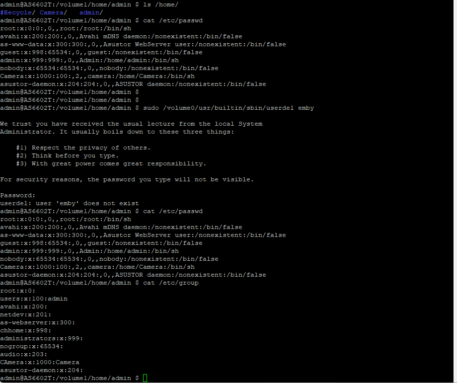

madskillz 1 Posted June 30, 2025 Author Posted June 30, 2025 11 hours ago, Luke said: Hi, please follow along this topic: Thanks. HI! As I already said. I don't have such folders. I deleted everything and this method doesn't help me!
