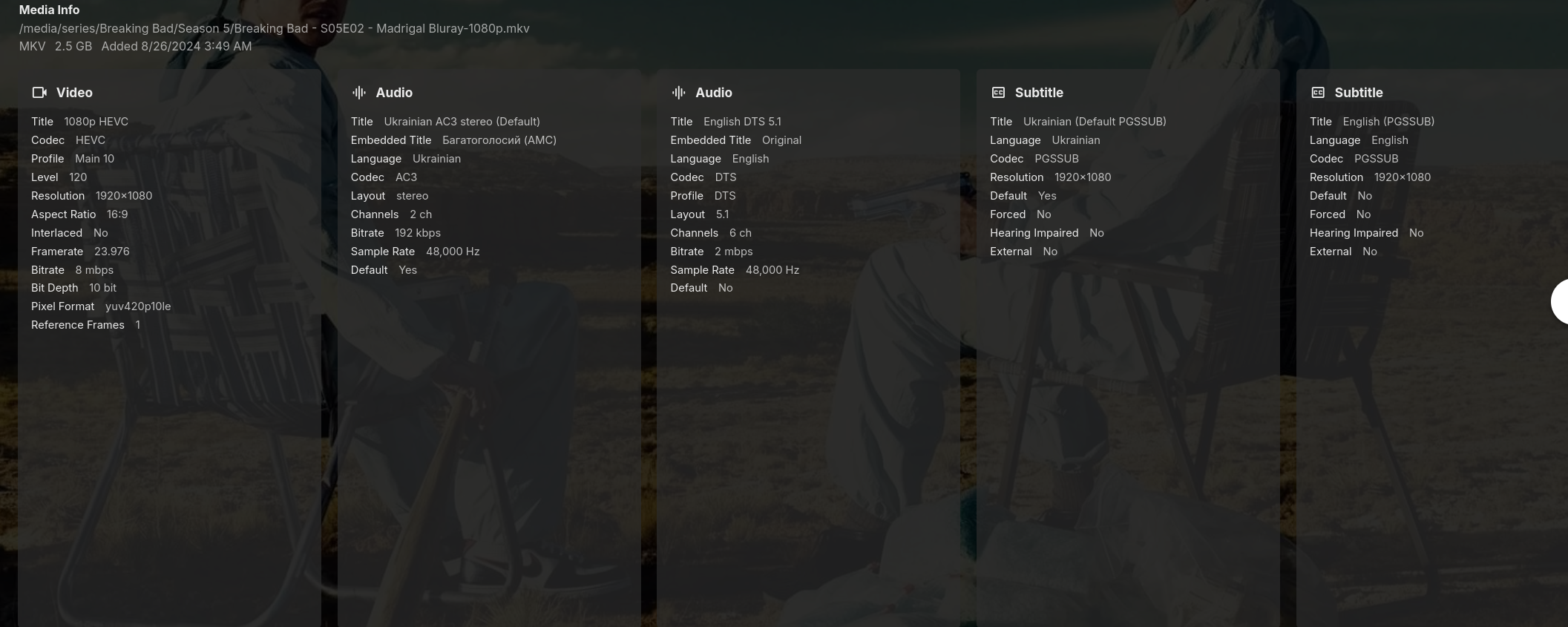

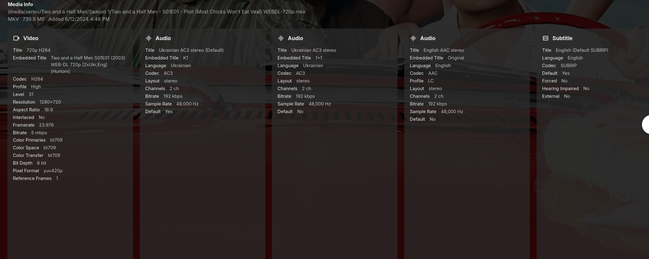

Darkel_91 2 Posted July 16, 2025 Author Posted July 16, 2025 On 7/13/2025 at 8:58 AM, SamES said: Can you post some updated logs and examples? Yes, here you are embyserver_1 - is the first instance that I had from the very start File_1 here starts at 2025-07-16 11:49:03.242. You will see few tries with DirectPlay (no luck still) and a few with transcoding (worked well just like the last time) File_2 here starts at 2025-07-16 12:45:03.930. No luck with this one, did not try transcoding. embyserver_2 - is the new instance where I managed to launch same files File_1 - starts at 2025-07-16 12:32:54.149, played well with DirectPlay, I also tried changing audio track - no problems with that. File_2 - starts at 2025-07-16 12:37:50.896, played well with DirectPlay The thing I should also mention - when I left my last message, it was just as I described in that one. When I came back today to get some logs - I discovered that on server_2 the files won't launch either! So I reset the server by deleting all the data and got it to run both file_1 and file_2 and got both files working on server_2 again (but who knows how long that will last). Another weird thing is that file_2 does work sometimes on server_1, but not always. As I was trying and testing there were cases where it would launch. Logs for that are in embyserver_1_file_2_v2 file, i guess you want to be looking at 2025-07-16 12:59:15.836 (it did play here) and 2025-07-16 13:01:06.312 (did not play here). between those i also tried to launch file_1 (2025-07-16 12:59:46.532, no luck), maybe that influenced file_2 somehow.... That's all too weird. I hope just hope you managed to understand what I'm saying here haha embyserver_1_file_1.txt embyserver_1_file_2.txt embyserver_1_file_2_v2.txt embyserver_2_file_1.txt embyserver_2_file_2.txt

SamES 1084 Posted July 16, 2025 Posted July 16, 2025 2 hours ago, Darkel_91 said: Yes, here you are embyserver_1 - is the first instance that I had from the very start File_1 here starts at 2025-07-16 11:49:03.242. You will see few tries with DirectPlay (no luck still) and a few with transcoding (worked well just like the last time) File_2 here starts at 2025-07-16 12:45:03.930. No luck with this one, did not try transcoding. embyserver_2 - is the new instance where I managed to launch same files File_1 - starts at 2025-07-16 12:32:54.149, played well with DirectPlay, I also tried changing audio track - no problems with that. File_2 - starts at 2025-07-16 12:37:50.896, played well with DirectPlay The thing I should also mention - when I left my last message, it was just as I described in that one. When I came back today to get some logs - I discovered that on server_2 the files won't launch either! So I reset the server by deleting all the data and got it to run both file_1 and file_2 and got both files working on server_2 again (but who knows how long that will last). Another weird thing is that file_2 does work sometimes on server_1, but not always. As I was trying and testing there were cases where it would launch. Logs for that are in embyserver_1_file_2_v2 file, i guess you want to be looking at 2025-07-16 12:59:15.836 (it did play here) and 2025-07-16 13:01:06.312 (did not play here). between those i also tried to launch file_1 (2025-07-16 12:59:46.532, no luck), maybe that influenced file_2 somehow.... That's all too weird. I hope just hope you managed to understand what I'm saying here haha embyserver_1_file_1.txt 1.23 MB · 0 downloads embyserver_1_file_2.txt 237.74 kB · 0 downloads embyserver_1_file_2_v2.txt 1.13 MB · 0 downloads embyserver_2_file_1.txt 1.07 MB · 0 downloads embyserver_2_file_2.txt 112.39 kB · 0 downloads Thanks Can you please Attach the media info for the examples confirm if any files direct play, or is it just a few examples that have issues confirm it the server is local or remote are you using a reverse proxy are you trying to connect the app to the server using https
Darkel_91 2 Posted July 17, 2025 Author Posted July 17, 2025 Ok, I think i stumbled on a breakthough in this case. It has something to do with selected audiotrack when starting the playback. When I start File_1 with track1 (default, Ukrainian, AC3) it will play perfectly well, even if I change the track. If start it with the track2 (English, DTS 5.1) - it won't play even if I change the track back to default one. Similar results with File_2 - it starts well with track1 and track2 (which are Ukrainian AC3) and won't start with track3 (English, AAC). And again, changing track after start won't make a difference - it will play any track if already playing well, and it won't play if the "wrong" track was chosen at the start. File_1 was tested and both servers and the result is the same, FIle_2 - only on server_1 (the one I has issues with from the start). Logs are attached. I also tested some other files, and looks like the issue may be connected to some settings during ripping, because some other files that used AAC and DTS5.1 played fine if corresponding track were selected. But still, even these files with allegedly badly ripped tracks CAN play, if I chose different track instead at start and switch to the "bad" one later. And they CAN play normally on other devices with the "bad" track selected from the start. As for your questions: Attach the media info for the examples in attachment. if needed, I can share the very files. confirm if any files direct play, or is it just a few examples that have issues no, not all the files have issues. Some (I would say most) play perfectly well. Moreover, these problematic files play well on other devices from the same server, it's only LG TV client that has issues with them confirm it the server is local or remote on the TV I'm connected via LAN but remote was enabled on server_2 are you using a reverse proxy at the time of recent testing server_2 was forwarded to a remote proxy, but it was not used for local connection. Server_1 (the one that has more issues) is not using reverse proxy. are you trying to connect the app to the server using https Server_2 was forwarded to a remote proxy that had SSL certificates and HTTPS set up, but the connection was local. For now server_2 seems to work well, I am yet to find a file it cannot play. embyserver_1_file_1_audiotrack.txt embyserver_1_file_2_audiotrack.txt embyserver_2_file_1_audiotrack.txt
SamES 1084 Posted July 17, 2025 Posted July 17, 2025 Sounds like you're narrowing it down. Can you try doing a test using the local server and a plain http connection? You might have to change the server setting briefly to allow plain http. Are there any ffmpeg logs for these playback tests? In your two images for file_1 and file_2 I can only see one audio track for each. Can you provide the full media info? But it does sound like there might be some issues with these files.

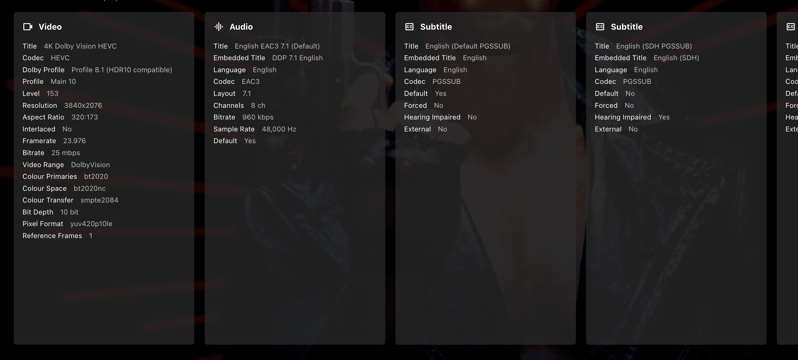

SamES 1084 Posted July 17, 2025 Posted July 17, 2025 It's not a DTS issue, that model TV still supports DTS. @Darkel_91, thanks for the media info. Can you please also copy the media info block that is at the bottom of the details page for those movies on the server. I'd like to confirm how the server is actually detecting this as well. I mean in the format below, just be sure to scroll across if required to get all the streams. You may need to do multiple screenshots to get it all. Just to clarify, you have 2 servers and 1 TV you are using for testing. Server 2 has no issues with any files, but server 1 has issues with some files that work fine on server 2. Is that correct? 1
