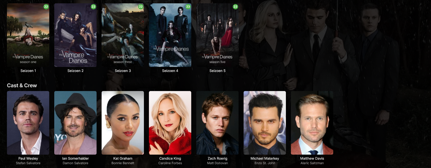

Weet er iemand hoe het komt dat als wij een film of serie in Emby zitten deze amper acteurs erin zet? Onze info wordt van verschillende metadata-sites gehaald zoals TMBD, IMDB, Trakt, TVDB en daarop staan enorm veel acteurs bij een bepaalde serie maar toch zet hij er in Emby maar bvb 3 in...Hoe komt dit en kunnen we dit oplossen? Metadata vernieuwen doet niks. Zie afbeelding voor voorbeeld.

Does anyone know why when we put a movie or series in Emby it hardly puts any actors in it?
Our info is taken from various metadata sites such as TMBD, IMDB, Trakt, TVDB and there are a lot of actors in a certain series but
still it only puts 3 in Emby for example...
How does this happen and can we solve this? Refreshing metadata does nothing. See image for example.
Screenshot 2025-05-20 at 22-21-06 The Vampire Diaries (TV Series 2009-2017) - Cast & crew — The Movie Database (TMDB).png

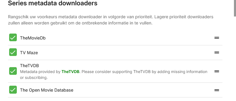

Hi, what metadata fetchers are enabled on the library, and in what order?
KimberlyDC
Hi, i'll put in a picture of how it is on that library.

Happy2Play
Would have to test myself but it is the way TMDB breaks out Cast and you have to remember Cast will only come from first provider.  But TMDB Cast list is decieving as it lists every person ever on the show but does not provide that full list as series level as they technically are some Guest stars.
From TMDB Series json
    "credits": {
        "cast": [{
                "adult": false,
                "gender": 2,
                "id": 83141,
                "known_for_department": "Acting",
                "name": "Paul Wesley",
                "original_name": "Paul Wesley",
                "popularity": 4.489,
                "profile_path": "/1WGVCxymuPTiBCqo1Nsy42CZmEd.jpg",
                "cast_id": 0,
                "character": "Stefan Salvatore",
                "credit_id": "52585550760ee34661096e9f",
                "order": 1
                "adult": false,
                "gender": 2,
                "id": 19211,
                "name": "Ian Somerhalder",
                "original_name": "Ian Somerhalder",
                "popularity": 7.4185,
                "profile_path": "/gq8YFzAOaxNVtSUFKccpxp2YjRS.jpg",
                "cast_id": 0,
                "character": "Damon Salvatore",
                "credit_id": "52585550760ee34661096e47",
                "order": 2
                "adult": false,
                "gender": 1,
                "id": 159962,
                "name": "Kat Graham",
                "original_name": "Kat Graham",
                "popularity": 3.9413,
                "profile_path": "/gZb5Xz2eKZqDy4hXgTEtvyTvRq4.jpg",
                "cast_id": 0,
                "character": "Bonnie Bennett",
                "credit_id": "52585551760ee34661096f75",
                "order": 5
                "adult": false,
                "gender": 1,
                "id": 85144,
                "name": "Candice King",
                "original_name": "Candice King",
                "popularity": 3.5393,
                "profile_path": "/qy290E0X2o1NZwhGyiGSmMi1tyB.jpg",
                "cast_id": 0,
                "character": "Caroline Forbes",
                "credit_id": "52585550760ee34661096f23",
                "order": 6
                "adult": false,
                "gender": 2,
                "id": 221841,
                "name": "Zach Roerig",
                "original_name": "Zach Roerig",
                "popularity": 2.9203,
                "profile_path": "/fjNS8QTDnGsuoOz66aP6JlN93FQ.jpg",
                "cast_id": 0,
                "character": "Matt Donovan",
                "credit_id": "554d66169251413faa002e4d",
                "order": 7
                "adult": false,
                "gender": 2,
                "id": 1465190,
                "name": "Michael Malarkey",
                "original_name": "Michael Malarkey",
                "popularity": 1.8125,
                "profile_path": "/731hKJr8wnFf2OEx6wMcAQyO1g6.jpg",
                "cast_id": 0,
                "character": "Enzo St. John",
                "credit_id": "554d6406c3a3682594002cc7",
                "order": 10
                "adult": false,
                "gender": 2,
                "id": 56045,
                "name": "Matthew Davis",
                "original_name": "Matthew Davis",
                "popularity": 2.8901,
                "profile_path": "/9QsCJBQ45iR5R36F0LAuzvY1zuO.jpg",
                "cast_id": 0,
                "character": "Alaric Saltzman",
                "credit_id": "52585551760ee34661096f49",
                "order": 14
Where TVDB has 14 listed.

GrimReaper
Yes, as TMDB "credits" argument returns only latest season cast - to see full cast from all seasons, Emby would need to query "aggregate_credits" - which, I assume, a lot of users would not happily welcome.
