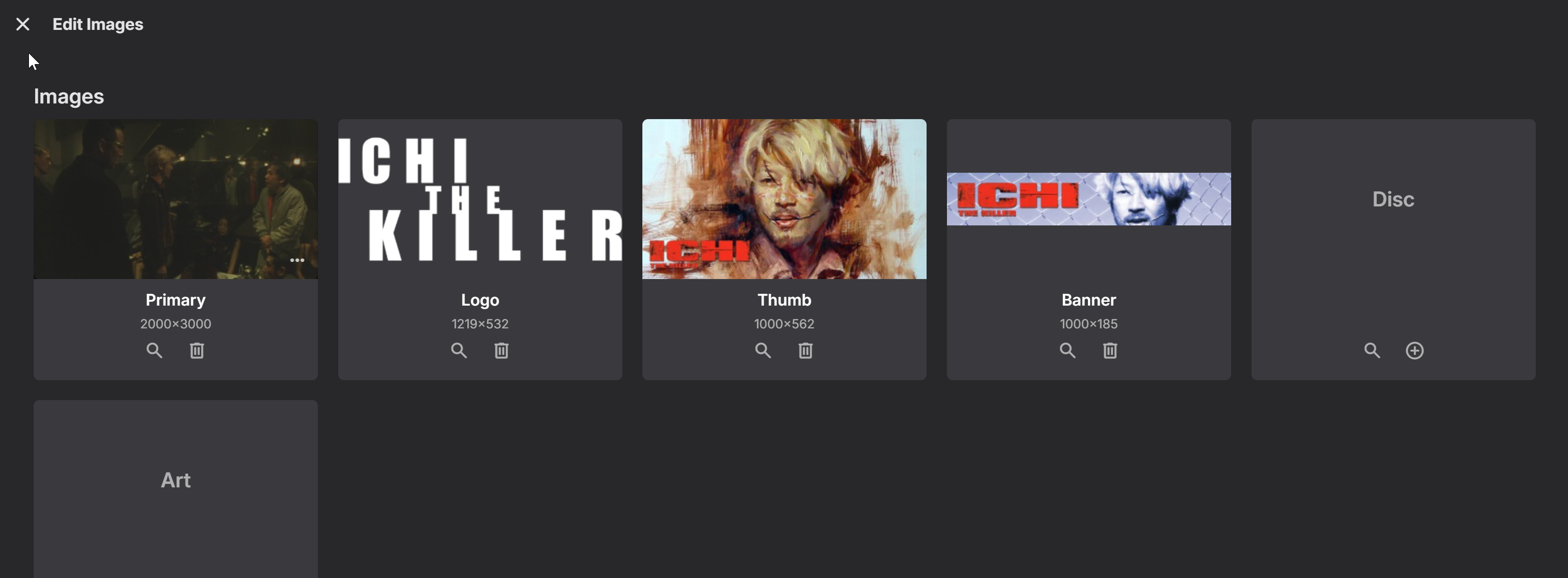

jan_axhell 4 Posted May 20, 2025 Posted May 20, 2025 (edited) I usually scan 4Tb disks as soon as they're full and then check for missing/wrong movie entries and manually fix them (I save metadata both to cache and disks). This means that if I see a wrong title/poster, I launch "Identify", enter the IMDB ID and in short everything is ok. Now with v4.8.11.0 this happens only for movie information. Data is correctly switched to the movie I submitted, except for the poster, that I have to manually replace (while other images like logo, thumb, art, cast, crew, etc are already correct). Is this a bug? The one in the middle has been identified, but the poster has not been replaced. Edited May 20, 2025 by jan_axhell
Luke 42287 Posted May 20, 2025 Posted May 20, 2025 Hi, does the help text on the identity dialog explain your question about the image?

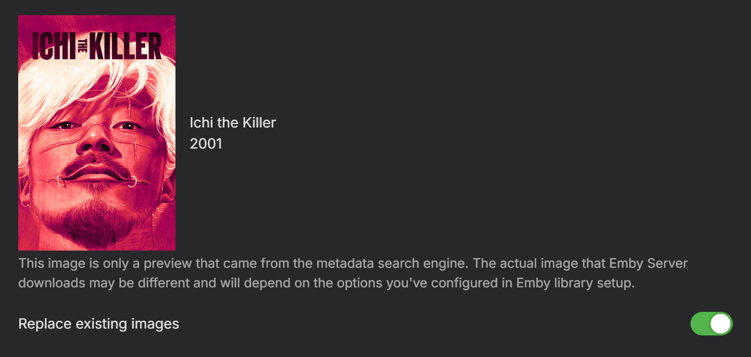

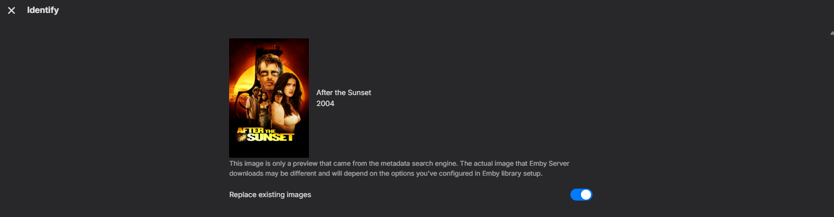

jan_axhell 4 Posted May 20, 2025 Author Posted May 20, 2025 (edited) If you mean the Replace existing images, yes, it's enabled, but has no effect, Tried right now with this, everything went in the right place, except the poster.: Edited May 20, 2025 by jan_axhell

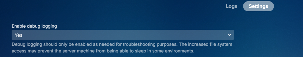

Happy2Play 9814 Posted May 20, 2025 Posted May 20, 2025 Emby appears to have gotten this image. 2025-05-20 21:30:48.665 Info HttpClient: GET https://image.tmdb.org/t/p/original/wgGZrUyogyWDUy2e2EOvkdMg9gN.jpg https://image.tmdb.org/t/p/original/wgGZrUyogyWDUy2e2EOvkdMg9gN.jpg But cannot see save location as it is only available if you enable debug logging via the logs settings page. Can only guess image in media folder is not being replaced.
jan_axhell 4 Posted May 20, 2025 Author Posted May 20, 2025 Identified another one with Debug enabled. embyserver (2).zip

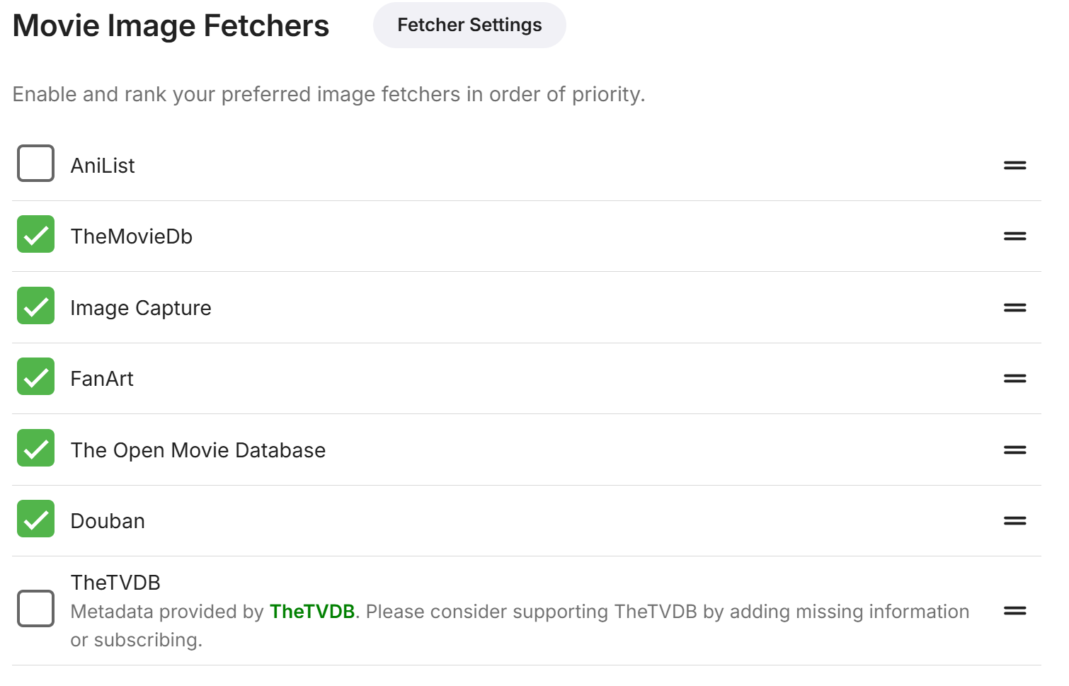

Luke 42287 Posted May 20, 2025 Posted May 20, 2025 What image fetchers are enabled on the library and in what order?

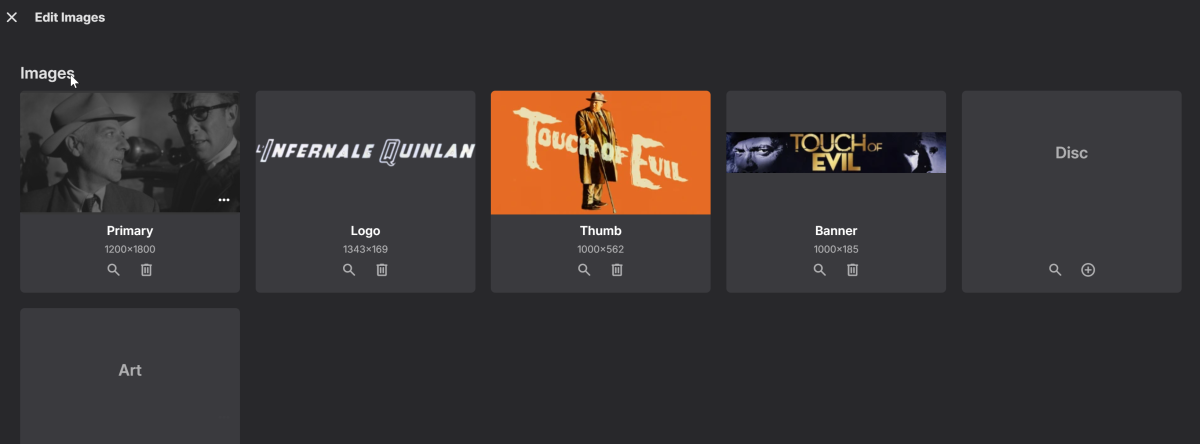

Luke 42287 Posted May 20, 2025 Posted May 20, 2025 As a test, if you use the image editor to delete the wrong poster image first and then identify, then what happens?

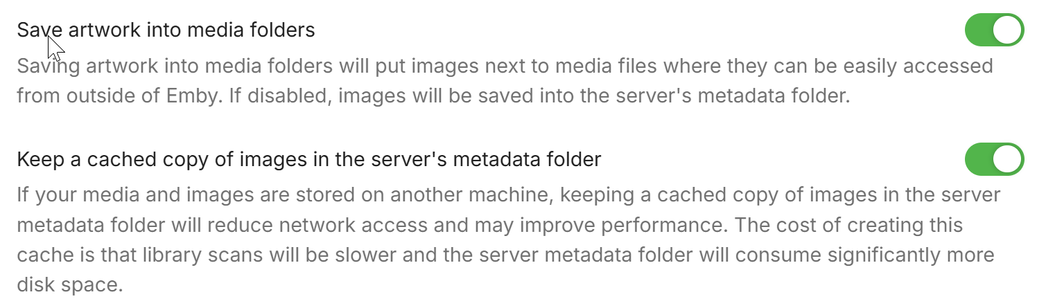

Happy2Play 9814 Posted May 21, 2025 Posted May 21, 2025 What image is here? O:\EMBY\MoviesHD44\MYS1K\poster.jpg Do you have save with media enabled? As I am not seeing any save attempts only cache.

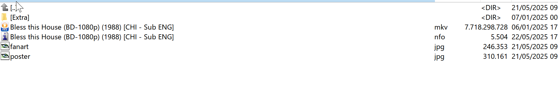

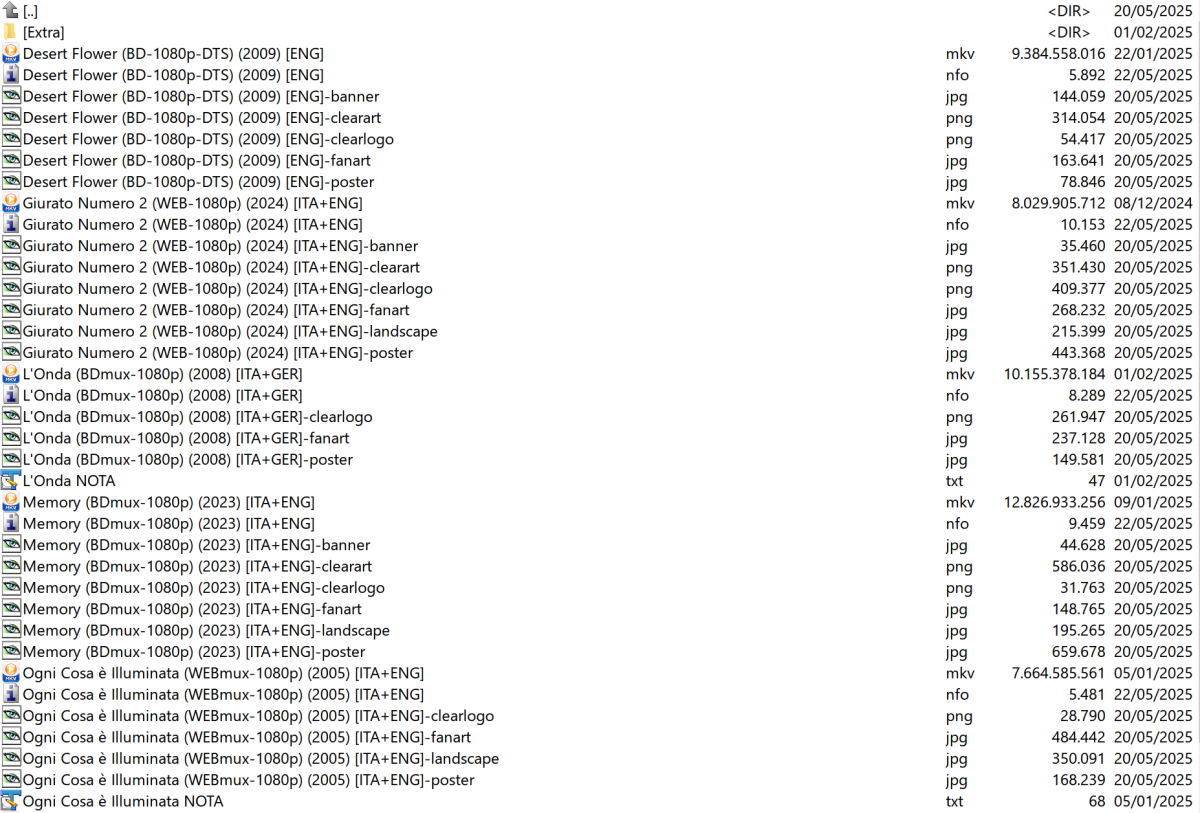

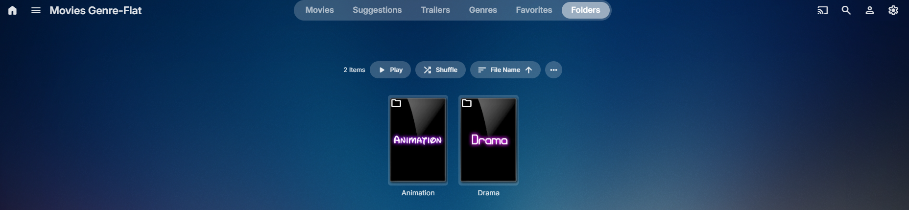

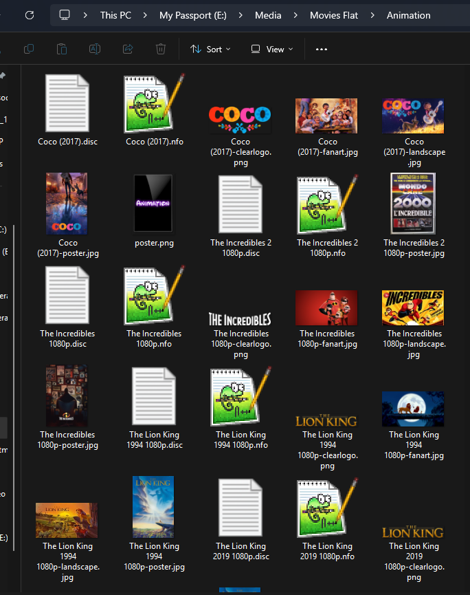

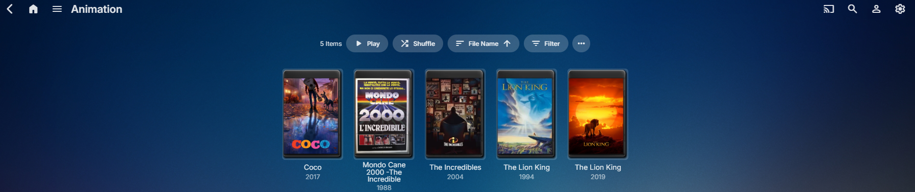

jan_axhell 4 Posted May 21, 2025 Author Posted May 21, 2025 (edited) @LukeTried now, and in this case the poster appears correctly along with other data/pics. So there is something with the screenshot placeholder for unrecognized movies. This obviously didn't occur in the past, never had this problem with 70+ HDD's. The movie I identified is "Marukin marubi no kinkonkan", I'm attaching the new log. @Happy2PlayYes. Also, but also about Quote What image is here? O:\EMBY\MoviesHD44\MYS1K\poster.jpg This is something I noticed since some time ago and it's related to my custom hierarchy: I store movies like X:\[GENRE folder]\Movie Title (BD-1080p) (1987) [ITA+ENG].mkv So movies are not each in a subfolder, but all together inside the Genre folder. This always worked fine and it's the way I stored movies long before Emby existed, so I did not change it. The thing I noticed (which is not a problem, since in the UI has no effect) is that if a Genre folder contains only 1 movie, the relative pictures are not named after the movie filename like Movie Title (BD-1080p) (1987) [ITA+ENG]-poster.jpg, but only poster.jpg, fanart,jpg, etc. This is unrelated to this thread's issue, the unreplaced posters have the name of the relative movie file. embyserver (3).zip Edited May 21, 2025 by jan_axhell

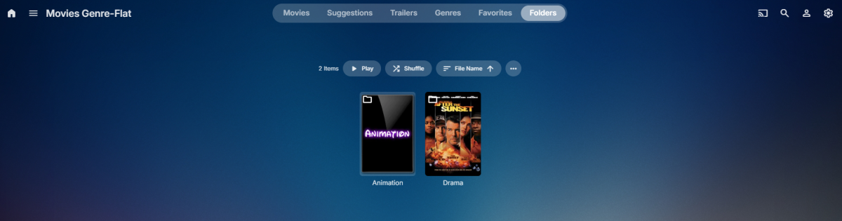

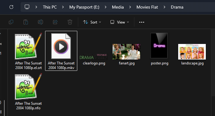

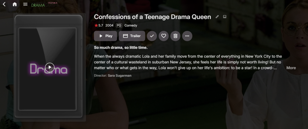

Happy2Play 9814 Posted May 27, 2025 Posted May 27, 2025 On 5/20/2025 at 11:40 PM, jan_axhell said: This is something I noticed since some time ago and it's related to my custom hierarchy: I store movies like X:\[GENRE folder]\Movie Title (BD-1080p) (1987) [ITA+ENG].mkv So movies are not each in a subfolder, but all together inside the Genre folder. This always worked fine and it's the way I stored movies long before Emby existed, so I did not change it. The thing I noticed (which is not a problem, since in the UI has no effect) is that if a Genre folder contains only 1 movie, the relative pictures are not named after the movie filename like Movie Title (BD-1080p) (1987) [ITA+ENG]-poster.jpg, but only poster.jpg, fanart,jpg, etc. Let me see if I understand this correctly, you have a flat file structure in a genre folder so technically all non-movie named images technically should be ignored ie poster/fanart/logo without files names as they do not belong to any movie. But images of exact content and naming scheme of a specific example would help. On 5/23/2025 at 10:47 AM, Luke said: @Happy2Playare you able to reproduce? Created a Movie library with Genre folders containing flat media files with existing poster image of the genre. Animation was fine as there was more than one file so each file was correctly identified From a single file in folder yes Emby fails as it does not know it is not the media folder so Drama was Identified as Drama (Normal per hidden switches for collapse single files) Now reidentify creates issues as you have a single non-media folder with media but creates confusion for Emby as image naming scheme is incorrect do to single item in non-media folder @Luke. Still nothing new from a Emby standpoint due to structure and single item in nested folder. Now folder level will inherit the wrong image due to not changing naming scheme per single items. Had to clear cache a couple times for image to update. Only tested in 4.8 but will test in 4.9 in a bit as there are changes to this aspect. But did not have an issue with edit image saving to said folder.

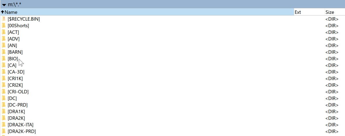

jan_axhell 4 Posted May 27, 2025 Author Posted May 27, 2025 Ok, thanks for the extensive tests @Happy2Play This pics show and example of what my hierarchy looks like. You can see the Genre folders in the root, a few movies with relative pics/nfo with same filename and a folder with a single movie with pics not named after movie filename. Then only thing I can add is the fact that this happened (for the first time) in this order: - I scanned a harddisk - Emby recognized most of the movies and downloaded all the correct assets, - Emby mis-recognized a few movies to which assigned wrong assets - Emby did not recognize at all some other movies, using a screenshot as placeholder for poster. The problem with non replaced poster happened when I identified the 2 latter cases, everything went in place, except poster. But as I realized after @Luke's suggestion, if I first removed the wrong poster/screenshot, Identify would put in place the correct poster as well. I know, it's weird.
Happy2Play 9814 Posted May 27, 2025 Posted May 27, 2025 2 minutes ago, jan_axhell said: Ok, thanks for the extensive tests @Happy2Play This pics show and example of what my hierarchy looks like. You can see the Genre folders in the root, a few movies with relative pics/nfo with same filename and a folder with a single movie with pics not named after movie filename. Then only thing I can add is the fact that this happened (for the first time) in this order: - I scanned a harddisk - Emby recognized most of the movies and downloaded all the correct assets, - Emby mis-recognized a few movies to which assigned wrong assets - Emby did not recognize at all some other movies, using a screenshot as placeholder for poster. The problem with non replaced poster happened when I identified the 2 latter cases, everything went in place, except poster. But as I realized after @Luke's suggestion, if I first removed the wrong poster/screenshot, Identify would put in place the correct poster as well. I know, it's weird. Since Emby will assume the local image already exist as one exists in folder on import it will not get a new one. And yes Identify with Replace image will delete/replace the existing image. (this single item in folder scenario is the overall issue)
