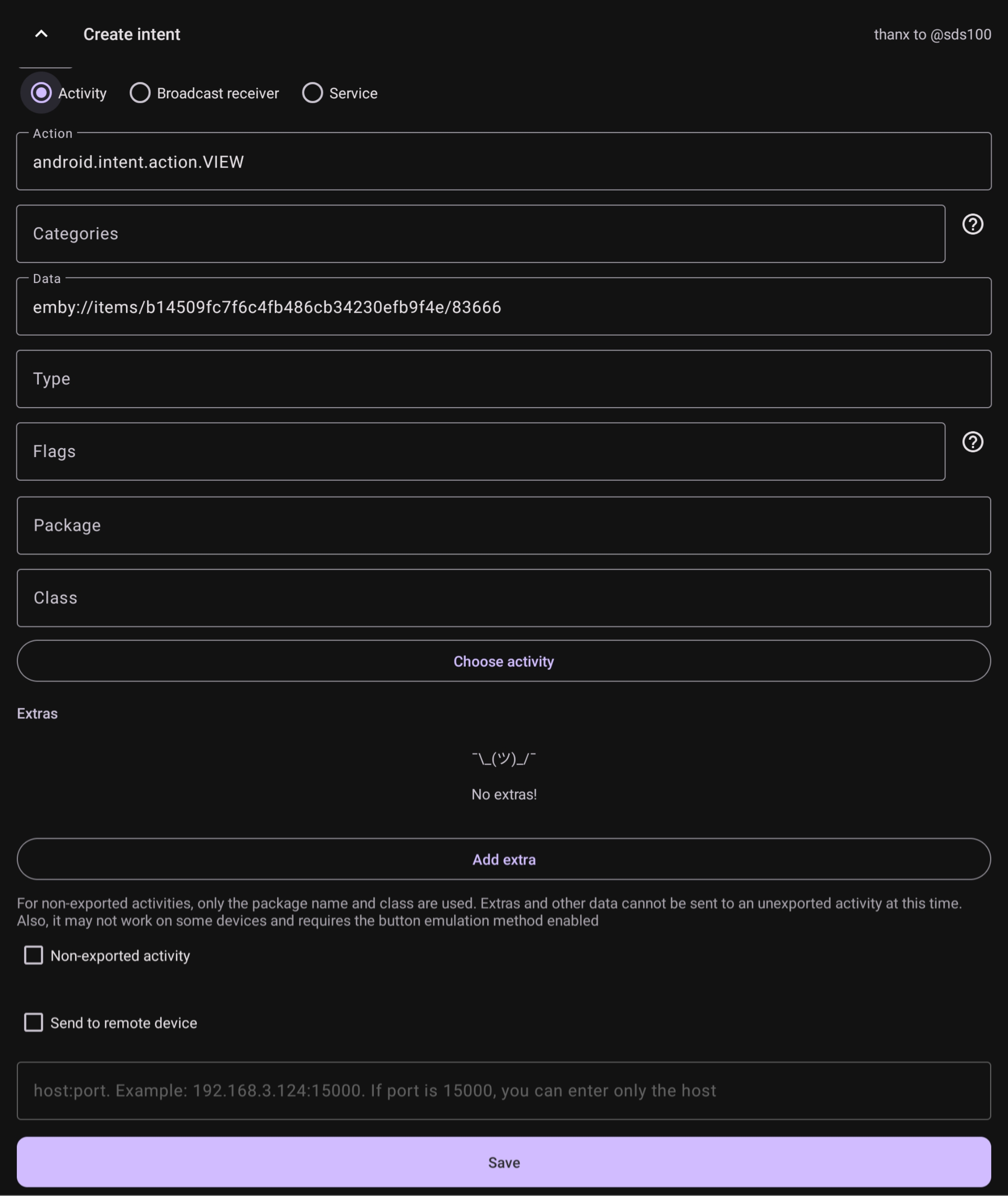

Luke 42241 Posted May 18, 2025 Posted May 18, 2025 Hi, if you're on Android then yes, you can deep link to a specific item using the emby:// scheme. You currently have to set the Intent action to "android.intent.action.VIEW", then you can use a link like "emby://items/{SERVER_ID}/{ITEM_ID}"

howllor 28 Posted September 19, 2025 Posted September 19, 2025 (edited) I hope it's okay that I use this thread, because it's also about using the emby:// scheme and intents. I am trying to make this work on a mibox running android TV 9, and nothing is happening. Do I need to add anything more to this? What I'm trying to do is add shortcuts to the home screen of Projectivy Launcher using TVQuickactions Pro Ideally what I want to do is add shortcuts to my libraries, but I thought I'd just get a simple shortcut to a movie to work first... Edited September 19, 2025 by howllor

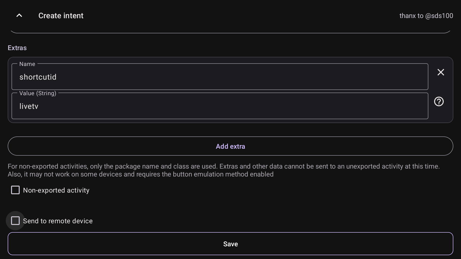

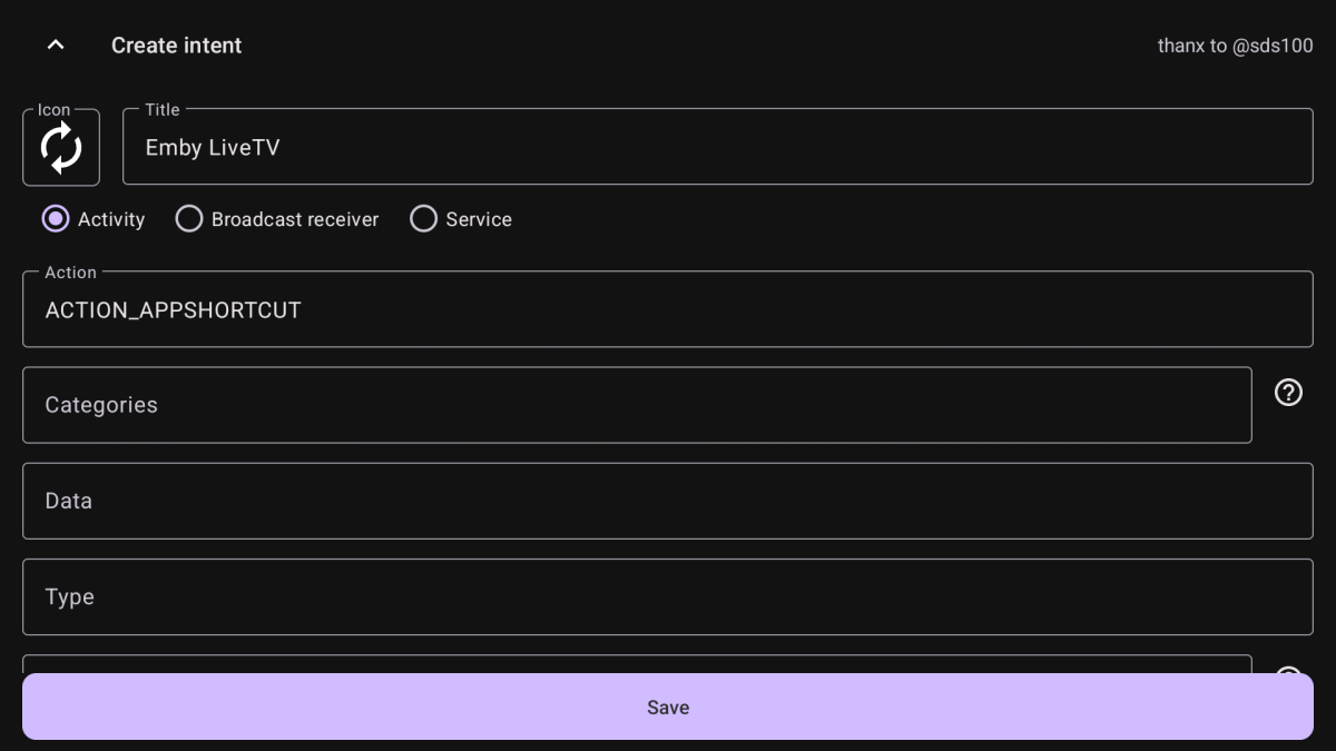

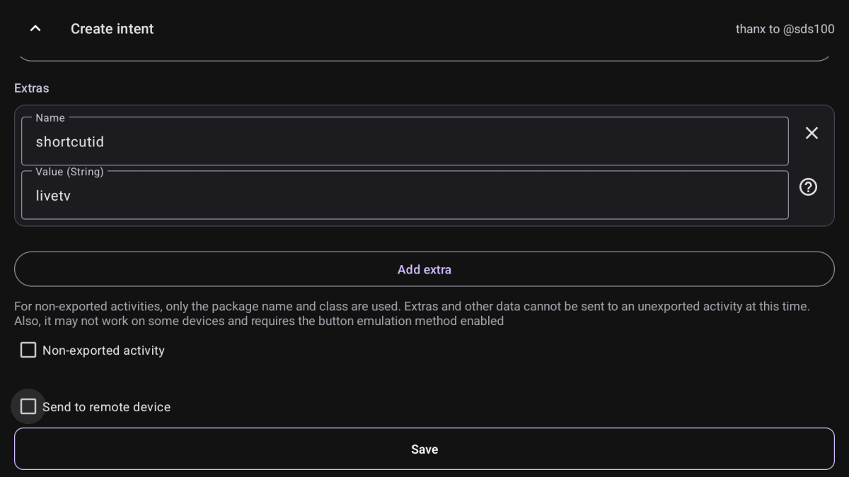

Capt.Insano 3 Posted November 1, 2025 Posted November 1, 2025 (edited) On 01/06/2025 at 21:08, Luke said: If you set the intent to ACTION_APPSHORTCUT then pass an extra of shortcutid=livetv or shortcutid=guide, then I think that will work. I found this thread looking to achieve the same thing: Onn TV 4k Plus Latest Emby Android App (non Android-TV app) Looking to create a shortcut from my remote via TVQuickActions Pro to the Live TV section of Emby. @LukeFollowing your above message (or at least my interpretation of it!) , I created the following intent but it does nothing: Any advice on getting this working would be really appreciated. Thanks a million Edited November 1, 2025 by Capt.Insano formatting
