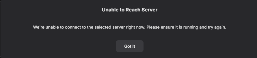

ppolymen 1 Posted May 17, 2025 Posted May 17, 2025 i use emby ubuntu and i trid to conect it in to my windows divice with https but it didnt conect nither in theater mode but in android and android tv divices but also in web emby it was conecting without any problem

ppolymen 1 Posted May 17, 2025 Author Posted May 17, 2025 it ses that it cant finde the server but it wont showw me the loading sercle like it is usualy duing wen it is conecting and imidiatly it ses that it can find it and i swud chec if the server is up
ppolymen 1 Posted May 18, 2025 Author Posted May 18, 2025 it is coming from open ssl but i have trid it in another emby server and it was working but wen i cange my tru nas server to a ubuntu server and put the ssl thear it wosent working in those to apps
Luke 43551 Posted May 19, 2025 Posted May 19, 2025 What is the exact message that you get? can you show a screenshot? Thanks.
Luke 43551 Posted May 19, 2025 Posted May 19, 2025 Are you sure you entered the correct address? where did you get it from?
ppolymen 1 Posted May 19, 2025 Author Posted May 19, 2025 yes i tryd the shame copy paste from the browser withou the port number in the shame url ofcurs but only in windows and thiater dosent worck also the thing tha i observd was that wen i put evrything corecly it wasent taking time to serch but wen i put them incorecly on perpus it was soing the shame mesage but it was taking time to sherch if the server is active
Luke 43551 Posted May 22, 2025 Posted May 22, 2025 Hi there, please attach the Emby server log from when the problem occurred: How to Report a Problem Thanks!
ppolymen 1 Posted May 22, 2025 Author Posted May 22, 2025 i discoverd somthing els i tride to put the emby server i another computer and stil had the shame problem in truenas and ubuntu
ppolymen 1 Posted May 25, 2025 Author Posted May 25, 2025 also i swa in the incoming pakegis that the app sents a request to the server and the server sents a pakege bak
Luke 43551 Posted May 25, 2025 Posted May 25, 2025 But it probably never reached Emby server. Do you use a reverse proxy?
Luke 43551 Posted May 25, 2025 Posted May 25, 2025 On 5/22/2025 at 1:09 AM, Luke said: Hi there, please attach the Emby server log from when the problem occurred: How to Report a Problem Thanks!
Solution ppolymen 1 Posted May 26, 2025 Author Solution Posted May 26, 2025 i found the solucion the problem was with the ssl it was shelf created by open ssl the windows ap requires a vilide ssl not self host but i dont se way the didnt alow shelf created ssls to be used by the windows and theater app 1
