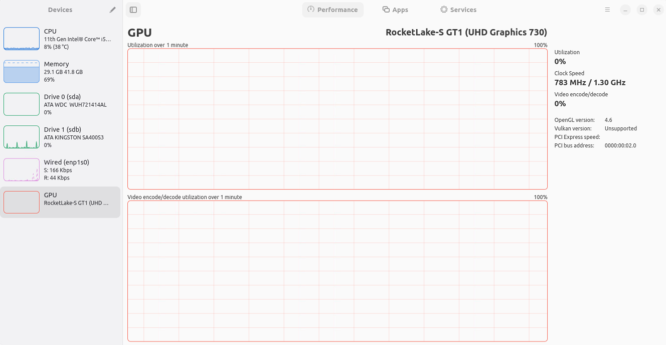

Flioner 0 Posted May 18, 2025 Author Posted May 18, 2025 I am running ubuntu 22.04.5 LTS with an HDMI dummy plug, using iGPU for video output, intel-opencl-icd is already the newest version (22.14.22890-1). I'll also attach a vainfo output. @Q-Droid $ lspci -nn | grep -i vga 00:02.0 VGA compatible controller [0300]: Intel Corporation RocketLake-S GT1 [UHD Graphics 730] [8086:4c8b] (rev 04) $ lsmod | grep -iE 'drm|video' video 77824 3 asus_wmi,xe,i915 $ dmesg | grep -iE 'drm|vga|display|video' dmesg: read kernel buffer failed: Operation not permitted (Once sudo, it outputs blank) $ ls -n /dev/dri total 0 drwxrwxrwx 2 0 0 80 may 17 16:15 by-path crwxrwxrwx+ 1 0 44 226, 0 may 17 16:15 card0 crwxrwxrwx+ 1 0 110 226, 128 may 17 16:15 renderD128 @LukeI'll run it directlly on the OS in a minute, and apologies for the late reply, I suspect it'll work but that is just speculation. Extra details, and thanks for the help. If I launch the docker-compose.yaml without "privileged" it says that /dev/dri doesnt exist, even though it does and has card0 and renderD128, specifically (Error response from daemon: error gathering device information while adding custom device "/dev/dri/": no such file or directory) Assinging devices: - /dev/dri or - /dev/dri/card0 - /dev/dri/renderD128 results in the same output of: not working while privileged, and Error esponse from daemon when not. Vainfo Output: vainfo libva info: VA-API version 1.14.0 libva info: Trying to open /usr/lib/x86_64-linux-gnu/dri/iHD_drv_video.so libva info: Found init function __vaDriverInit_1_14 libva info: va_openDriver() returns 0 vainfo: VA-API version: 1.14 (libva 2.12.0) vainfo: Driver version: Intel iHD driver for Intel(R) Gen Graphics - 22.3.1 () vainfo: Supported profile and entrypoints VAProfileNone : VAEntrypointVideoProc VAProfileNone : VAEntrypointStats VAProfileMPEG2Simple : VAEntrypointVLD VAProfileMPEG2Main : VAEntrypointVLD VAProfileH264Main : VAEntrypointVLD VAProfileH264Main : VAEntrypointEncSliceLP VAProfileH264High : VAEntrypointVLD VAProfileH264High : VAEntrypointEncSliceLP VAProfileJPEGBaseline : VAEntrypointVLD VAProfileJPEGBaseline : VAEntrypointEncPicture VAProfileH264ConstrainedBaseline: VAEntrypointVLD VAProfileH264ConstrainedBaseline: VAEntrypointEncSliceLP VAProfileHEVCMain : VAEntrypointVLD VAProfileHEVCMain : VAEntrypointEncSliceLP VAProfileHEVCMain10 : VAEntrypointVLD VAProfileHEVCMain10 : VAEntrypointEncSliceLP VAProfileVP9Profile0 : VAEntrypointVLD VAProfileVP9Profile1 : VAEntrypointVLD VAProfileVP9Profile2 : VAEntrypointVLD VAProfileVP9Profile3 : VAEntrypointVLD VAProfileHEVCMain12 : VAEntrypointVLD VAProfileHEVCMain422_10 : VAEntrypointVLD VAProfileHEVCMain422_12 : VAEntrypointVLD VAProfileHEVCMain444 : VAEntrypointVLD VAProfileHEVCMain444 : VAEntrypointEncSliceLP VAProfileHEVCMain444_10 : VAEntrypointVLD VAProfileHEVCMain444_10 : VAEntrypointEncSliceLP VAProfileHEVCMain444_12 : VAEntrypointVLD VAProfileHEVCSccMain : VAEntrypointVLD VAProfileHEVCSccMain : VAEntrypointEncSliceLP VAProfileHEVCSccMain10 : VAEntrypointVLD VAProfileHEVCSccMain10 : VAEntrypointEncSliceLP VAProfileHEVCSccMain444 : VAEntrypointVLD VAProfileHEVCSccMain444 : VAEntrypointEncSliceLP VAProfileAV1Profile0 : VAEntrypointVLD VAProfileHEVCSccMain444_10 : VAEntrypointVLD VAProfileHEVCSccMain444_10 : VAEntrypointEncSliceLP
Flioner 0 Posted May 18, 2025 Author Posted May 18, 2025 @Lukeapologies for the double tag, I've run it bare metal, and it works quite just fine: However I, for best practices, and a possible future migration to TRUENAS SCALE, would very strongly prefer to run the image in docker. I'm migrating from plex, and everything has been better so far, I really want to be able to just run emby from now on.
