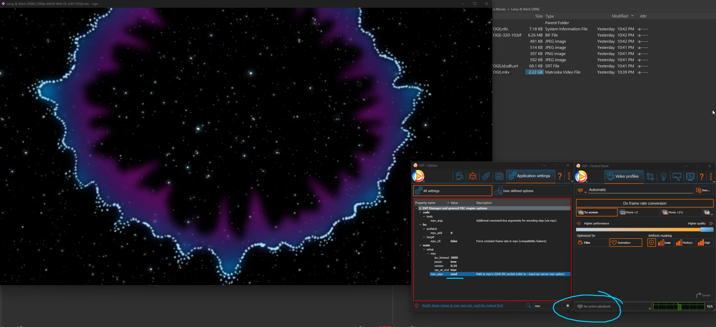

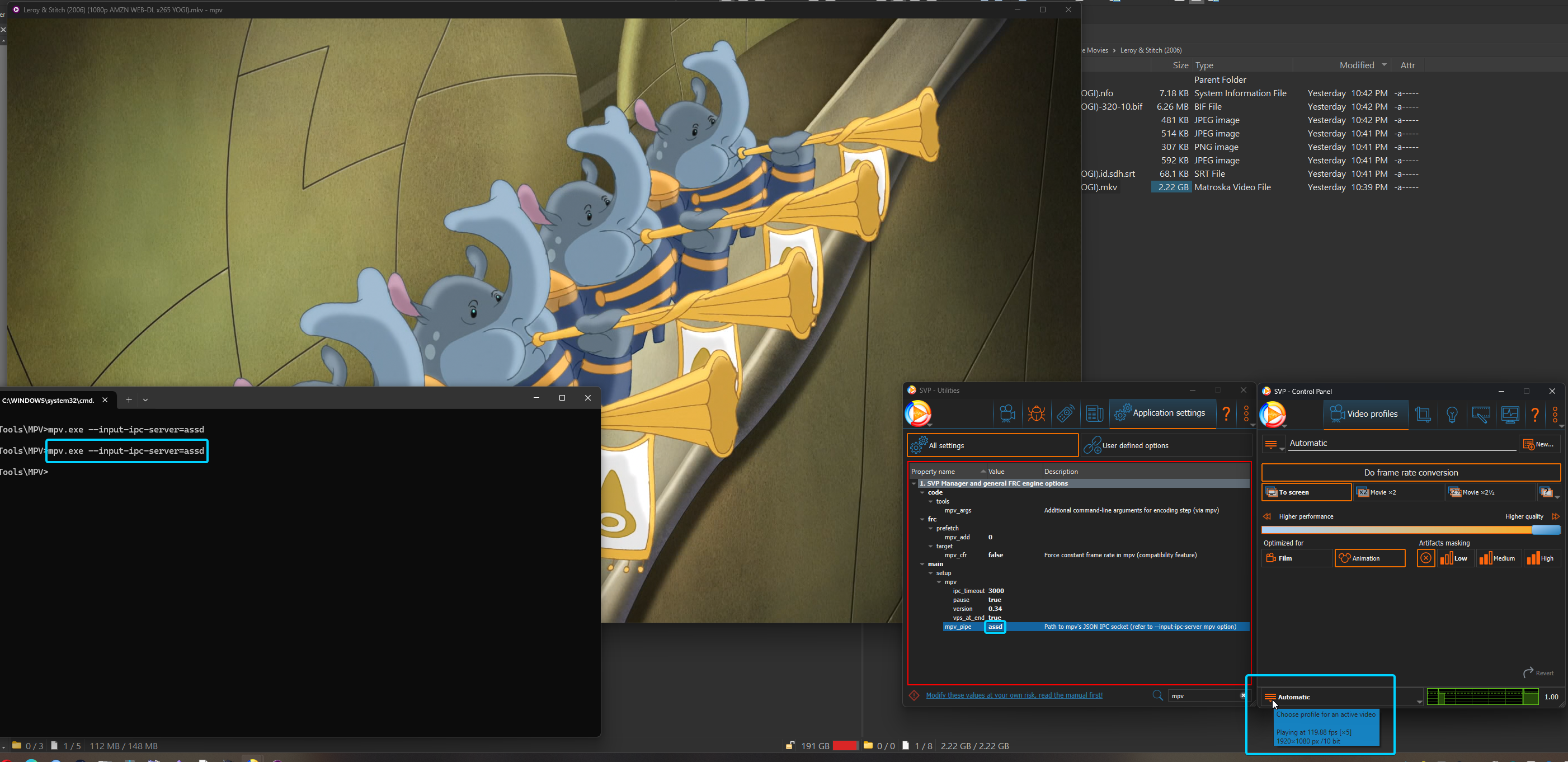

Riezel 34 Posted May 31, 2025 Author Posted May 31, 2025 (edited) 42 minutes ago, Luke said: Hi, what params would you need to be able to do this without a custom mpv build? well for starter, as simple command like this --input-ipc-server=xxx this is normal version without param (svp didnt detect it) and this is the mpv run with proper param matching the config in svp so i can match the ipc server (in this case assd) and svp detect it and convert it into 120fps mode on side note, in older version of emby-theater windows (non store) you can just add emby-pipe in svp config to natively detect emby player within emby-theater Edited May 31, 2025 by Riezel
