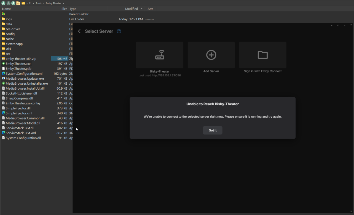

Riezel 37 Posted May 16, 2025 Posted May 16, 2025 as titles says, my emby theater recently can't connect to the server (192.168.1.3) some info : server is Debian storage is mounted via nfs what i already tried, use the docker version use the native version reinstall server OS (ubuntu and debian) upgrading debian 12 to trixie disable nginx / reverse proxy, in case it's conflict open firewall using emby app from ms. store (working fine without issue, but i need to use custom mpv.dll to inject SVP (SmoothVideoProject), so i can watch my content in high frame rates, smooth) into the emby hence i use the emby-theater) using web app (working fine without issue, no SVP as well) using ios and android app (working fine as well) using emby theater but updated the electron manually to latest version (working and connected somehow after doing fresh install to local ip (probably by network discovery?), but i can't play anything, seems infinite loop loading) using emby theater after managed to connect via local ip (from previous attempt using newer electron, but revert back the electron again after success connecting, aka bait session) (working, i can play (didn't test long enough), but every i finished play the content, i got error msg, also lot of section in manage / dashboard server is not showing up, like activity, or else) i dont think it's server issues, but more to electron issues currently i can still play the content + svp with current emby theater (after successfully bait session with latest electron) and using emby from ms.store but no svp support hope someone manage to reproduce this issue, and traced them to fix it, since for me using svp for watching anime is kinda mandatory also bonus, the last windows update was this : (before it broke everything, in case the problem was this one, i've been debugging it since yesterday, including reinstall restore etc) references : https://www.svp-team.comĀ for SVP theater-63882999869.txt theater-63882999334.txt 1

Riezel 37 Posted May 17, 2025 Author Posted May 17, 2025 (edited) 38 minutes ago, Luke said: Apologies for the disruption. Please try restarting the app and let me know if this resolves your issue. Thanks. i'll try again in 30m ~ 1h, since just now trying to connect to local ip still same result (this including same error msg after playback, with separate client that i already made connection via session bait earlier, the SS i attached is another standalone for debugging purpose) Edit : 2nd attempt unfortunately still fail (same result), after 30 minutes from 1st attempt @Luke Edited May 17, 2025 by Riezel 2nd attempt, still fail
