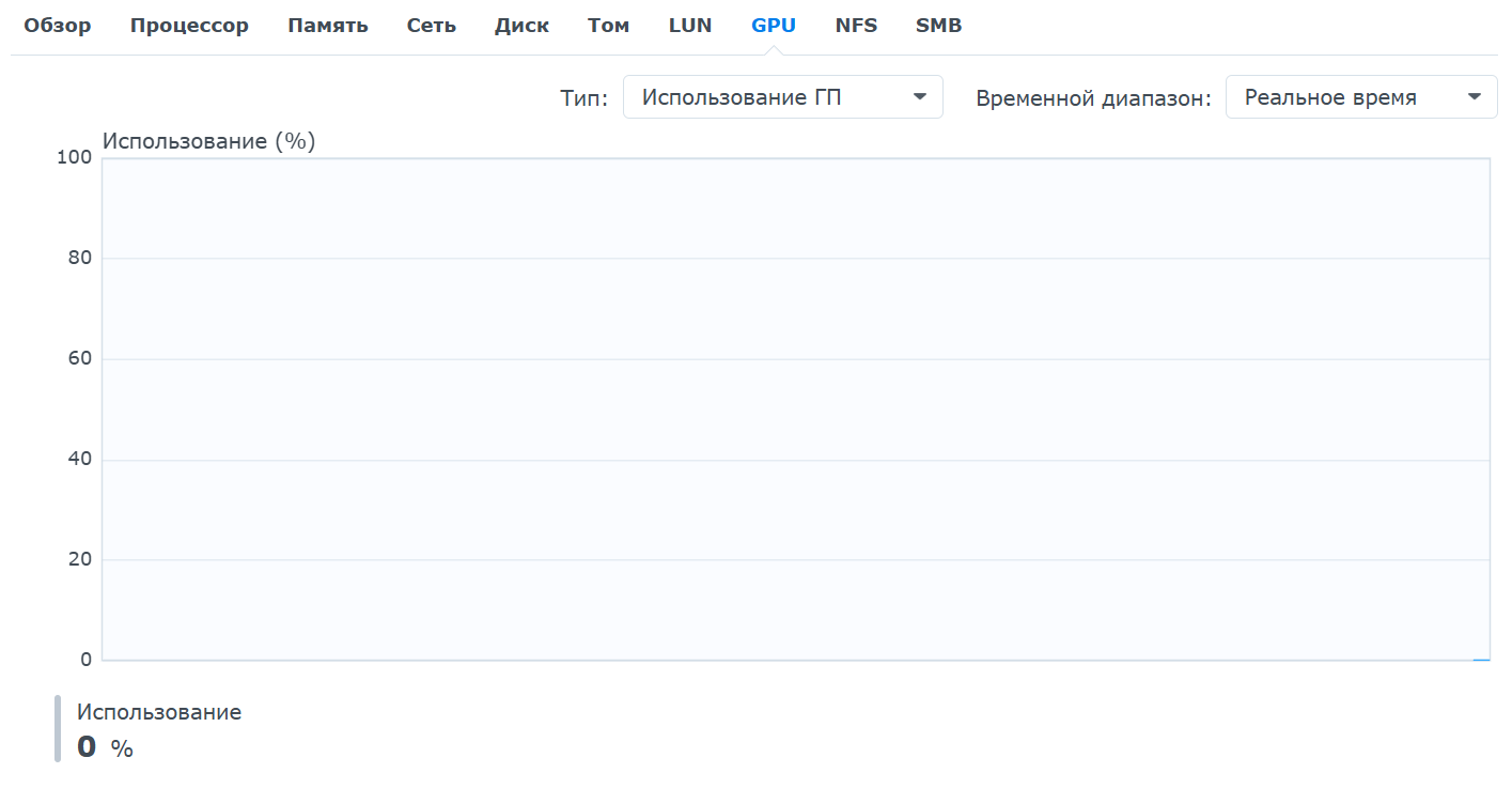

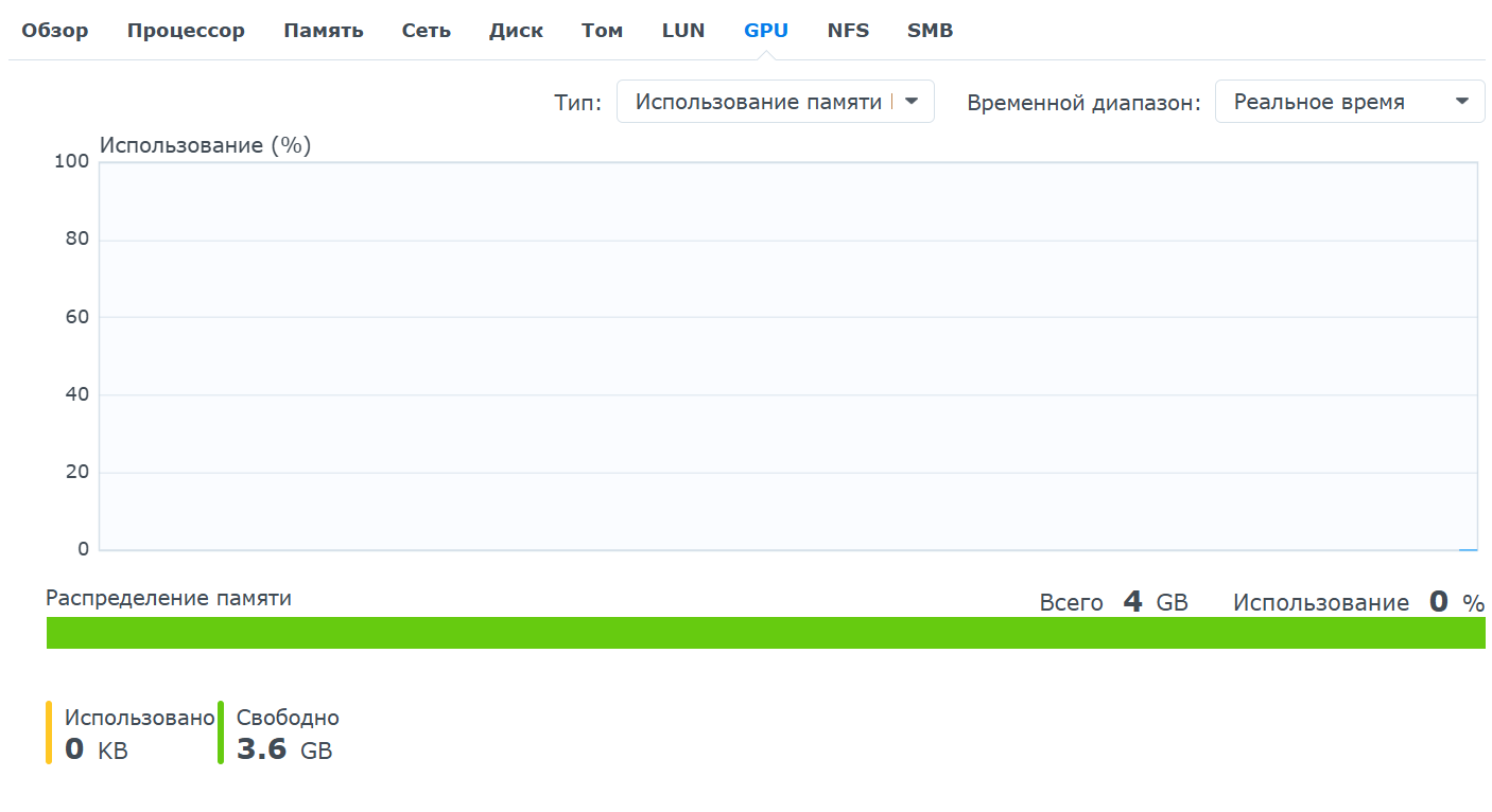

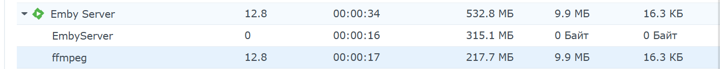

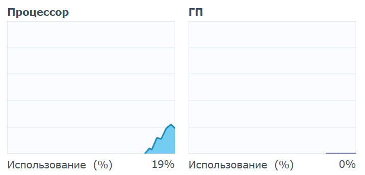

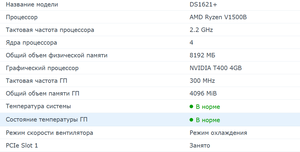

AIoTMYNAS 1 Posted May 16, 2025 Posted May 16, 2025 Hi, I want to clarify the issue with video preview thumbnail extraction using NVIDIA T400 installed on Synology DS1621+, for some reason this task is performed only by the built-in Rysen processor without using a video accelerator, although, for example, video transcoding successfully uses an external video adapter. hardware_detection-63882984561.txt embyserver.txt
GrimReaper 4895 Posted May 16, 2025 Posted May 16, 2025 Thumbnail extraction is not HW accelerated process in any system, it's CPU-only task. Basically, it all comes down to this:
AIoTMYNAS 1 Posted May 16, 2025 Author Posted May 16, 2025 7 hours ago, GrimReaper said: Thumbnail extraction is not HW accelerated process in any system, it's CPU-only task. Basically, it all comes down to this: Thank you. And if there is a "scan media library", the video card cannot be used either?
GrimReaper 4895 Posted May 16, 2025 Posted May 16, 2025 35 minutes ago, AIoTMYNAS said: And if there is a "scan media library", the video card cannot be used either? There is nothing in the "Scan media library" task that would require GPU usage - however, depending on your library settings, it might trigger other scheduled tasks (video preview thumbnails extraction, intro detection...) which are all CPU-only tasks. 1
