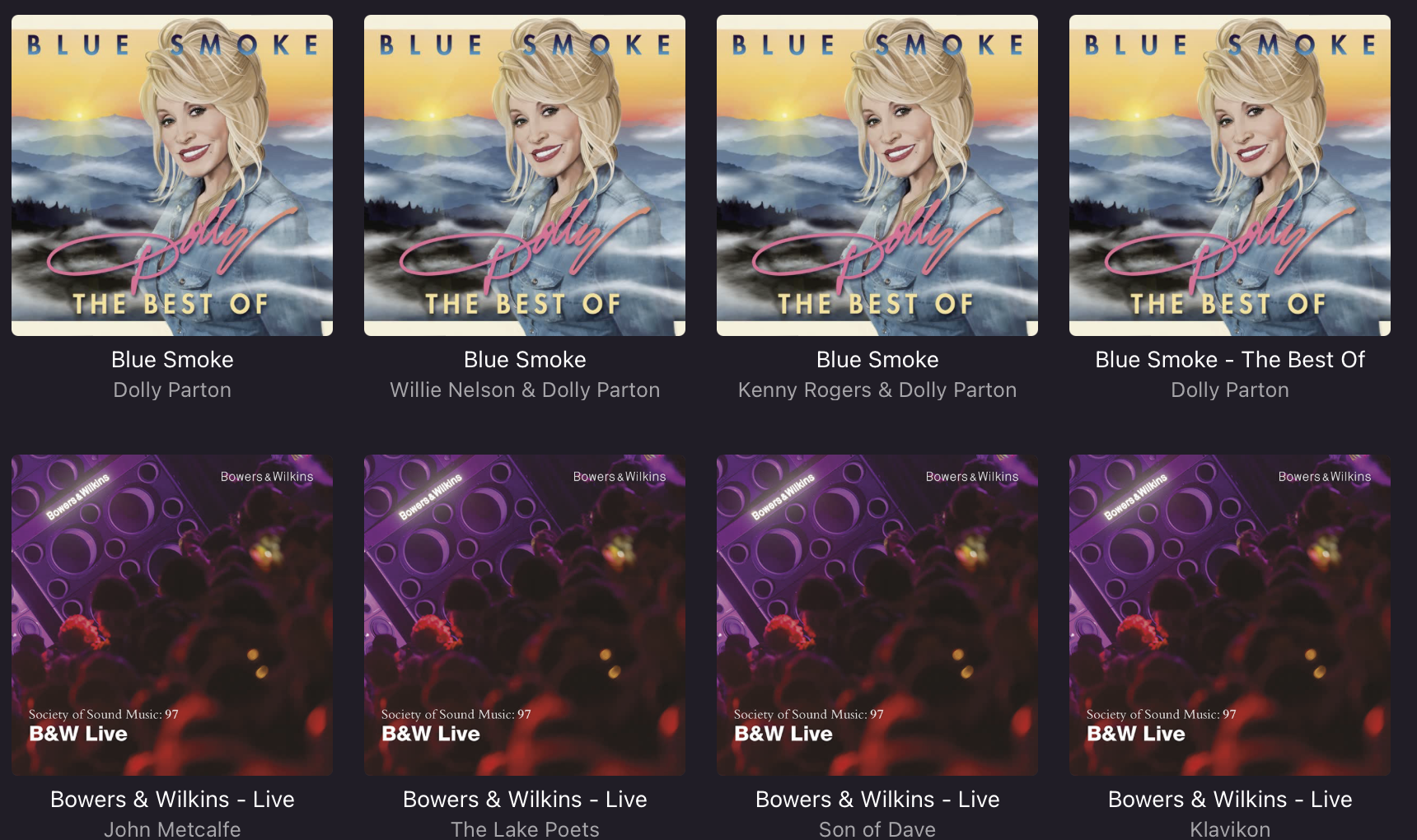

Julian’s Music Server 0 Posted May 15, 2025 Posted May 15, 2025 Hello, just setting up Emby on my Synology NAS, thought I would try it away from the Synology stock media server. However, I notice several albums are duplicated by track. ie same album with 7 tracks has 7 listings one for each track. It didn't do this on the stock media server so wondered if I've done something here & is there a way I can sort them back correctly?.
Luke 42239 Posted May 15, 2025 Posted May 15, 2025 Hi, most likely your tracks have different albumartist values: Music Naming If you can correct this, then that should resolve this.

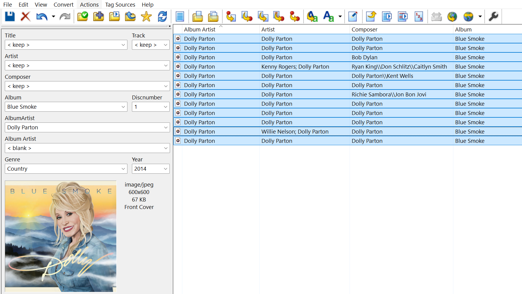

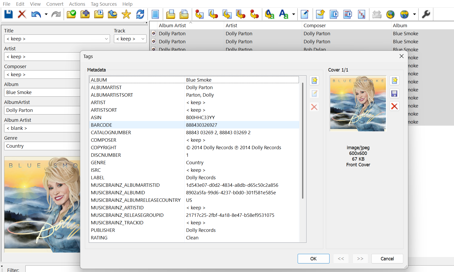

user24 349 Posted June 1, 2025 Posted June 1, 2025 With the Dolly Parton Album example, I'd guess that your Album Artist field is blank and also that you have two different Album titles ("Blue Smoke" and "Blue Smoke - The Best Of"). Changing Album Artist to "Dolly Parton" and Album to "Blue Smoke" for all Songs should result in one Album. This can likely easily be fixed with any music tagging software, but I would recommend Mp3tag. Here is how to do it: Load in the Album (Change Directory - green tick folder icon) and Select All the files (blue sheet icon) of the Album. You can then simply manually update the info in the LHS Tag Panel for all songs at once. It's also possible to use Tag Sources to import the data from MusicBrainz if you want to. Note; When you start with Mp3tag the LHS Tag Panel and RHS columns will be the default view, which is a bit different from my customized view shown above - but it will still work the same. Save the required changes in Mp3tag and then Scan the parent folder in Emby to import the changes into Emby. If you are still having Album Artist issues, then View>Extended Tags in Mp3tag to see all tags and check for other possible issues (sometimes there might be both "Album Artist" and "AlbumArtist" tags that are different from each other). Then, just follow the same method for the B&W Live Album... Hopefully that's enough info to get you started? It might seem a bit complicated if you're not familiar with Mp3tag, but it's very easy once you get the hang of it. Let us know how you get on. Cheers! 1
