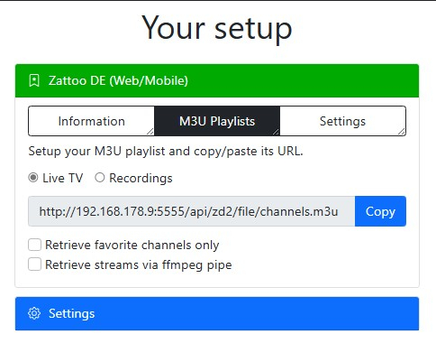

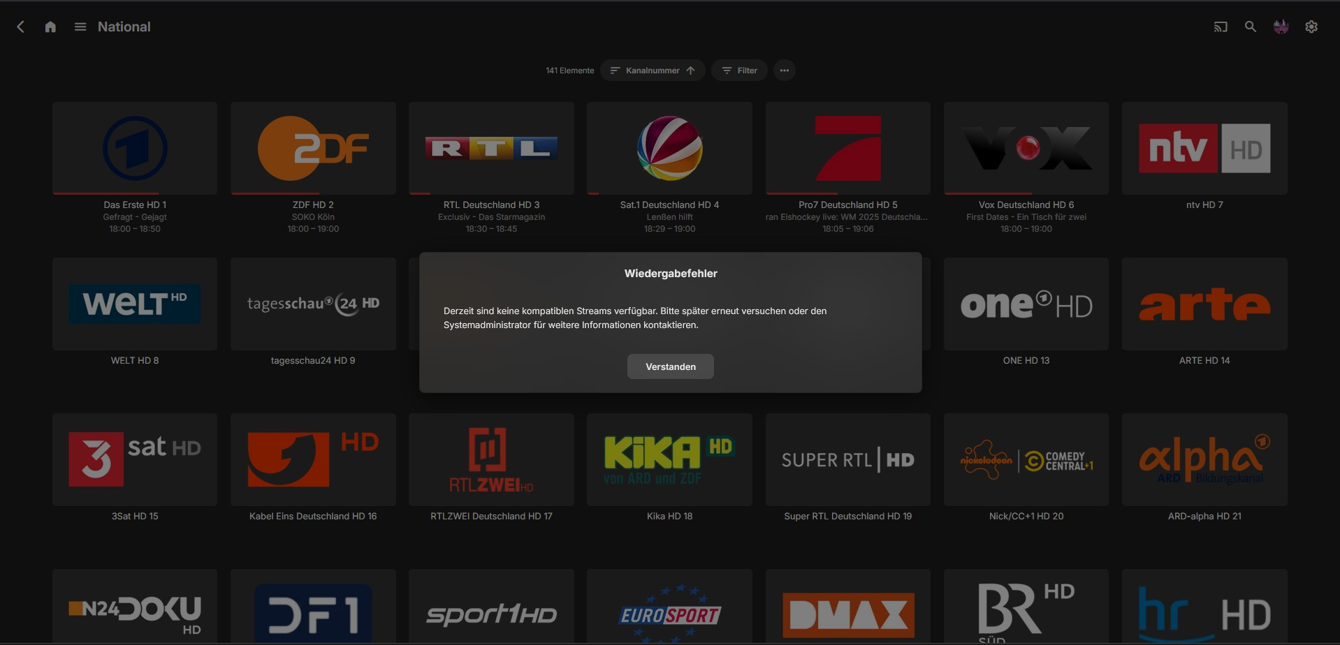

tomadick 8 Posted May 13, 2025 Posted May 13, 2025 Hi everyone, I'm having an issue and would appreciate your help: I'm running the latest Emby Server on my Synology DS1522+. I've also installed the Telerising API and successfully linked it to my Zattoo account. So far, everything works fine in these cases: I can watch Live TV directly through the Telerising API web interface in a browser. I can also load the generated M3U playlist in VLC, and all streams play perfectly. The problem: When I import the M3U playlist into Emby, I get an error when trying to access the channels. So Live TV via the Telerising API is not working properly inside Emby. Attached: Screenshot of the error message Current server.log file from Emby Does anyone have an idea what might be causing this? Any help would be greatly appreciated! Thanks in advance! embyserver.7z
Luke 42239 Posted May 13, 2025 Posted May 13, 2025 2 hours ago, tomadick said: Hi everyone, I'm having an issue and would appreciate your help: I'm running the latest Emby Server on my Synology DS1522+. I've also installed the Telerising API and successfully linked it to my Zattoo account. So far, everything works fine in these cases: I can watch Live TV directly through the Telerising API web interface in a browser. I can also load the generated M3U playlist in VLC, and all streams play perfectly. The problem: When I import the M3U playlist into Emby, I get an error when trying to access the channels. So Live TV via the Telerising API is not working properly inside Emby. Attached: Screenshot of the error message Current server.log file from Emby Does anyone have an idea what might be causing this? Any help would be greatly appreciated! Thanks in advance! embyserver.7z 19.51 kB · 0 downloads Hi, where is the live tv coming from? It looks like it just stopped sending data.
tomadick 8 Posted May 14, 2025 Author Posted May 14, 2025 It'xomming from Zattoo and works fine on VLC via the same m3u or via the integrated Webplayer on the Telerisimg API Server which is installed on the same NAS via Docker.

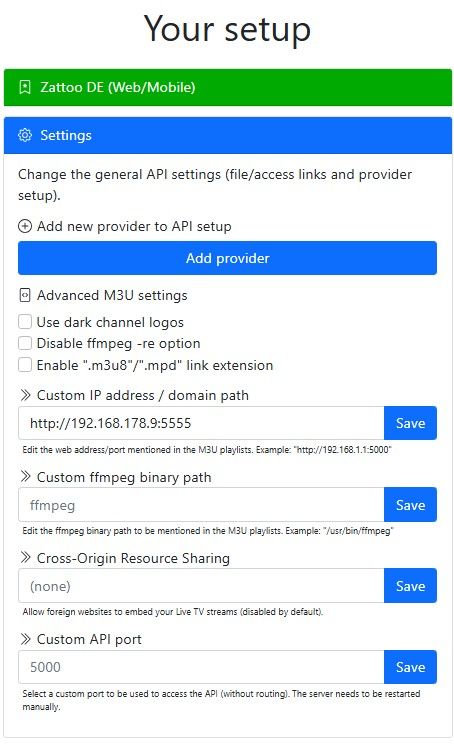

pünktchen 1410 Posted May 14, 2025 Posted May 14, 2025 Did you set the m3u extension option in Telerising?
tomadick 8 Posted May 14, 2025 Author Posted May 14, 2025 As I use the same link for VLC and it works perfectly I would say yes. I also checked the m3u in notepad, I also looks good.
pünktchen 1410 Posted May 14, 2025 Posted May 14, 2025 1 hour ago, tomadick said: As I use the same link for VLC and it works perfectly I would say yes. I also checked the m3u in notepad, I also looks good. VLC doesn't need that option, so please double check your settings and/or attach your m3u here.
tomadick 8 Posted May 14, 2025 Author Posted May 14, 2025 Hola, there is no oprion, to enable the m3u option. Bit I see to configuire it, so i guess it's might be enabled. channels.m3u
