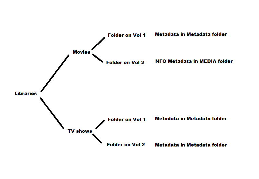

ArdiSpleen 0 Posted May 13, 2025 Author Posted May 13, 2025 Ok I just checked, I have 2 Folders in the same library, and one saves the metadata in the media folders while the other saves it in the metadata folder (they are on seperate volumes). This just made me even more confused. Is there a way to transfer all of the metadata in the metadata folder into the media folders ?
GrimReaper 4926 Posted May 13, 2025 Posted May 13, 2025 3 minutes ago, ArdiSpleen said: Ok I just checked, I have 2 Folders in the same library, and one saves the metadata in the media folders while the other saves it in the metadata folder (they are on seperate volumes). Not knowing specifics of your particular setup - do you have write permissions for second volume? 4 minutes ago, ArdiSpleen said: Is there a way to transfer all of the metadata in the metadata folder into the media folders ? There is not; NFOs are either written/saved next to media or not written at all, everything is contained in db only. 2
Happy2Play 9814 Posted May 13, 2025 Posted May 13, 2025 (edited) Pretty sure you can enable nfo writing on library and do refresh search for missing to have them written with media. Otherwise it is database only and lost when media is moved. Edited May 13, 2025 by Happy2Play
ArdiSpleen 0 Posted May 13, 2025 Author Posted May 13, 2025 20 minutes ago, GrimReaper said: Not knowing specifics of your particular setup - do you have write permissions for second volume? There is not; NFOs are either written/saved next to media or not written at all, everything is contained in db only. I have writing permission for both of them. Volume 1 is also where Emby is located, and the metadata is stored in the metadata folder. Volume 2 is a separate one, where metadata is stored in media folders. If it's enabled in the library settings, wouldn't both folders use the same metadata paths? 10 minutes ago, Happy2Play said: Pretty sure you can enable nfo writing on library and do refresh search for missing to have them written with media. Otherwise it is database only and lost when media is moved. I can't seem to find the option to do that. The only one I see is "save artwork into media folder" which is enabled but still doesn't happen.

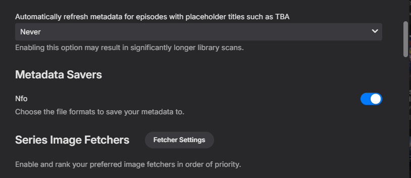

GrimReaper 4926 Posted May 13, 2025 Posted May 13, 2025 1 minute ago, ArdiSpleen said: I can't seem to find the option to do that. The only one I see is "save artwork into media folder" which is enabled but still doesn't happen. I have a feeling you're mixing metadata and artwork. Metadata Savers>NFO option enabled will save a file containing textual metadata next to your media (otherwise it's contained in database only). Save artwork into media folders will save images/graphics next to your media, otherwise it'd be saved in server metadata folder. Are you concerned about metadata or artwork preservation?
Happy2Play 9814 Posted May 13, 2025 Posted May 13, 2025 You don't see this in your library settings? If not would suggest you don't have the NfoMetadata plugin. But I believe each volume on the Synology has their own permissions. 1
ArdiSpleen 0 Posted May 13, 2025 Author Posted May 13, 2025 i am looking for textual metadata preservation. I was just referencing the "artwork into media folder" option, because it was the only option I saw that said something about saving into the media folder. I have the nfo metadata saver enabled, but it doesn't save any media in my main volume into the media folders unfortunately.

ArdiSpleen 0 Posted May 13, 2025 Author Posted May 13, 2025 (edited) also another thing that's weird: I have 2 main libraries. One for Movies one for TV Shows. Both have two folders each, one on Vol 1 and one on Vol 2. However, the only folder that saves nfo into the media folder is the movie folder on volume 2. the other three are using the metadata folder. This includes the TV shows folder that is also located on volume 2. Their settings are identical. Nfo saver is also enabled for both libraries. So if it was a permission problem, wouldn't the whole volume be affected by it? Edited May 13, 2025 by ArdiSpleen
