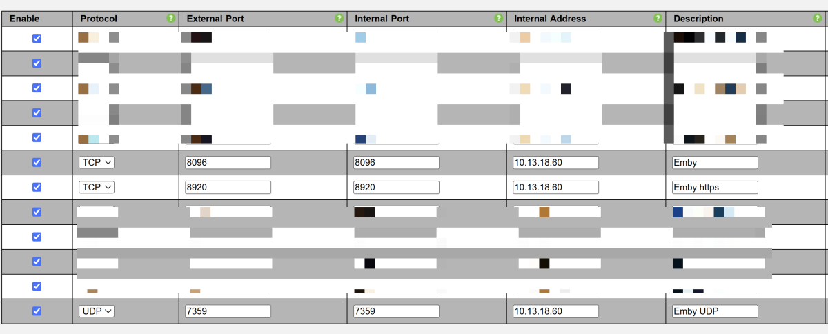

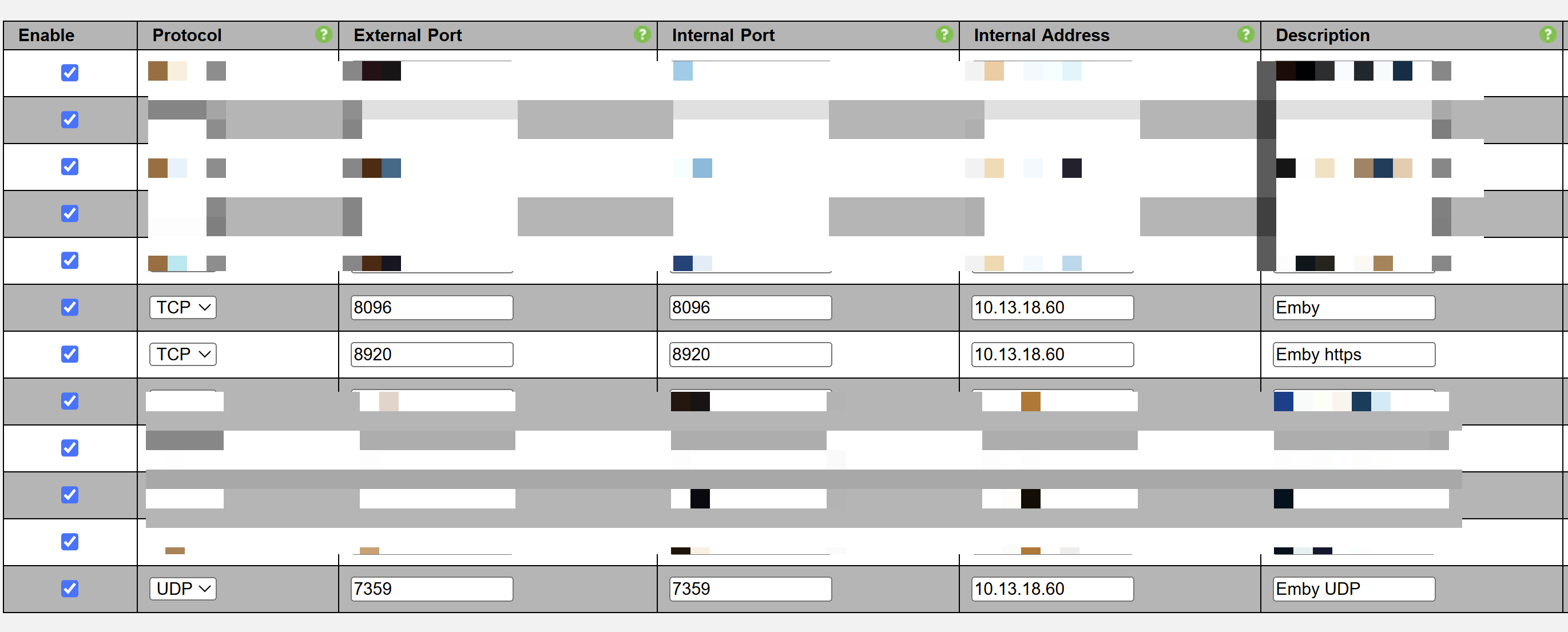

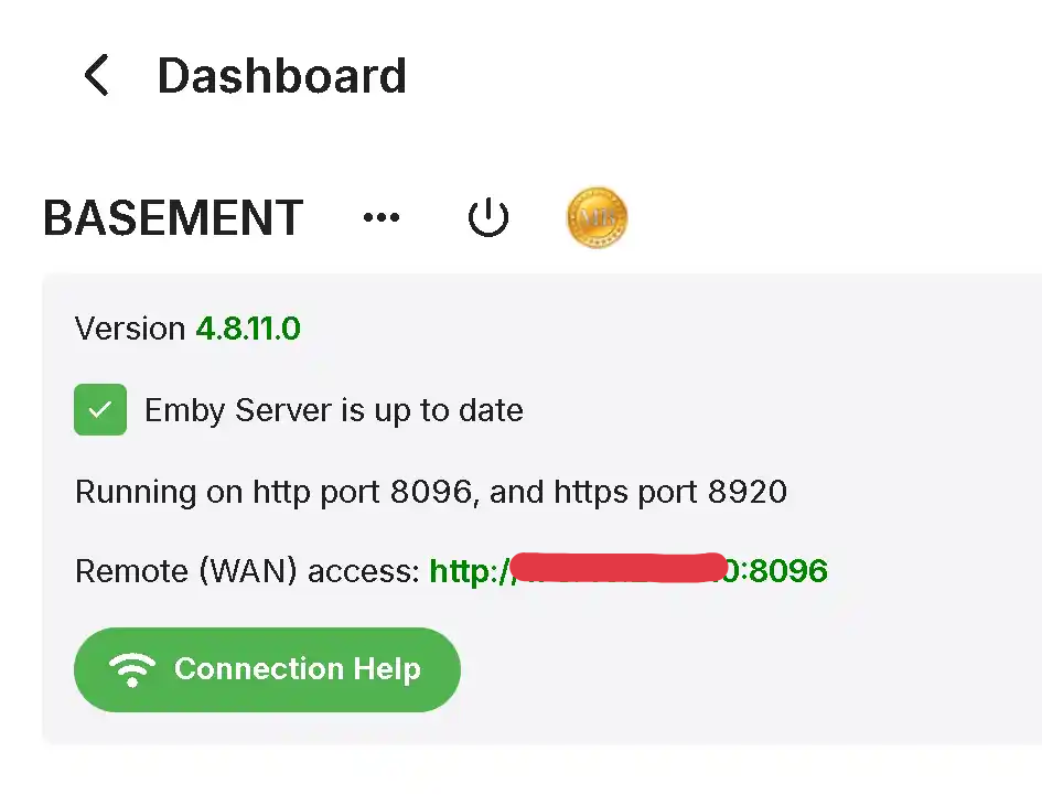

tp546 41 Posted May 13, 2025 Posted May 13, 2025 (edited) Hi all, My server is up and running and works fine inside my network when accessing via the Android app on many devices but I am having trouble connecting outside my network. Here is the port forwarding page from my router and my Emby Dashboard: What am I missing here? Thanks! Edited May 13, 2025 by GrimReaper WAN IP masked
GrimReaper 4927 Posted May 13, 2025 Posted May 13, 2025 Your Dashboard doesn't list your In-Home (LAN) address - do you have multiple NICs in your server machine? Do you have any virtual adapters? Are you using VPN? What does typing ipconfig in cmd tell you? Can you post server log? You can also bind server to a particular local IP in Settings>Network (as per your port forwarding rules, it should be 10.13.18.60). As a sidenote, you don't need to forward UDP 7359 port as that it used only for local server discovery. 2

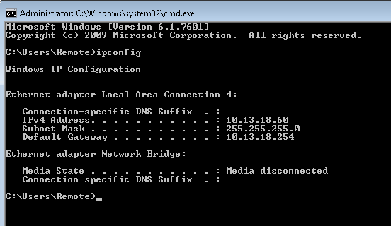

tp546 41 Posted May 14, 2025 Author Posted May 14, 2025 19 hours ago, GrimReaper said: Your Dashboard doesn't list your In-Home (LAN) address - do you have multiple NICs in your server machine? Do you have any virtual adapters? Are you using VPN? What does typing ipconfig in cmd tell you? Can you post server log? no, none of those things. Here is what ipconfig says: Can you remind me where the logs are? I thought they were in the folder below but nothing there has been modified since 2023: C:\ProgramData\MediaBrowser-Server\logs 19 hours ago, GrimReaper said: You can also bind server to a particular local IP in Settings>Network (as per your port forwarding rules, it should be 10.13.18.60). - thanks, I did that and now it shows on the dashboard As a sidenote, you don't need to forward UDP 7359 port as that it used only for local server discovery. Thanks, i will remove it.

Luke 42289 Posted May 19, 2025 Posted May 19, 2025 That’s odd that in your screenshot a LAN address isn’t detected. Is that normal for you?
tp546 41 Posted May 19, 2025 Author Posted May 19, 2025 47 minutes ago, Luke said: That’s odd that in your screenshot a LAN address isn’t detected. Is that normal for you? No that was the first time I've noticed it like that. It's fixed now thanks to the suggestion above. 1
