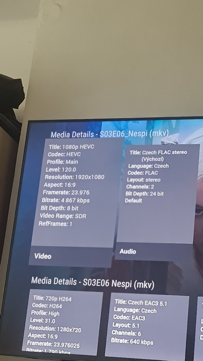

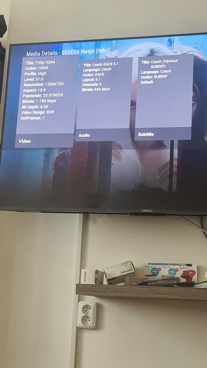

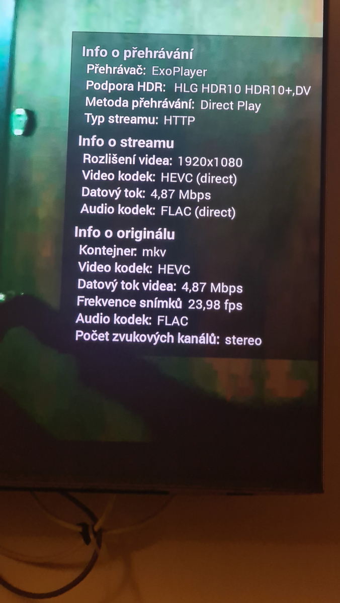

Filio 0 Posted May 12, 2025 Author Posted May 12, 2025 (edited) In zip file is server protocol, first issue I resolve Now have 2 issje 1. On ds918 synology hlavě hybernation 30 minutes not run client emby but never go sleep if stop server go to hibernate after 30 minutes 2. Some vide is not Dolby vision or hdr are many sce es degrade quality and green color a lot of I add now server txt when play, play start around 21:56, if run video without emby quality is perfect. Synology ram have 16gb and processor and ramis free 90% on server. Green or if is dark scene video have many cubes and from HD is maybe 480p quality. If download same video on mobile and run without emby all is perfect I have premium embyserver.txt Edited May 12, 2025 by Filio

Filio 0 Posted May 12, 2025 Author Posted May 12, 2025 (edited) Also when use smb is quality poor and many green in video.. Is no dv is no hdr.. Type stream with smb is http and flax show stereo but is 5.1... On mobile in browser emby is all OK but is converted Edited May 12, 2025 by Filio

Filio 0 Posted May 13, 2025 Author Posted May 13, 2025 9 hours ago, Luke said: Mezi klientem a serverem se http používá vždy bez ohledu na to, jak nastavíte knihovnu I attached log server when play and video have many time a lot of green and make cube.... If try without emby all OK... Have some tips?
Filio 0 Posted May 13, 2025 Author Posted May 13, 2025 (edited) 9 hours ago, Luke said: Přiložte prosím log serveru emby z doby, kdy jsem měl usnout. Sleduji protokol Synology a naplánovanou úlohu na Emby, zastavím hibernaci a spusťím NAS. Změním čas plánování a práci... Ale pokud přidám nový soubor, musím spustit ručně přidání nového souboru do knihovny Emby, protože RTM nefunguje. First video on image have many green I have more video with this issue.. Second image is video better Edited May 13, 2025 by Filio
