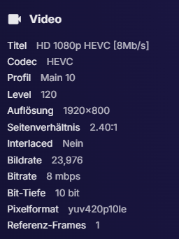

One thing I noticed though, I got a hand full of false positives with 1080p HEVC content. Just HEVC Main10 Profile seems to be enough for a plugin cover to be flagged as HDR, even the content is not HDR. Shouldn't the plugin just look for the Video Range (DolbyVision or HDR 10)? Movies with just Profile level Main are not affected.
image.png.e56744f00b70858f15c91931ccd072da.png image.png.d8665acf8ae242758de050c4fc50b634.png image.png.951da1342521365852f5c9f447155e80.png

One thing though, I got a hand full of false positives with 1080p HEVC content. Just HEVC Main10 Profile seems to be enough for a plugin cover to be flagged as HDR, even the content is not HDR. Shouldn't the plugin just look for the Video Range (DolbyVision or HDR 10)?
I must admit i always thought main 10 is HDR, i just googled it and can see i was totally wrong about that.
I will look into changing it, give me a couple a days.
Thanks for reporting it! :)
  • Thanks 1

I added few more examples. Thanks for the quick reply! I guess going for Video Range field would be your best bet.
Does your plugin by any chance read out the track name? Just recognized when a UHD DV8 HDR10 file had HDR insted of DV in the cover, when I checked the track name (I use the MediaInfo Plugin), I saw that the MediaInfo plugin could not write the track name for some reason (it was just "UHD [27,1Mb/s]"). When I modified the track name manually to "UHD DV8 HDR10 [27,1Mb/s]", and rescanned library, the cover changed to the DV logo. If so, it would also be possible to use a HDR10+ logo since the MediaInfo Plugin also writes into video track name if a file is HDR10+? So scraping track name as primary method, and Video Range as fallback for example.
Edited by sh0rty
yocker
Does your plugin by any chance read out the track name? Just recognized when a UHD DV8 HDR10 file had HDR insted of DV in the cover, when I checked the track name (I use the MediaInfo Plugin), I saw that the plugin could not write the track name for some reason (it was just "UHD [27,1Mb/s]"). When I modified track name manually to "UHD DV8 HDR10 [27,1Mb/s]", and rescanned library, the cover changed to the DV logo.
Yes, the way i have my files is that i put their properties into the names, like for example "Batman - 7.1 TrueHD HDR, my server automatically renames files like that so thought it was one good way of doing it.
In hindsight maybe a bad idea to let it look at titles in case of false positives.
I will change it to look after color profiles only, should limit the false positives.

Try this one, should be no more false positives.
I will look into HDR 10+ later, though as always i won't promise anything! ;)
EmbyIcons.dll

Yes, works like a charm now. Only thing is now the Rating overlay is gone including the toogle in plugin settings.
yocker
Was only a test version, sorry I should have said that, will give you the right one a little later
