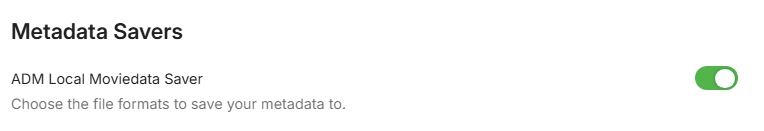

Its a bit of a hack, but I use IMetadata saver for anything like that,  basically an adaption of the nfo writer that's triggered when anything changes to the metadata, you can of course trigger it for other things instead.  I think there is probably something else that triggers, but don't know what so I use this, it gets triggered every time there's a library scan or an individual item scan or metadata refresh etc.  The only down side is that it appears in library options as a saver and has to be turned on.
Where it goes into a save just use that to trigger something else
public static string SaverName
    // here is the name that appears in the Emby Library
    get
        return "Local Moviedata Saver";
public bool IsEnabledFor(BaseItem item, ItemUpdateType updateType)
    // return true, it is enabled for BaseItem and is Movie
    if (item is Movie)
        return true;
    return false;
public Task Save(BaseItem item, LibraryOptions libraryOptions, CancellationToken cancellationToken)
I don't know if this info will help or fit your needs, but I mention it because its an alternative.

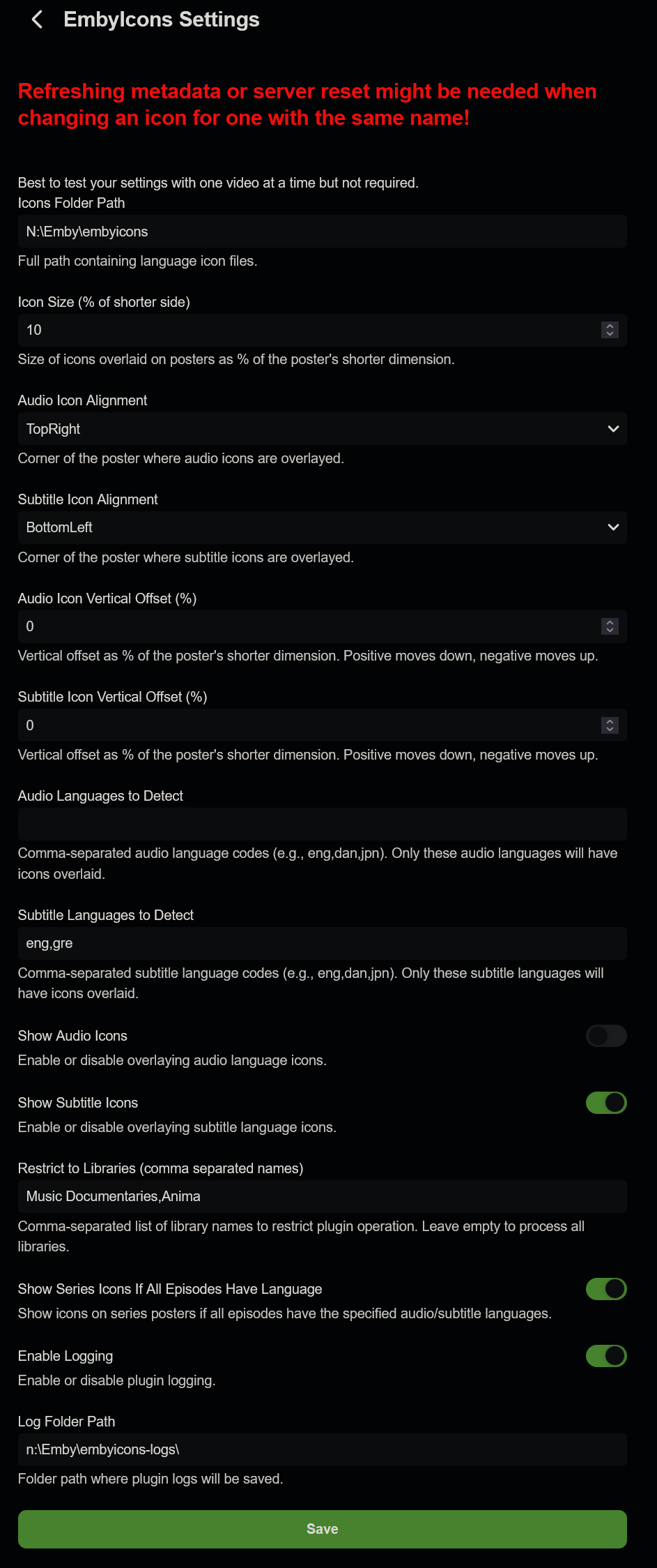

I feel kinda dumb as I can't get the flag icons to appear in my library (running EmbyIcons 1.19.0.0).
Settings are like this:
I've put the icons filename that I want (gre,eng) both in 2 letter and 3 letter filename format -just to be on the same side.
I run the task in scheduler, I waited, check the log and it's processing the subtitles and audio streams fine.
Tried to refresh the metadata on these libraries just to make sure....no subtitle flag icon overlay anywhere.
What am I missing here?
Edited by akacharos
  • Like 1

GrimReaper
You're using naming convention for audio languages while having audio icons disabled. If you want subtitle flags, you need to rename those files.
From Github link:
Quote
Important:
Icons must me named "eng.png" for audio tracks and "srt.eng.png" for subtitles, change eng with the language code you want like dan or jpn.
Edit: @yocker, maybe the above should be denoted in plugin settings?
Edited by GrimReaper
Append
  • Agree 1
akacharos
ooops, I missed that bit. thanks so much @GrimReaper, I was going crazy with this,
  • Like 1

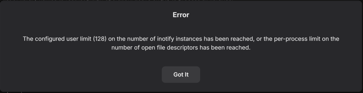

When I try to turn on the auto-refresh, I get this error:
  • Thanks 1
yocker
I thought something like this would happen for some.
Just disable it for now. Emby has it's own filewatcher, i just wanted to see if i could do a better job than it and make sure icons got drawn all the time
Thanks for testing!
