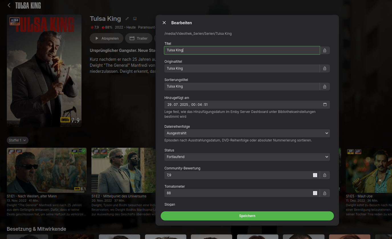

yocker 1423 Posted January 27 Author Posted January 27 20 minutes ago, Doppellhelix said: Hello, I display the IMDB and Rotten Tomatoes ratings on the covers. I just tried out a new plugin (Rating Sync) that updates existing ratings. Some movies or series, e.g., Tulsa King, only had an IMDB rating. Now the Rotten Tomatoes rating has been added. When I open Tulsa King, it is also displayed. However, only the IMDB rating is visible on the cover. Do I need to restart EmbyIcon for new or changed ratings to be displayed? Thanks for your help. I don't know how Ratings Sync work so it hard to say. Try and do a rescan of the libraries.
Doppellhelix 17 Posted January 28 Posted January 28 18 hours ago, yocker said: I don't know how Ratings Sync work so it hard to say. Try and do a rescan of the libraries. Hi, thanks for your reply. It looks like Ratings Sync simply updates the ratings and then enters them into the metadata. In the Scrrenshot, you can see that Rotten Tomatoes has a rating, but it is not displayed on the cover. I rescanned the Emby library and also updated the metadata for Tulsa King. That didn't help. It looks to me like EmbyIcons needs to scan the library again to recognize that a change has now taken place in the metadata. How can I get EmbyIcons to do that? Greets Helix
yocker 1423 Posted January 28 Author Posted January 28 4 minutes ago, Doppellhelix said: Hi, thanks for your reply. It looks like Ratings Sync simply updates the ratings and then enters them into the metadata. In the Scrrenshot, you can see that Rotten Tomatoes has a rating, but it is not displayed on the cover. I rescanned the Emby library and also updated the metadata for Tulsa King. That didn't help. It looks to me like EmbyIcons needs to scan the library again to recognize that a change has now taken place in the metadata. How can I get EmbyIcons to do that? Greets Helix For now it's impossible. EmbyIcons was never designed to have ratings update like that, sorry. I will see what i can do but can't promise anything as it would be a big change to make. 1
yocker 1423 Posted January 31 Author Posted January 31 On 1/27/2026 at 8:58 PM, Doppellhelix said: Hello, I display the IMDB and Rotten Tomatoes ratings on the covers. I just tried out a new plugin (Rating Sync) that updates existing ratings. Some movies or series, e.g., Tulsa King, only had an IMDB rating. Now the Rotten Tomatoes rating has been added. When I open Tulsa King, it is also displayed. However, only the IMDB rating is visible on the cover. Do I need to restart EmbyIcon for new or changed ratings to be displayed? Thanks for your help. I can't get ratings-sync to work right for me as the webpages won't send me an API key i can use for testing so it's hard for me to diagnose. I have changed the caching for the rotten tomatoes rating slightly so it should read it and change it if it has been updated. Can you please test if it worked? EmbyIcons.dll 1
